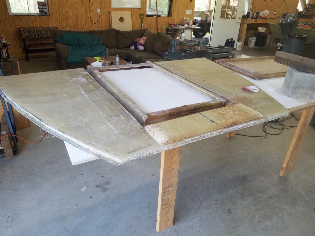

Here is a picture of what I am talking about. See the exposed comb. It is like that all the way around the outside edge. I figure as long as it is adequately supported from underneath with a rail or hard points and tabbed from the top, it should be fine.

U, not sure I answered your question before so I'm going to add some comments. Here is the whole front deck process.
Day1:
-Leveled two 4x8 pieces of memine on cement floor
-Taped 2x2 pieces of wood down for gutters
-glassed gutters down with lots of matte and a layer of 1708
-let it all dry
Day2
-layer of matte over the whole thing including previous days work (lighty sanded and acetone whole thing)
-layer 1708 up to gutter but not over it
-layer of matte
-core and weight on core
Day3
-thickened resin between edge of core and gutter
-matte over all that
-1708 over all that
-1708 over gutter up to core
April 07, 2025, 02:49:25 PM
Reply #632
405
Re: 1973 196 rebuild question
Reply #632 on:
April 07, 2025, 02:49:25 PM »
Thank you for the detailed explanation Duffy! How did you handle the scrim backing on the honeycomb panels? Did you "hot coat" them before you set them into the wet mat layer?

Yes, U. Gave the honeycomb a healthy coat before waiting them down.

Thanks for the information. Regarding finishing the edge of the honeycomb, are you able to add a 45 on the edge of the panel so the bulkhead can be joined together AND filled with thickened resin? Check out my 240 build post #21 where I did this to make a bulkhead and the fuel tank subfloor.

Hatch .... mat, 1708, strip 1708 down each side , mat, core battery
April 09, 2025, 05:39:44 PM
Reply #636
483
Reply #636 on:
April 09, 2025, 05:39:44 PM »
As U says, liberally hot coated core before laying down wet on wet. Added various pieces in corners and other random spots. I had resin left over, things got glassed.

Looks like you have the hang of this. Maybe should have cut the edges of the core at a 45 all around before lamming it in, so you could finish lamming all together?

I thought about that but decided to use thickened resin instead. For whatever reason I seem to end up doing cored laminations in two stages. What you described would be better.

Duffy, thanks for sharing. Looks like the honeycomb panels work well for coring small part as well. Good to know! Something I have in mind for when I build my deck is to use quarter round glued into the ends and capped with glass. Unfortunately, I havent found a PVC quarter round in 1''.

Put a piece of honey comb to reinforce the front joint. Glassed over comb with 1708. Put a piece of plastic over that and weighted it down with a car battery and cinder block. First time to weight down over plastic. Came out wavy. It's solid but needs some grinding.

Forgot, put thickened resin and Matt down first in between two c9mb layers
