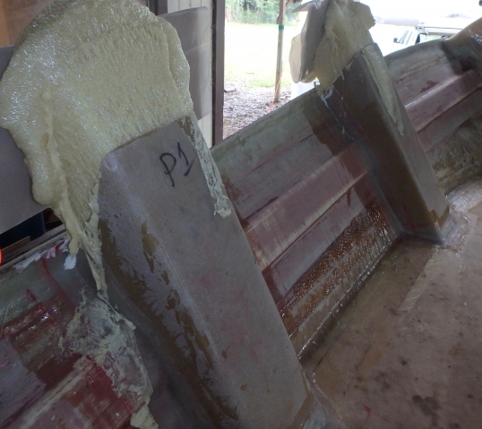

Still making progress.  I put a wipe of fairing mix on the longitudinal planks and did a preliminary sand.  The forward vertical stiffeners are tabbed in and filled with foam.  I'm looking forward to the end of structural work.  Then it will be a whole lotta sanding & fairing.

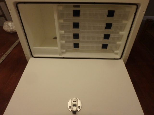

I got the aft stiffeners/rod holders tabbed in today, and laid out the aft bulkhead.  There will be a small tackle center flanked by access hatches.  The hatches will make it easy to access the seacock for the livewell drain & fuel/water separater as well as trim tab connections and other stuff.  The tackle center can be removed for rigging and access too. Coincidentally, the UPS driver arrived with the  tackle center and hatches as I typed this.
