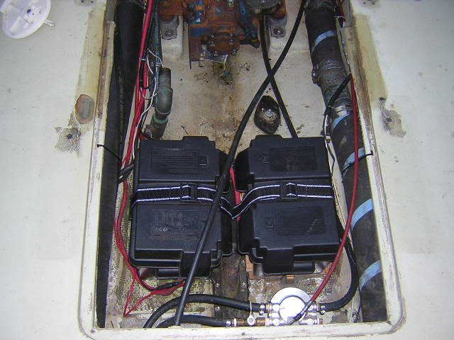

Pictures??? Well, here's a couple from this afternoon's progress.
Got the other battery box installed and re-routed some wiring to accommodate the new battery locations:
I lucked out with moving the batteries to the bilge... everything
just
fits. Location is good too because where they are now is low and symmetrical... also its the sweet spot for minimum motion.
Juice to the engine is routed through the "1,2, both" battery selector switch but for some reason the feed to the console breaker panel isn't. Will remedy that this weekend. The bilge pumps are wired directly to the batteries, which is correct.
NOTE: Some of the things I've done are going to get changed and/or prettied-up some when the restoration on her gets started after the 240 is finally out of the way. Those glassed patches on either side of the deck panel opening look horrible but they are there simply to stiffen up the receiving flange so the panel doesn't collapse into the bilge when you stand on it. As I mentioned early on, the deck is soft as a marshmallow... everywhere. The patches and reinforced areas are band-aids only. For the time being she will be safe and functional but no beauty queen.

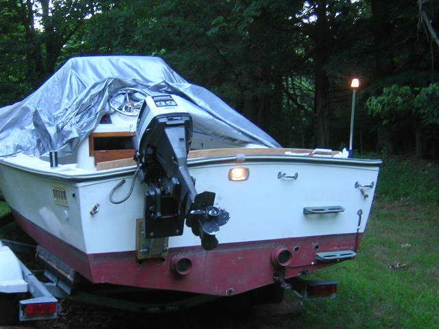

With the batteries behind me now I sorted out the nav. light wiring to the transom and got the new 360 deg. stern light mounted and lit:
The light set into the transom is non-reg. nowadays but because it was there... and I like it, I got it going anyway. If inspection doesn't like it, that's their problem.

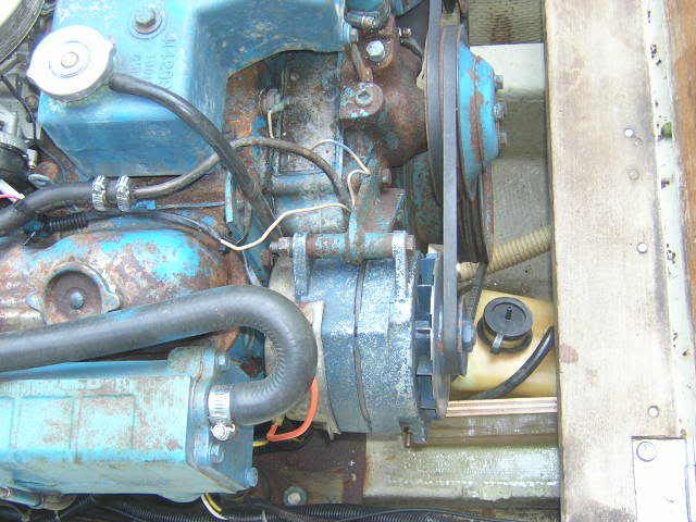

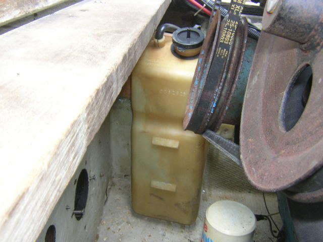

Added an antifreeze overflow tank... just visible ahead of the alternator:
Tight fit getting it in there. Tank is from a junkyard Jeep. This will keep overflow out of the bilge.
Installed new plugs, wires & coil today. Next is to run the engine for a couple of hours & check timing and distributor advance and see if everything is fit for operation.

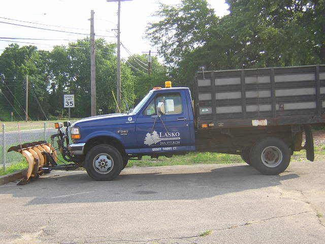

Found a tow vehicle:
1996 350 4x4 with a dump body. Turbo diesel w/5 speed. As you can see, some rust on the dump body from its life as a sanding truck but fine for my purposes.
