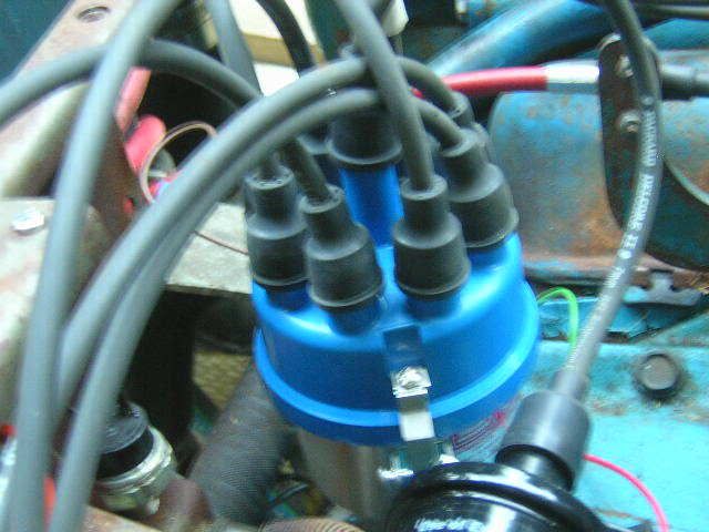

Finally
got the engine running again after tearing out the original Chrysler ECM ignition system. Strange how you figure things out sometimes. Usually when I sleep on a knotty problem, in the morning I have a solution to the situation. In this case what solved the engine problem was running the kicker... of all things. As I said, I'd torn out the old Chrysler ECM module & harness and replaced it with a new Mallory distributor which has a magnetic pick-up and electronic advance.
I have tried for two weeks on & off to get the engine to start. Not even a cough. Checked that timing marks were corresponding to the correct rotor position for #1 cylinder, correct voltage was getting through the ballast resistor, the coil was good... the whole works. Had spark from the coil and out to the plugs. Only thing left possible was that the timing was out 180 degrees. Triple checked that again and all was good. It
had
to run... but nothing.
Two days ago after messing with advancing & retarding the spark and running the batteries down I figured I'd move on to something else on the boat to at least get something accomplished. Decided to run the Honda kicker and check it's charging circuit to be sure it was functioning. Connected the fuel line up, which draws from the same tank as the main engine, gave the bulb a couple of squeezes and the outboard fired right up. Ran for about two minutes then quit. Figured there was still some air in the line so I gave the bulb another squeeze or two and the motor lit right off just fine. Ran for another minute then quit. If you've been following me on this, you've already figured out why the main engine wasn't starting. If the outboard was starved for fuel the main engine was too.
This afternoon put in 5 gallons of fuel, cranked the main engine about 10 seconds and:
My father always told me
"When all else fails check the fuel!"
I should keep him in mind more often.

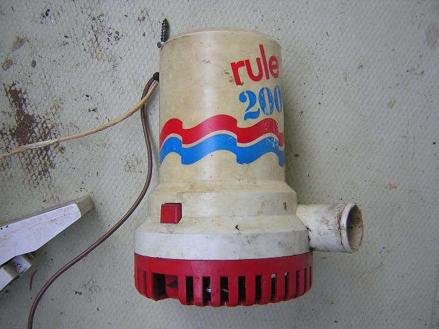

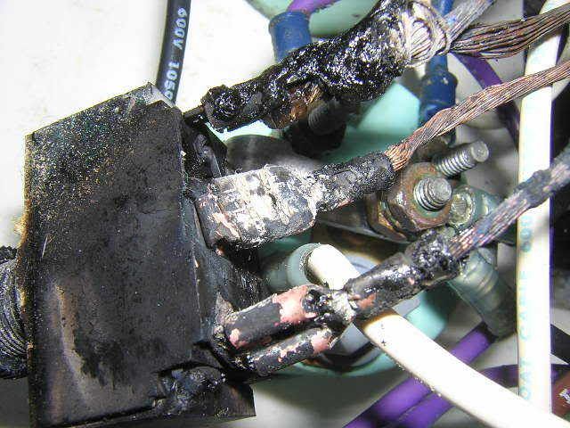

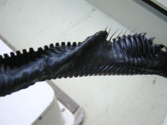

I've always preached about having bilge pumps on an unfused circuit. Today I changed my tune. From here on out EVERYTHING will be fused.
Here's what happened today. Because the shaft wasn't lining up perfectly to the transmission flange and the boat was somewhat crooked on the trailer, I decided to float the boat off the trailer, line it up perfectly and re-haul it on the trailer to see if that would help the alignment. Had seacocks closed, garboard plug in and everything pretty well buttoned up for the first "splash" of the boat since I've owned it. Since you never know with a new boat, I had the batteries aboard and the bilge pumps armed to go on if something unexpected happed. Well, we got the boat in and tied off at the float at the ramp. I pulled the empty trailer up the ramp to do some adjusting on it and tweak a few things when I got an alarmed shout from my friend who was helping me with the operation.
"The boat's smoking!"
Took me about 15 seconds to drop what I was doing and scamper down the ramp to the float and sure enough, smoke was rolling out of the console. My first concern was the gas going off but the smell was electrical... so far. Jumped aboard, confirmed the fuel shut-off was off then killed the main switch then disconnected the batteries from the circuit. The smoke stopped. Tipped up the console and the engine looked perfect. Peered into the console and sure enough it was electrical. Two wires had heated up enough to fry themselves and completely char the insulation off.
Here's what I found:
and the bilge pump switch...
Turns out the forward pump had ingested a screw somehow and had seized. Naturally, with no fuse in the circuit, the two batteries kept bailing the power to the pump until it shorted out and completed the circuit from one pole to the other of the batteries. The fried wires also caused some collateral damage to adjacent wiring. Things got so hot that it took out the switch panel. Second picture shows the copper buss desoldered from the hot side of all the fuses. Those two yellow & red wires are 14AWG.
The culprit:
So, today I got the shaft flange to align to the transmission but the cost was a bit high.
When I got home from the ramp I changed my shorts.
