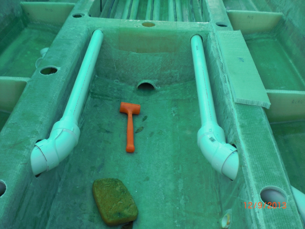

Here is a link to where I explain the thought of the PVC pipe
http://classicaquasport.com/smf/index.php?topic=13148.msg133124#msg133124
Here is a link to where I show what is actual problem
http://classicaquasport.com/smf/index.php?topic=13148.msg133556#msg133556
Here is a link to Hawgleg's rebuild that shows the PVC pipe installation to keep a drain at the new low point of the boat
http://classicaquasport.com/smf/index.php?topic=13148.msg134262#msg134262

I wish I had thought of the pipe before I did my rebuild. Now I always have water a foot in front of the garboard plug and it takes either raising the bow way up or I need to use a sponge to dry it out. We have a member that drilled a drain in the bottom because he couldn't get the water out of his either.
The purpose of the pipe is to compensate for the low point being moved forward as you add all the fiberglass and core to the transom. You'll be grinding the pipe down after you finish getting the transom in. After you glass the pipe in and finish the laminations of the transom you can pour some water in the bilge and see where the new low is and grind the pipe to that point.

I gotcha now... 3 times looking at your pic, and this final description i see where youre going.

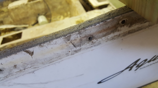

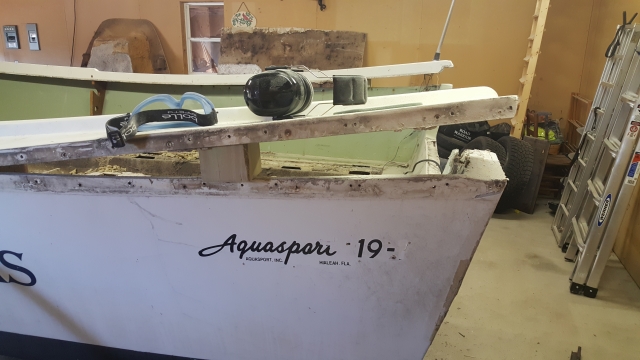

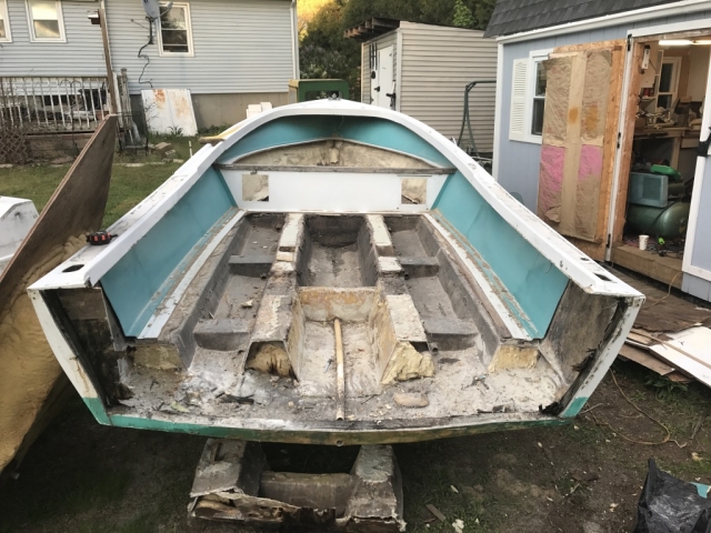

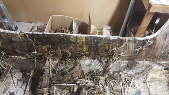

So.... it was definitely in need of a transom.... Pretty wet. I'm glad i decided to keep digging.
Another question, I can tell that there is a hollow spot behind the liner down by the deck, but up under the cap, it appears as though the liner is attached to the hull..... I'm very hesitant to cut this with the angle grinder... Whats the best way to separate the two?

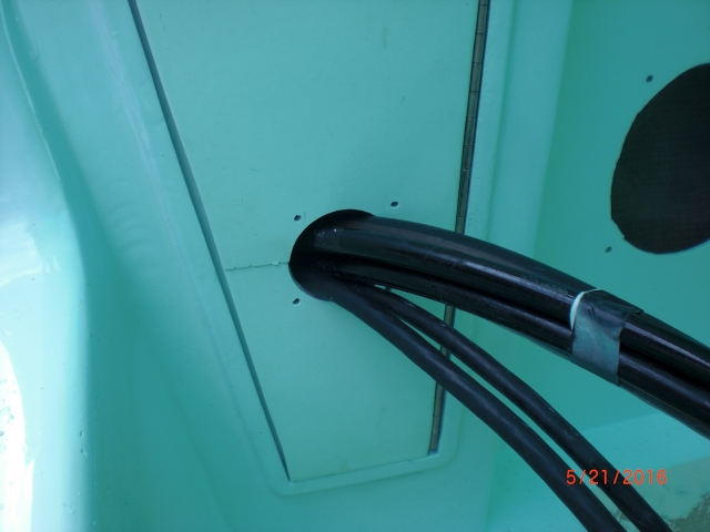

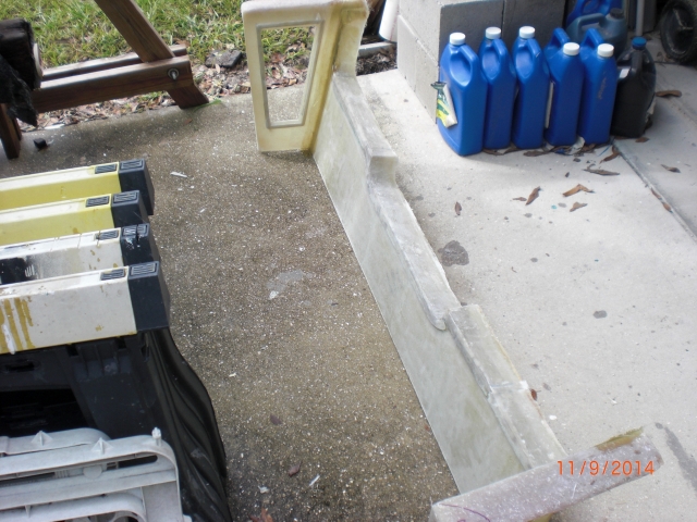

Here is a pic from the rebuild I linked above.
He decided to cut out the transom but you can see the liner along the sides. He cut it and the stringers back about 18" from the transom. The cap will be in the way of you getting the core in the boat. You don't have to cut it but you will need to release it from the hull it so you can prop it up, which allows you to slide the core in from the rear.

If you want to save the liner on the face of the transom, its possible if you're gentle while prying on it and make sure you release it all around. Take your time.

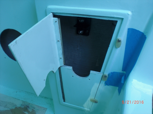

Having it intact will allow you, after the new core is in, to glue it with thickened resin troweled on the core. It won't be structural but it'll save you from finishing the inside of the transom. If you look in my rebuild of the 170 you'll see the liner I made with side cabinets and glued it all in. I built it from scratch but it might give you some ideas. Everything you see in my rebuild was my first time trying it. Everything you see was made from scratch, stringers, floor, console most of it) virtually everything. You can do it too.

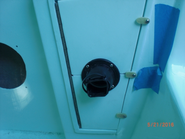

Here is a glimpse so you don't have to spend a couple days looking through the thread. Like your boat, I had a trough and that was the only way to get cables, wires, etc. to the rear, or anywhere. I ran pvc pipe to the corners of the boat and I needed to hide and protect the openness of the pipe - cabinets were the idea
Liner/cabinets
Installed and running the cables/wires from them
The thing you need to understand is if you can build a box in wood, you can do the same in fiberglass. Fiberglass work is easy - try something and if you don't like it, grind it back down and try something else. And don't be afraid to spend a day or two staring at the hull, thinking things through.
And remember, we're here to help.

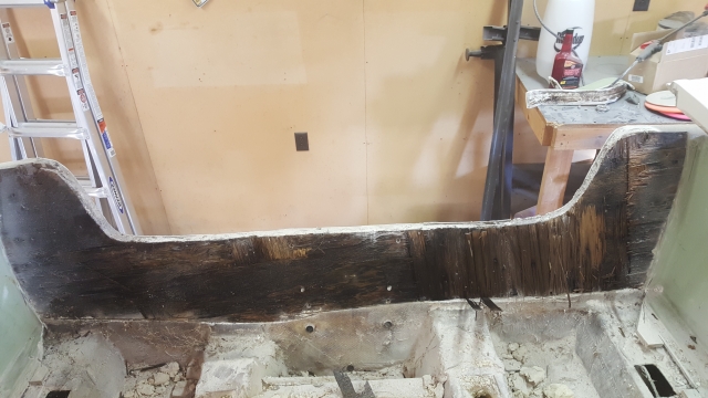

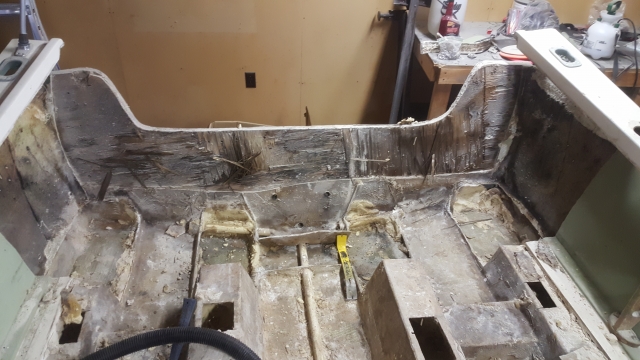

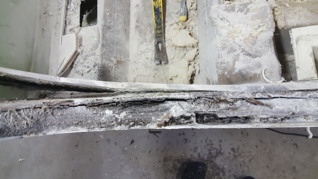

So... My buddy made me feel guilty for lack of progress, so I spent a few hours in the garage during the ice storm. Cut everything within 18 inches of the transom as prescribed. I've been putting it off, out of fear of damaging the hull with the grinder. Used the Dremel and a Rotozip bit, came out way easier than expected and much less dust to clean up.
I was about ready to walk away, when I decided to spend a few minutes digging at the wood in the transom. Not really much integrity left to any of it other than the outer foot on both sides. Definitely needed, and I would have regret not doing it as soon as I tried to hang the outboard. All of this has convinced me to break down and buy a below deck fuel tank. I had myself convinced I'd live with an above deck, but, I might as well do it while I'm in here.
