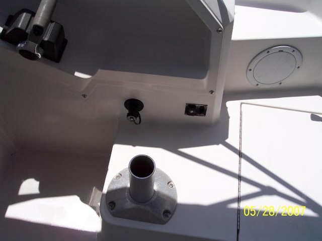

Anyway, I cleaned up everything, wire brushed the bronze thru hull and headed to Boaters World.  I bought a bronze ballvalve, some hose, a few fittings AND a Johnson 70psi washdown pump  8)
Here is what I came up with:
I don't have any other place to mount the pump, so it had to be in the bilge area.  The last few trips had a yield of ZERO water in the bilge so I'm hoping that this construction will not change anything.
While I was in the bilge I mounted the fresh water 3.5gal/min 40psi FLOJET pump on the other side - next comes the fresh water tank in the bilge area.
I didn't want a bunch of hose laying around on the deck so I found a great (IMHO) spot to mount the connector and switch - under the helm seat.
Once connected, the 25ft hose will give us plenty of hose to get to the extreme front and back of the boat without even beginning to stress or max out the coil.
As you can see, out of the way.  The hose will be stored in the compartment under the seat until needed.
I will put a matching setup under the Port helm seat for the fresh water /rinse setup.  Johnson makes a nice control plate - SPST with indicator and fuse, on one plate.  I'd like to find a way to buy another of those for the FLOJET I have for the fresh water side.  Haven't found a way yet.
Any ideas?

Glad you busted that plastic fitting in the driveway.  Hole in the boat that size will let in a lot of water fast.  Pump location looks good!
