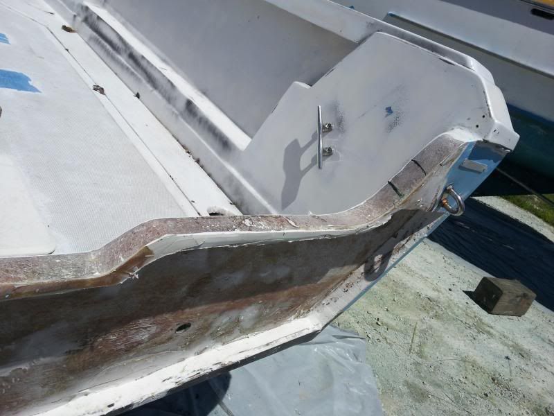

none of the teak came with the boat. right now its just the edge of the fiberglass. its clean, straight and painted but i may add a trim piece of something later. but if i understand this right, i now probably have not mounting point? is the piece in the pic the rod holder or teak trim piece? here is a shot showing what my cap looks like.
not a great pic. but you get the idea.
this shows the rear a little.
