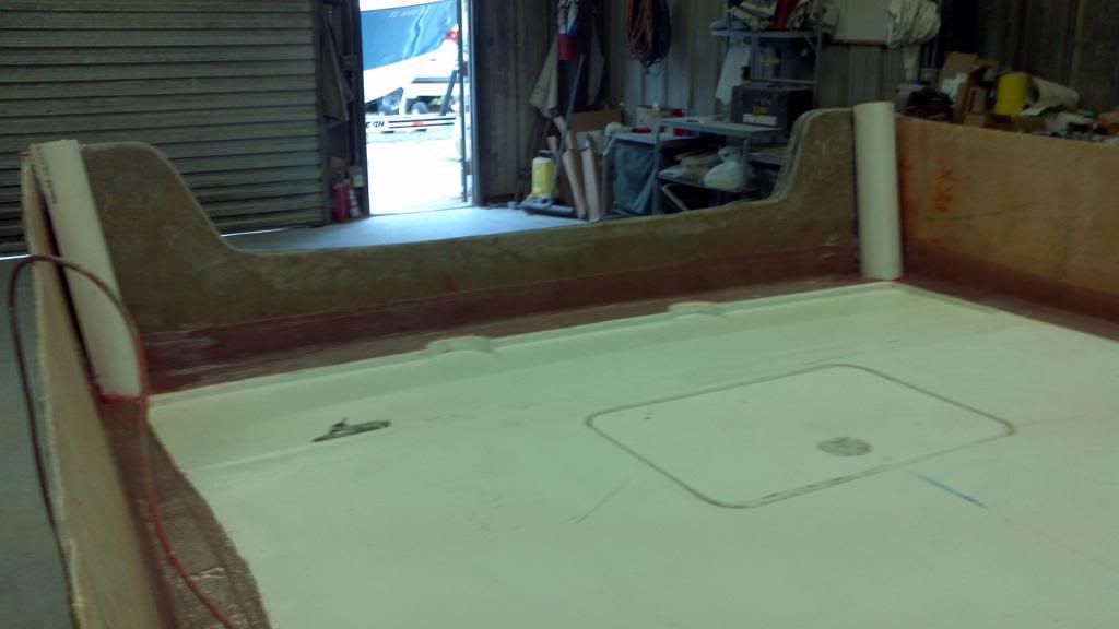

Gotta love nidacore for bulkheads. Wish they made it with a lil more glass on the skins though! Whats your guys' method for filling the cells and bonding the sole? Arjay probably eh? Neverbeen a fan of the nidabond stuff. Fasteners?...

Check out page 11 of shortpants' 222 redo. Its all a chemical bond, not sure what there using for bedding?

Deck is in. You can see the flush folding sea door recess as well as the rigging tub recesses. The half rounds in the transom corner are to be chases for trolling trim tabs.

Thanks Gran398, as I understand it, he put a 3/4 sheet of Penske on top of the stringer and a 3/4 sheet Penske in the deck at the loctions above the stringers giving 1.5" of material to screw to. The rest of the deck is 3/4 Nida core. The deck is built in reverse, like from a mold, meaning 1st gel coat, glass, core, glass and flip over.
