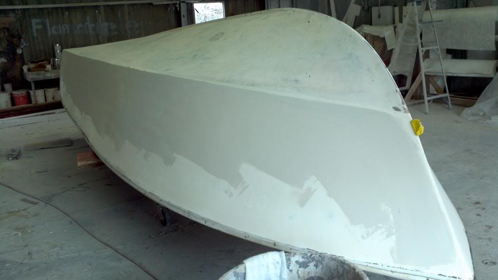

fairing continues.....

Eugene's got the keel extended and fairing continues.

That Eugene is quick!  Any details on what materials were used?  And any science behind stopping it at that point?  I'll be doing the same thing to mine eventually.

Quote from: "CLM65"
The core material was Penski board. Not sure about length yet?
