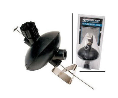

ive seen that many times, many of our customers buy the expensive dual feed ones, and almost immediately threw them away...
the only 2 style muffs we use are the good ol'fashioned 6 dollar ones and the mercury clamp on ones. the only time we've ever had an overheat alarm when running any engine on muffs was on boats that where not in the best of shape and the owners rarely maintained them.
there was a TSB on the merc flush that because the inlet is at an angle, it its facing the wrong way it could trigger an overheat alarm...

Do you guys have the one that fits over the nosecone for SSM and Speedmaster LUs?  I've found you have to get those things super tight to the bullet for them to work properly...
