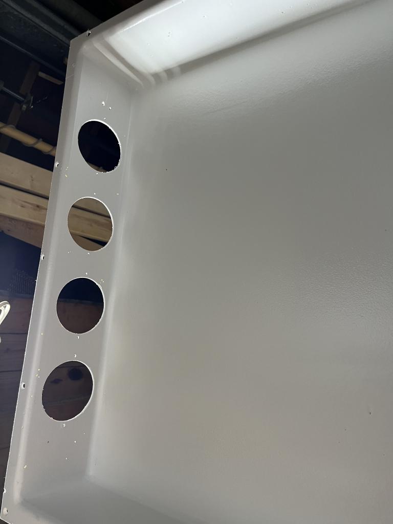

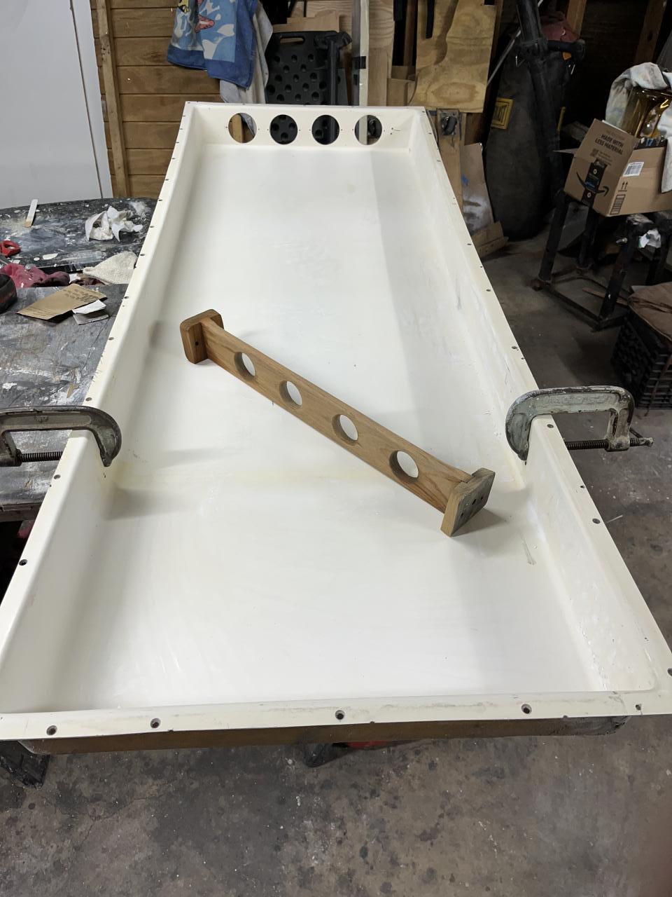

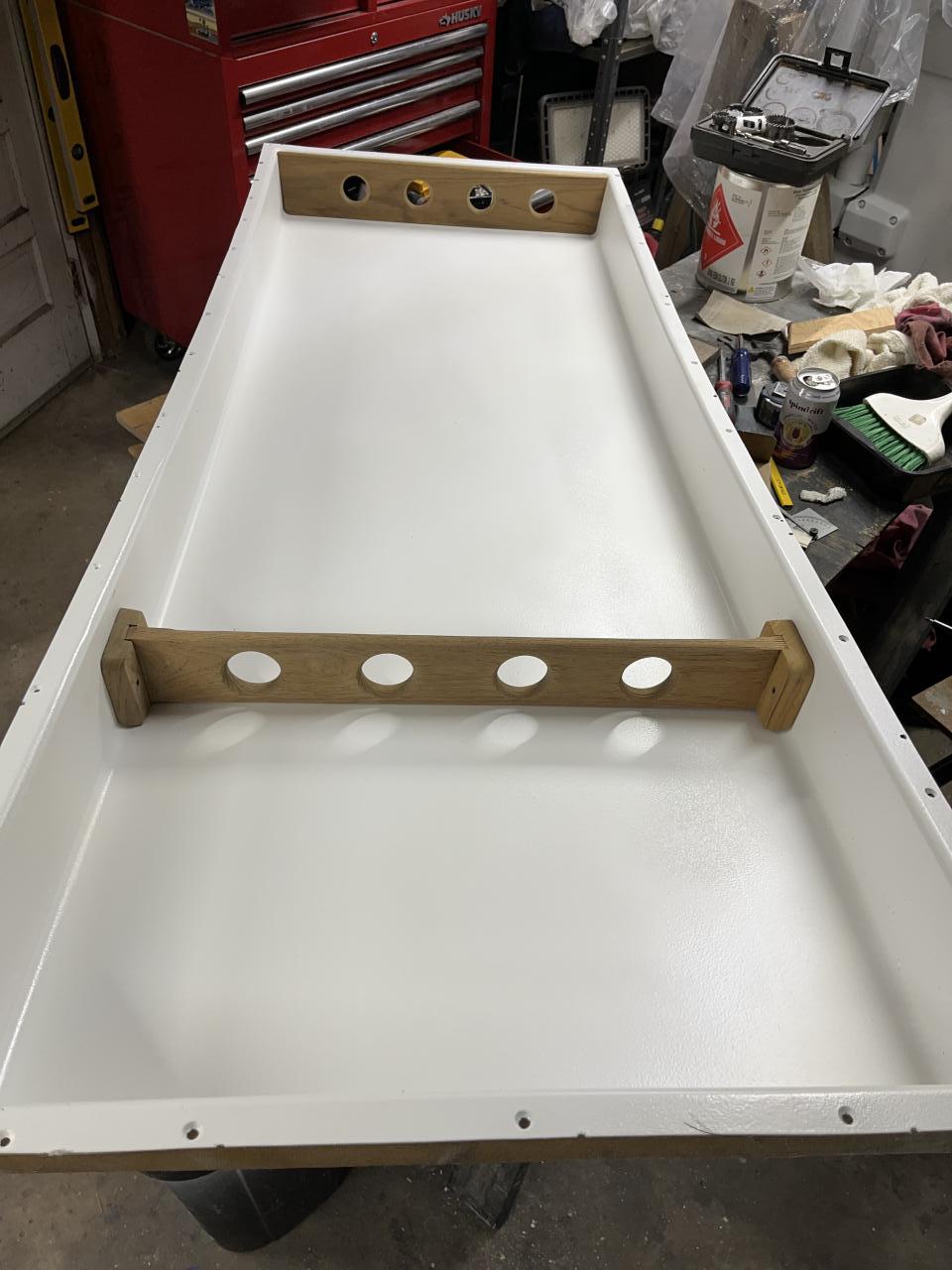

Getting started on the port and starboard gunwale rod holder inserts.
Freshening up the inserts. Faired all the pinholes and damages with gelcoat/cabosil. Added backing plywood blocks where the mounting holes will be. I will shoot them with gelcoat and wet sand them down to the same luster as the hull. Then I will start the Teak. I have ideas. Time to start turning these scraps into beauty. The port insert remains a rod holder but a little more dressed up than stock. The starboard one will be like nothing no one has ever seen before. Stay tuned.

October 09, 2025, 04:10:58 PM »

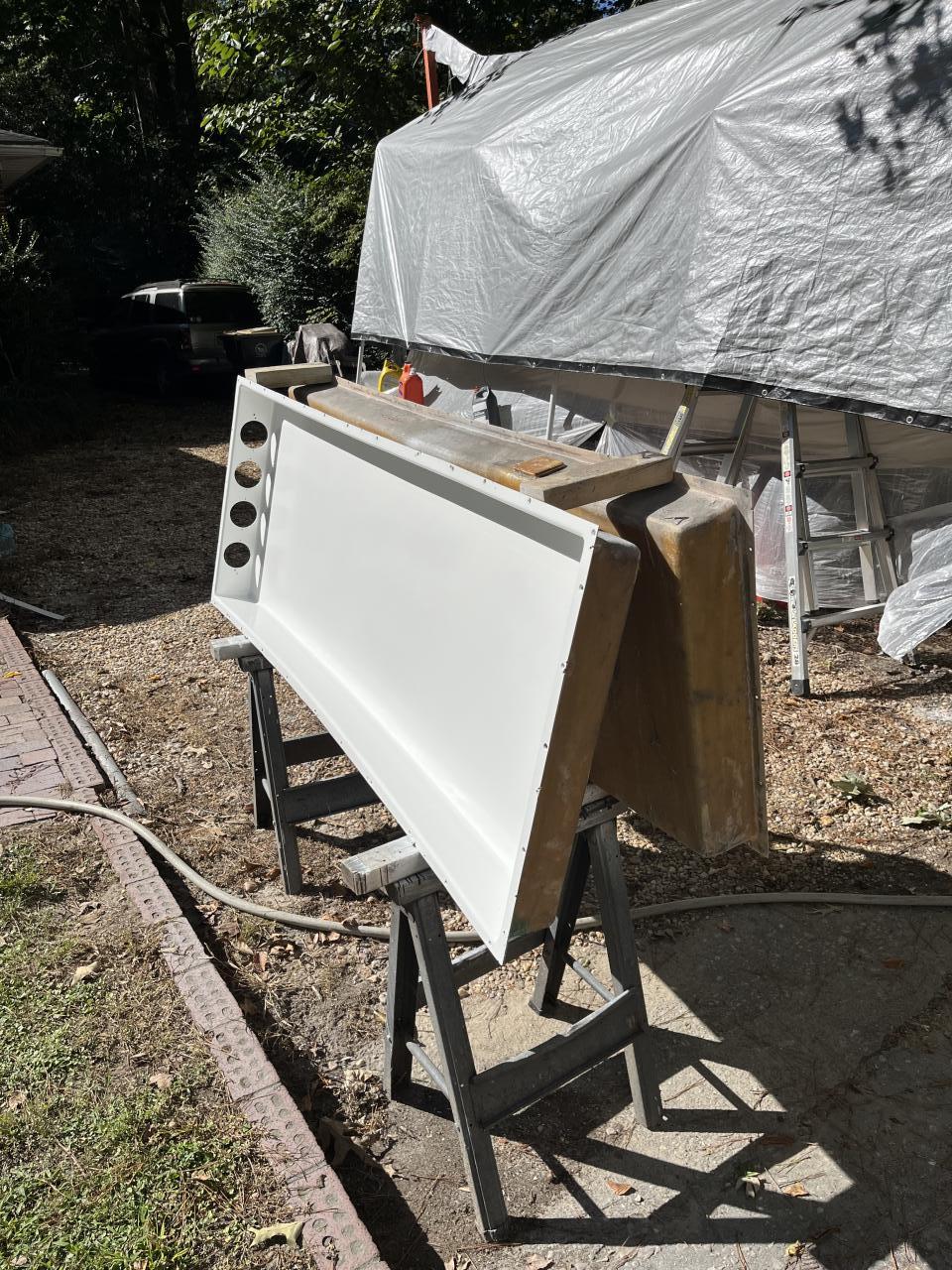

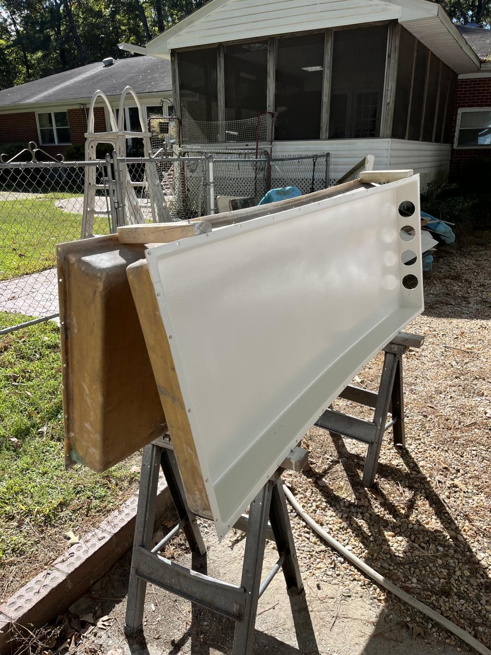

Like new
2 coats gelcoat with 1/3 duratec, 2nd coat wax. They say you don’t have to wax with duratec but I have mixed results snd it doesn’t hurt anything. Going to let it set up a few days then wet sand. In the mean time I’ll get on some teak work.

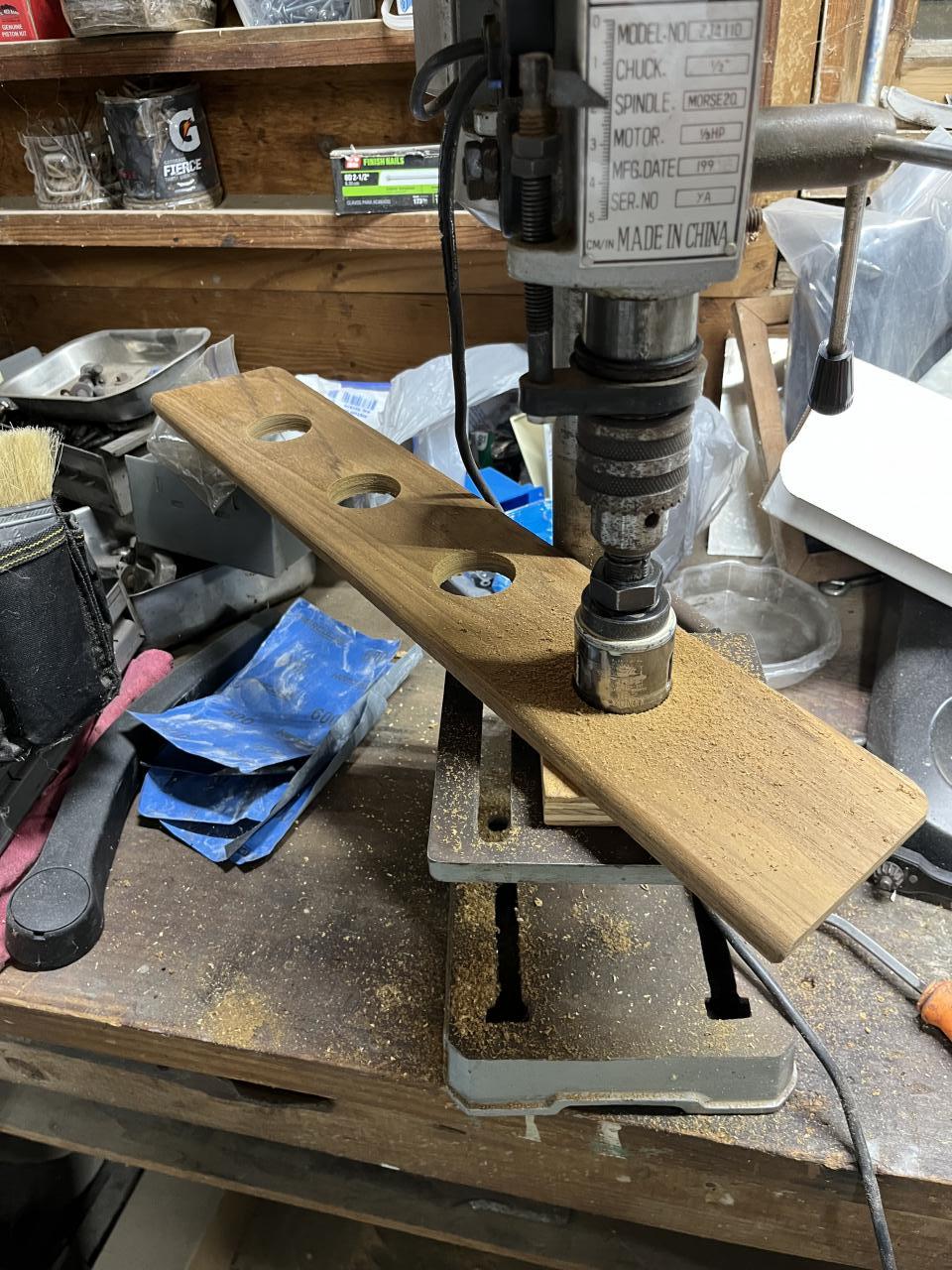

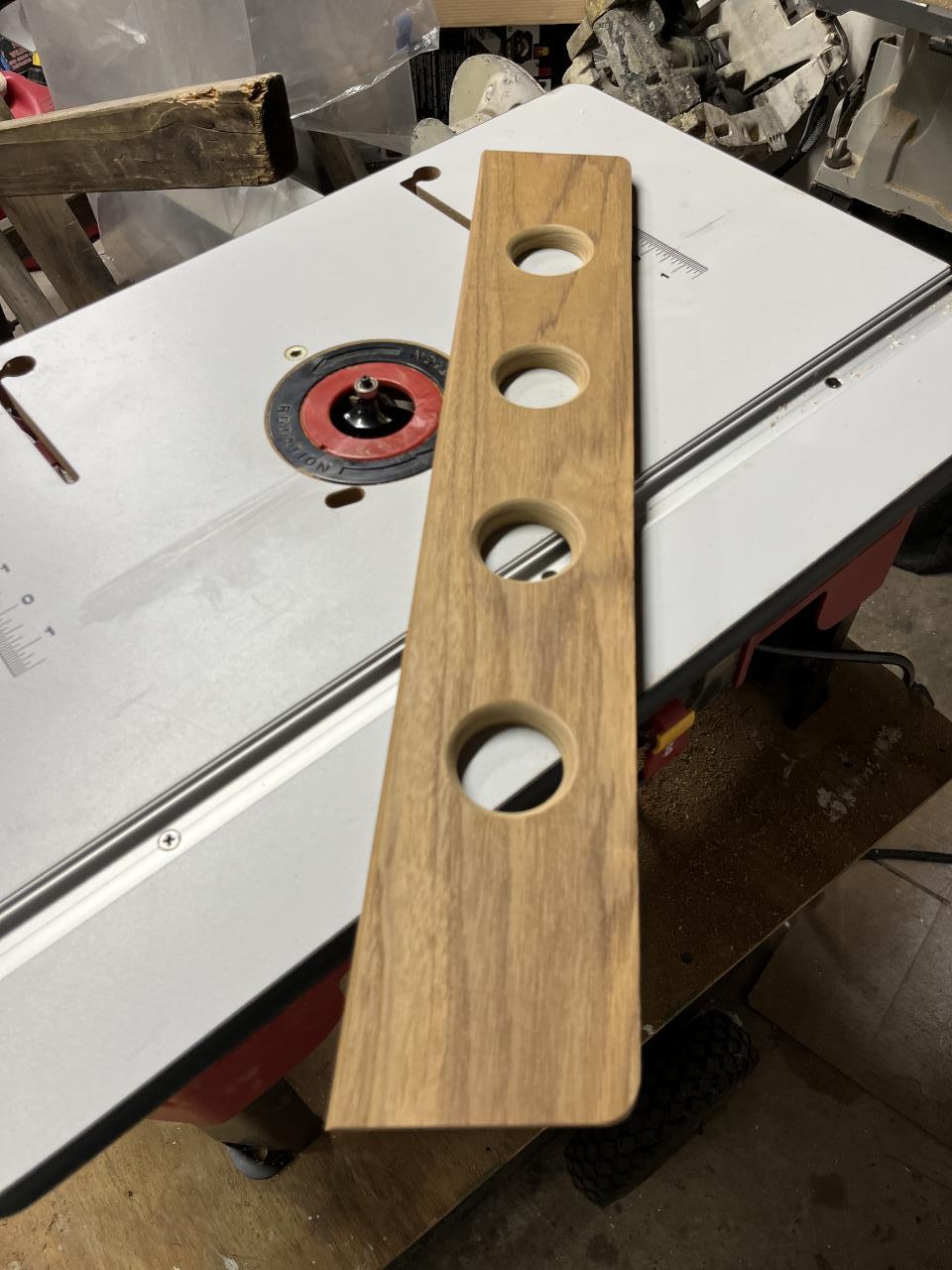

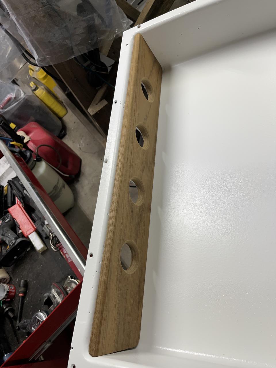

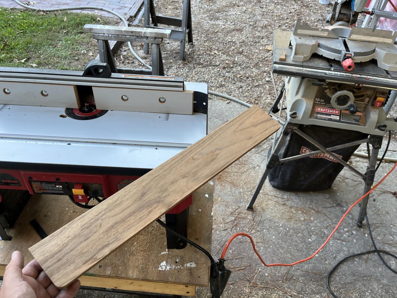

Not as easy as it looks..
It’s 3-3/4 wide but it’s 23 inches inside height to 23-1/2 inches outside. The 3 back edges are routered to fit the contour of the insert but edge facing out is routered for looks.
I have no idea who cut 3” holes for rod tips but it looked horrible. Fixed it.
Next I have to cut the 4 rod tip holes in the teak and router the edges round.

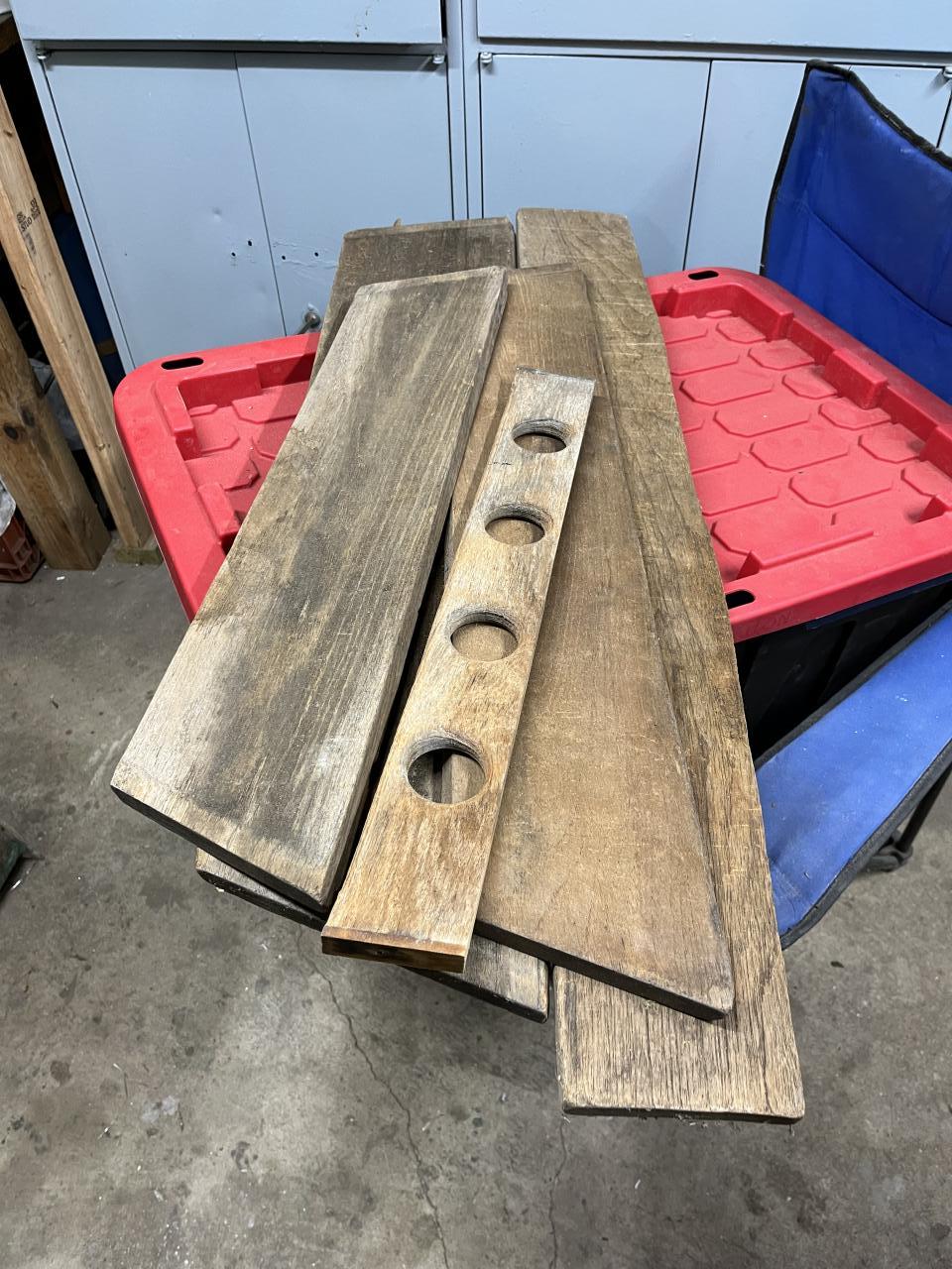

A planer is your best friend for renewing old teak. It looks amazing. This piece is one of the old crusty pieces in the photo above after a few runs through a planer. Can’t wait to hit it all with a coat of Sikkens Cetol.

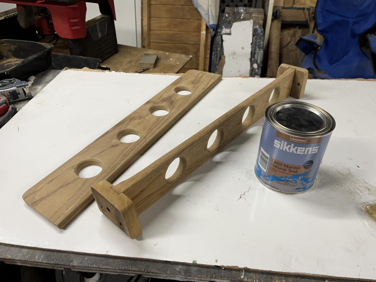

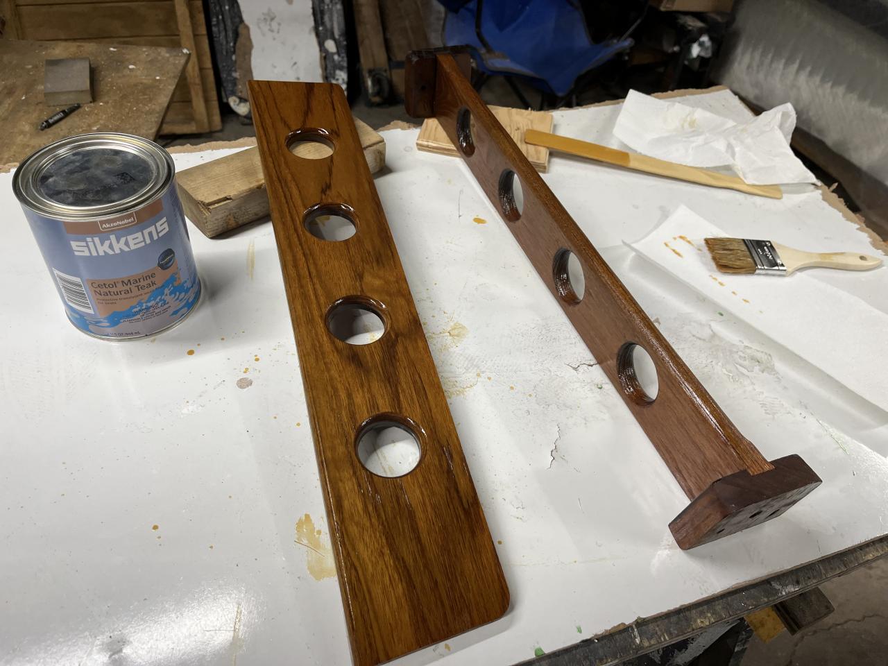

Measured out and drilled the holes.
1-3/4 hole spaced 4-5/8’s apart
Rounded the opening edge on a router

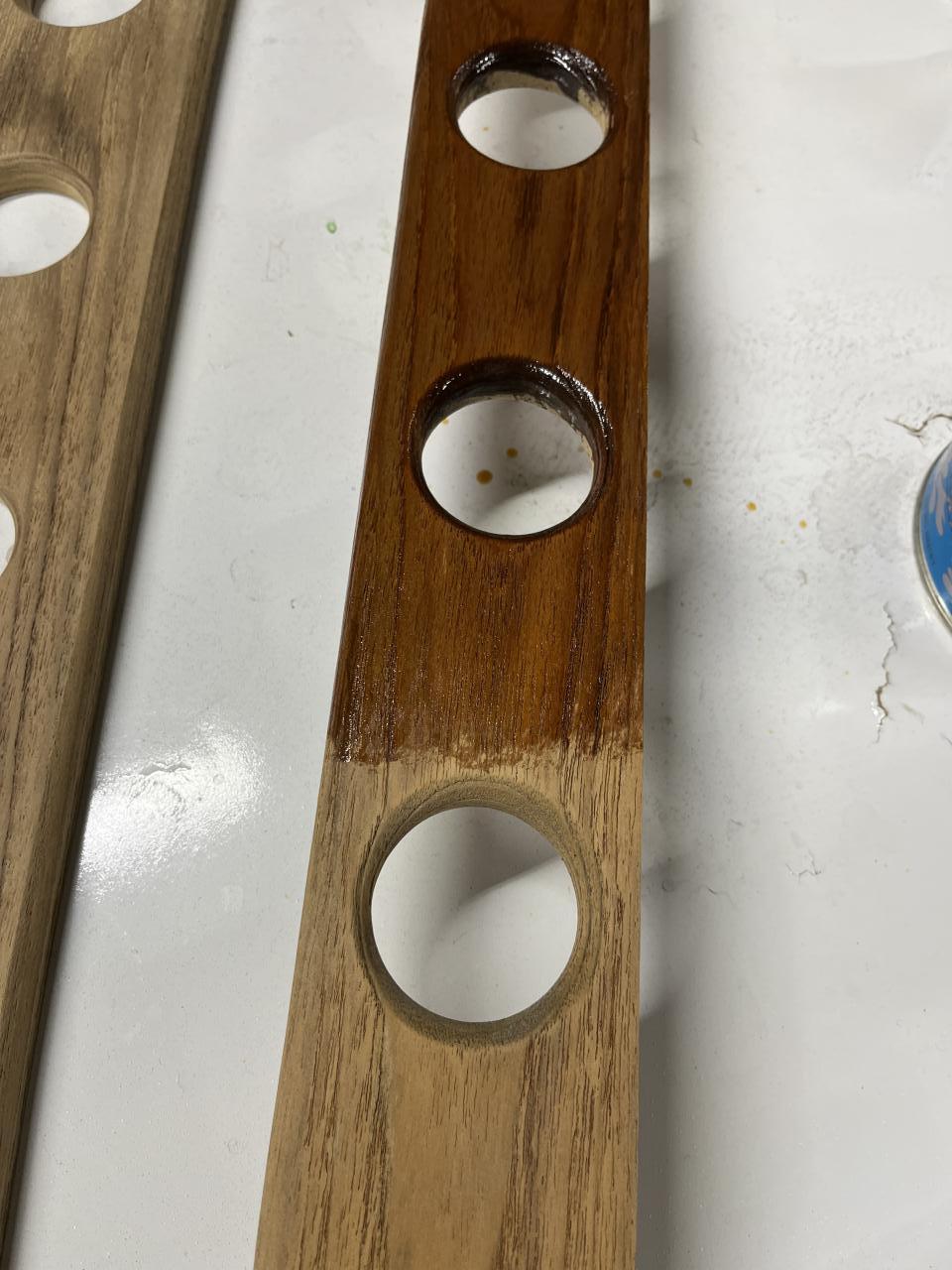

Test fit…. Now that’s the look!
There is nothing like bright teak. Cetol is amazing. This is first coat. It has to dry then the 2nd coat makes it like glass.
Just simply beautiful. I will take great pleasure in restoring/replacing all the original teak and then some!
