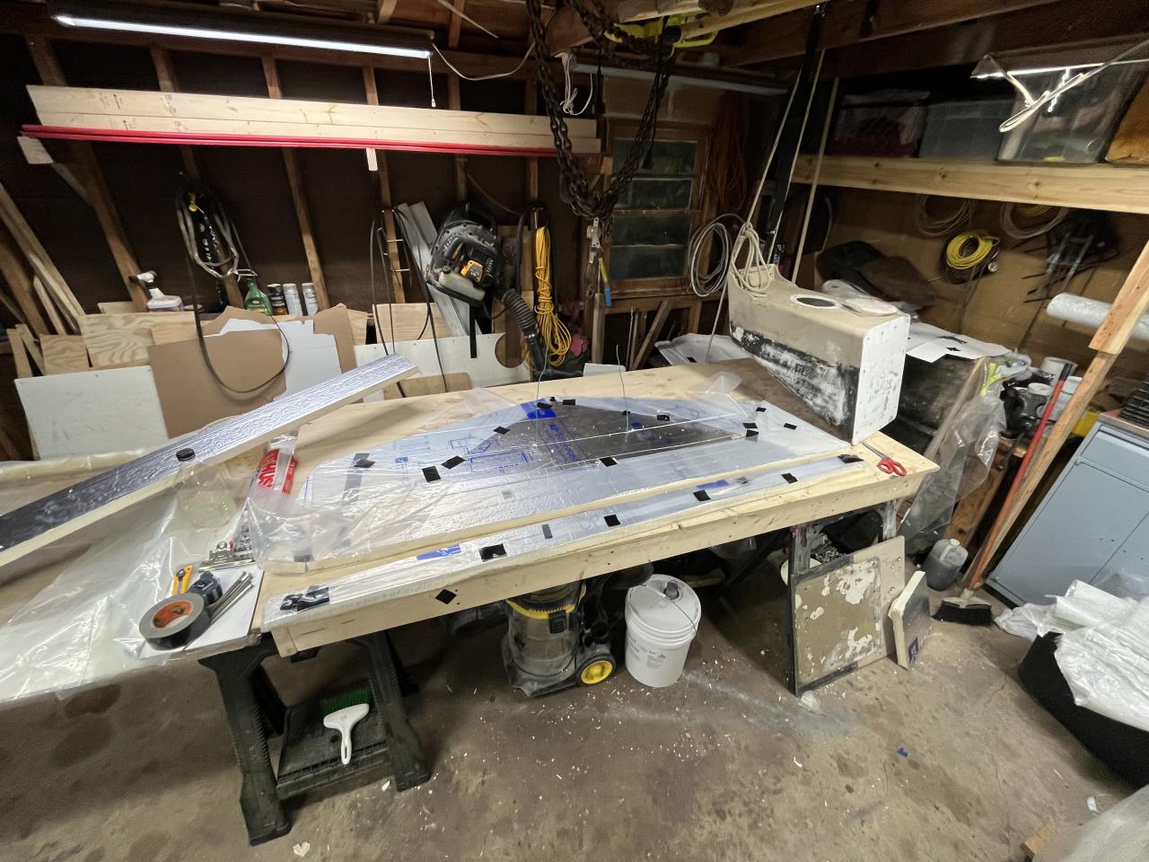

Gas tank cover is ready for Seacast. Below you see the before and after of the last layer. It’s 3/4 oz chopped, 1.5 oz chopped and 3 layers of 1708. I remembered something yesterday that i knew but forgot but wish I remembered for the transom… altering directions of the biaxial strands. 1708 strands run diagonal so in theory for maximum strength you should run each layer so the strands cross each other in an “x” pattern instead of always going the same way. That’s what I did here for the last layer thus the overlapping seams. I was also using up some of the piles of cut pieces I have as I want to make sure have enough glass to finish. So now the strands of the last layer run 90 degrees to the prior layer. Does it really matter? Is it going to crumble? I think not. But it would definitely maximize strength to run the strand orientation at 90 degrees to the prior layer.
The transom… wish I thought of it then but I’m not sure I would want seams in half of the 13 layers. My saving grace was that the 2408 stands run lengthwise on the roll while the 1708 run diagnal. So I am content knowing that I have a mixture of horizontal and 45 degree strand orientation on the outer transom. Does it really matter? Again not really. The inner transom 8 layers will be orienteering opposing.

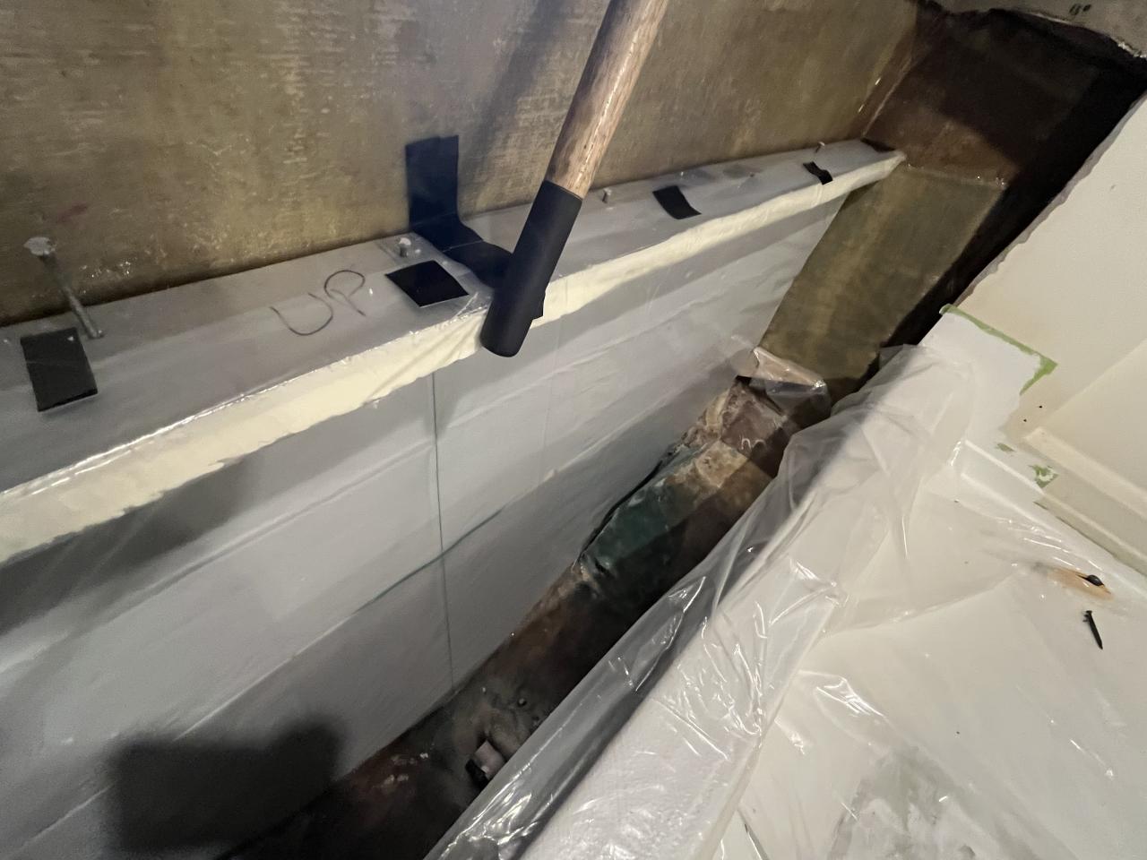

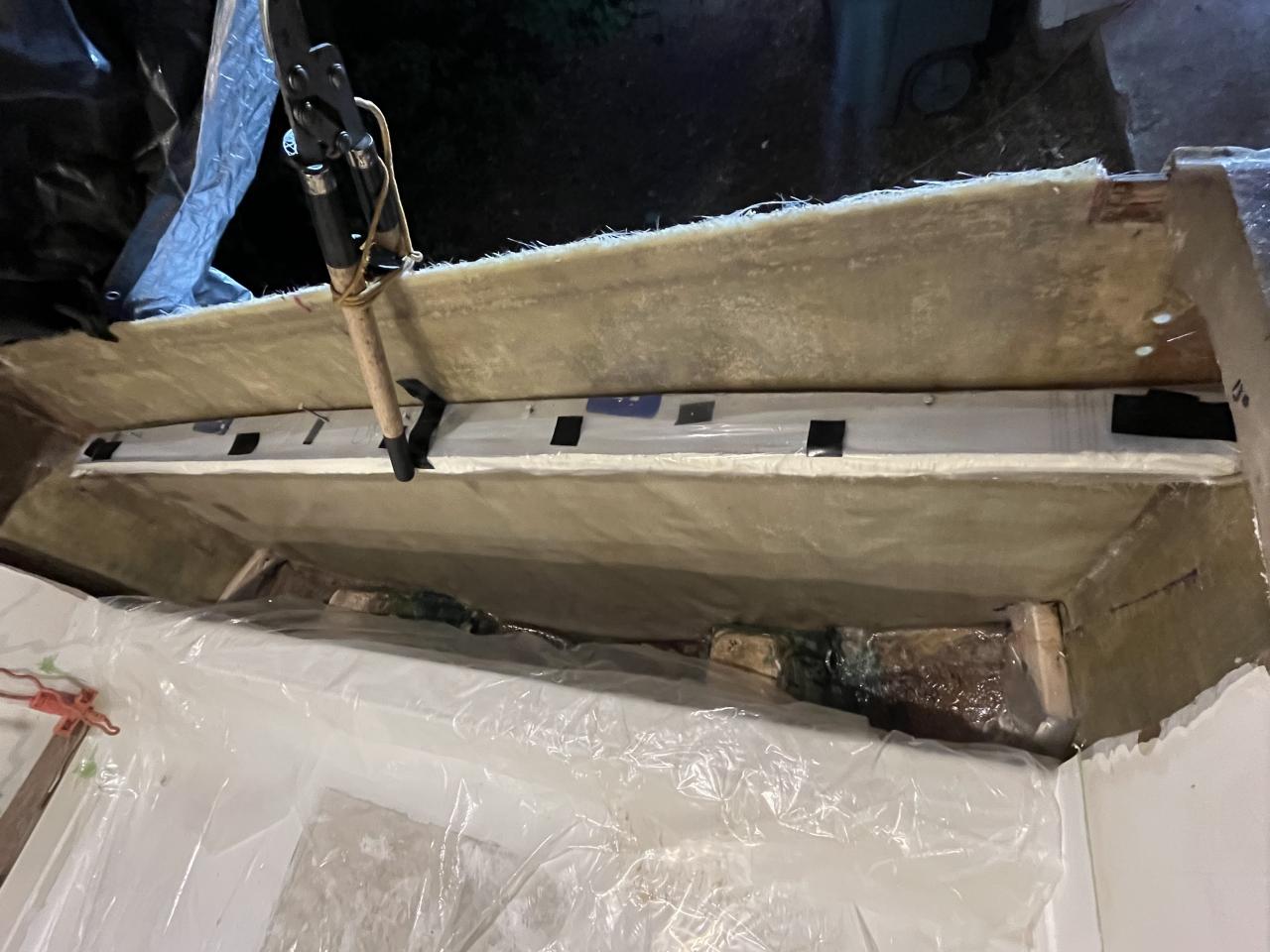

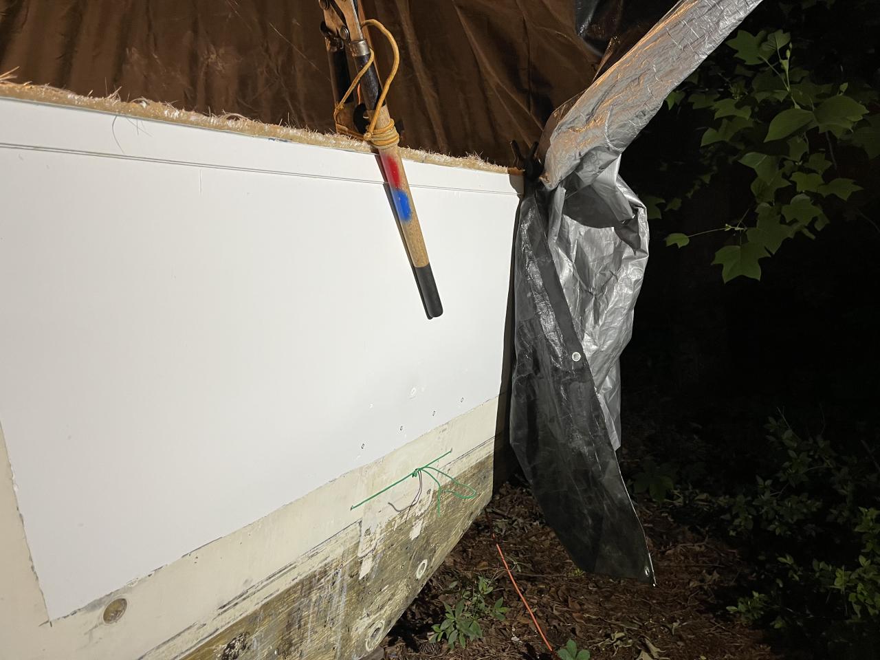

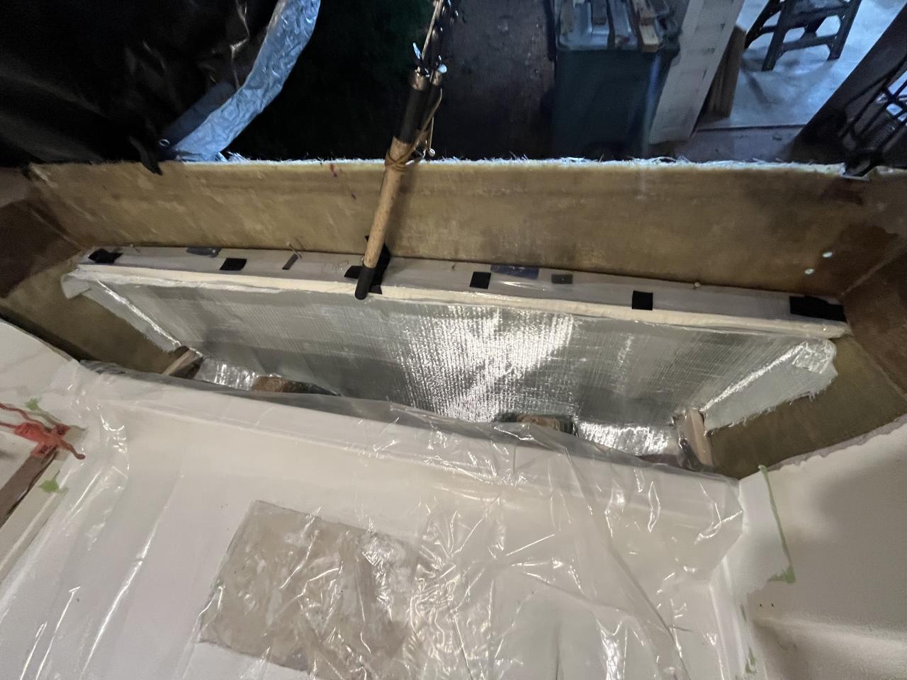

Inner transom skin layer 1
I took my foam mold plug and wrapped it in sheet plastic so the resin doesn’t stick and I can retrieve the foam. I do not want to use any wax or anything that would inhibit the bonding of the sea cast.
The challenge is getting the flat foam board to contour to the curved transom. I made horizontal slits along the transom side and split the foam so it’s like a roll top desk. Then I fished a wire through two of the bracket mounting holes and pulled the foam against the transom. Then I added two blocks in the corners and screwed them to the expendable glass covering the floor drain thru hull holes. I wrapped everything in plastic so the glass won’t stick. I then cut a curved piece of iso foam so it matches the top contour and pressed the foam against the transom as I drove long nails through the top piece and into the plug foam. I want to create a 90 degree outward lip for strength. Any time you put a 90 along a long flat edge you strengthen it. I will have about a 2” lip when I’m done.
Sometimes you have to be creative…. I needed something to hold the foam against the transom and didn’t feel like breaking out the tools to make something out of wood so lopping shears and a bungee cord will do just fine. You can also see the green wire that I used to hold the foam in place.
I set a piece of 2408 in there and trimmed where necessary to fit. I am not too concerned about it being perfect I just want a strong base to work off of. I will clean it all up nice and tight as I go. I am going to knee wall the stringers to the transom as well.
Well I’m 52% satisfied with how it came out. My big mistake was not spray gluing the plastic sheet to the foam as now it’s a little wavy as the plastic “curtined” and bellowed and didn’t stay flat. I almost pulled it all off and trashed it but the reality is all the waves will mean is more seacast to fill the slight voids. It’s not terrible but I would have loved it flat. The fiberglass kept wanting to slide down with gravity so I kept fighting to keep the piece in place. It was a tough one. Definitely sweating to keep it in play. Maybe would have been wise to do it in two horizontal halves but too late now. It’s in. It’s okay and it will work but it not 100% to my specs. Live and learn. That’s why I’m not a pro.

The seacast is ordered and will arrive this week. I am building the inner transom wall to create the cavity where the seacast will be poured into. The foam board is a plug to hold the fiberglass in place. The foam board comes out later and the seacast goes in.

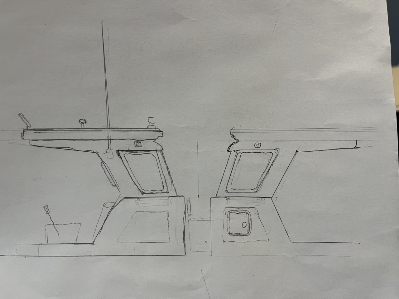

Rain for the next few days has me stalled for glassing. I’ve been hitting the paper doodling the pilot house. The original plan was to build a shell around the existing center console. That plan is all but negated assuming it makes no sense to leave the other 3 sides of the center console in place. Makes for wasted space and hack work to fill those spaces. Seems like I am leaning towards a custom helm as well. Basically I will mimic the face of the 200 CCP center console. I kept the center console from my 200CCP and sold the 246CCP console years ago as I did not like that it was taller. With that said I may have a 200CCP console for sale at some point as I won’t need it if I build from scratch.
The Ah-hahh moment that sealed the decision was floor mounting. After putting this floor in I am VERY conscious of any screw hole I need to make in it. Screw holes are where your floor rotting water makes its way in. The center console has an exterior flange with many screws to mount it. I though about making that flange internal so I have a better chance of sealing around the outer edge and protecting the screws and holes inside the console. More to come on that.

So i doodled… this is where I think I’m headed…
