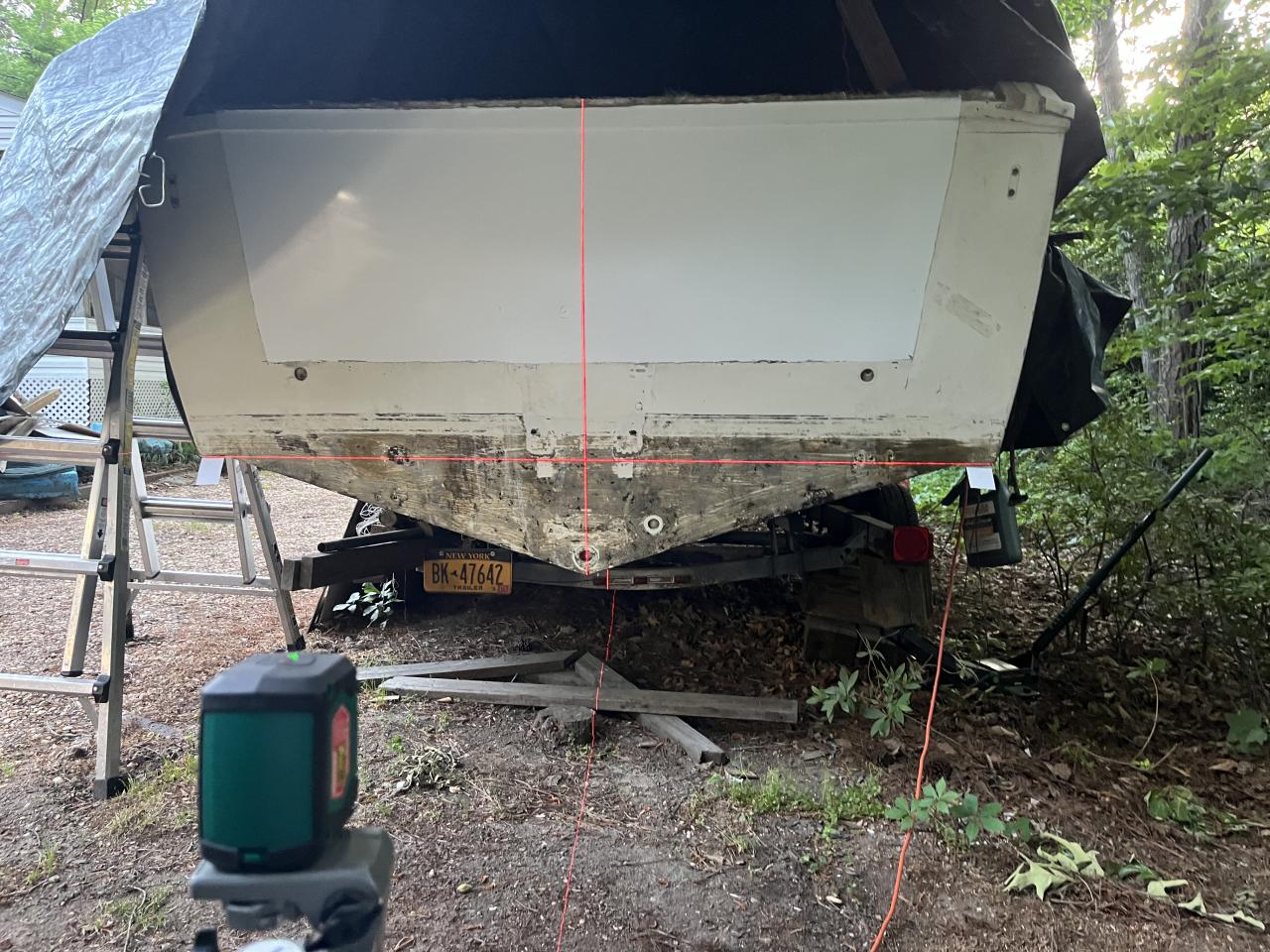

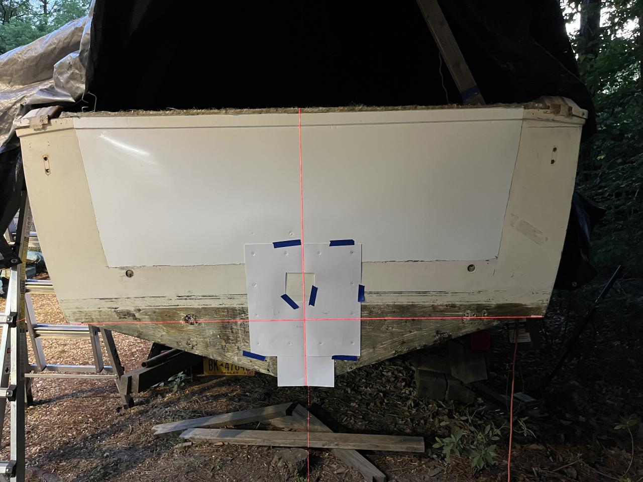

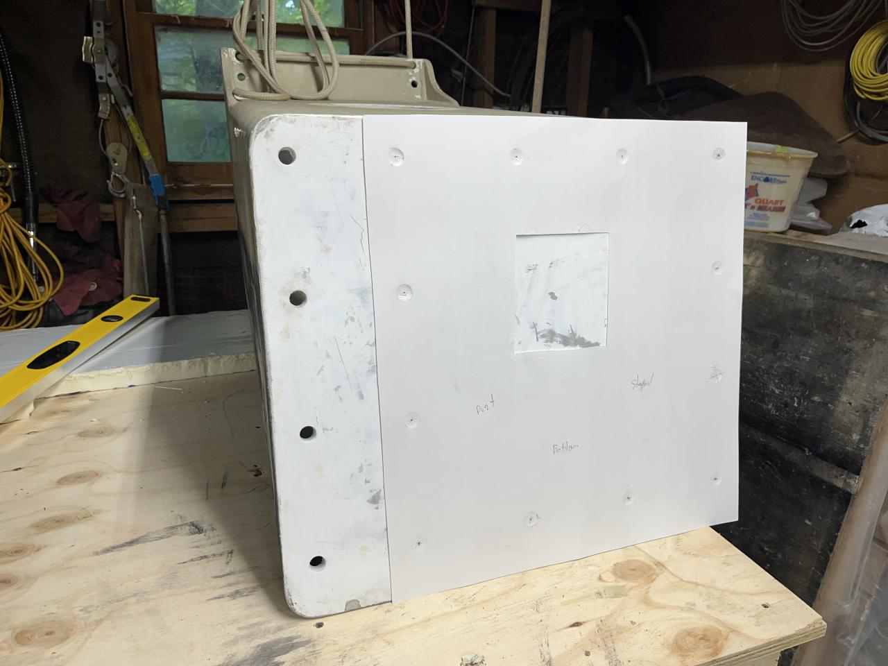

Another milestone day in the books. A day I have been anxious about for a decade… where does this bracket go exactly? After much research, measuring, math and deep thought I finally committed to a placement. Nothing out of the ordinary. By the book. Cavitation plate 1” up for every foot out… 2 foot bracket means cav plate 2” above bottom of boat set up for a 25” leg. The better way to go is a 30” leg to keep the Powerhead out of the water. Think of a seesaw with the transom as the fulcrum. As the boat teeters the power head dips lower on a bracket than it would if on the transom allowing possible water intrusion into the lower cylinders through the exhaust ports. If I should come across a 30” leg or an extension kit I can add a jackplate and gain the 5”. That is also why I settled with the 25” setting because if I committed to the 30” setting there is no going back. The 25” setting may be enough.
****EDIT**** on review I noticed that I do not have the space to mount the bracket 5 inches lower as I would run out of transom and the corners of the bracket would be below the bottom of the boat so I could not set it up exclusively for a 30”.

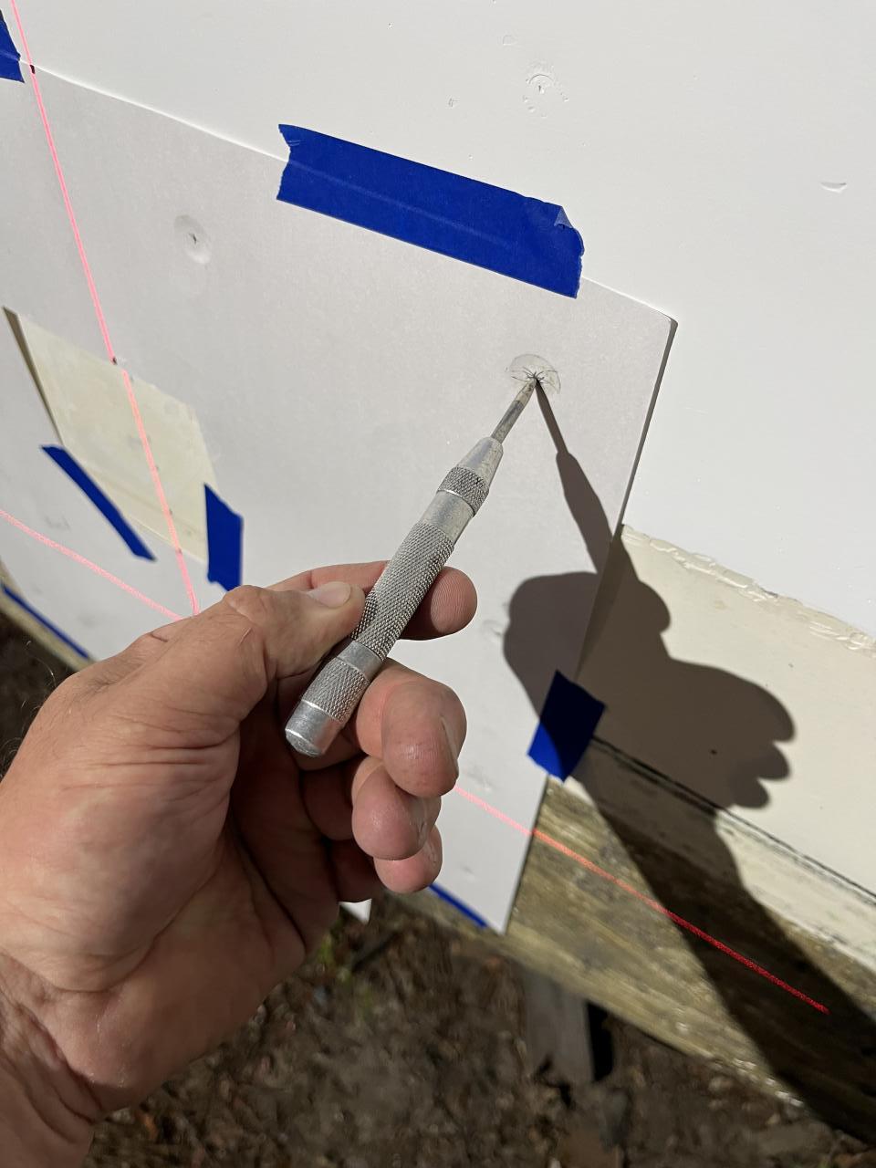

I started out with a sheet of oaktag paper and created a perfect match template of the bracket. I cut the paper exactly to size then gently pressed the circles to imprint exact locations. Then I used a compass to find the exact pin point center of each of those holes

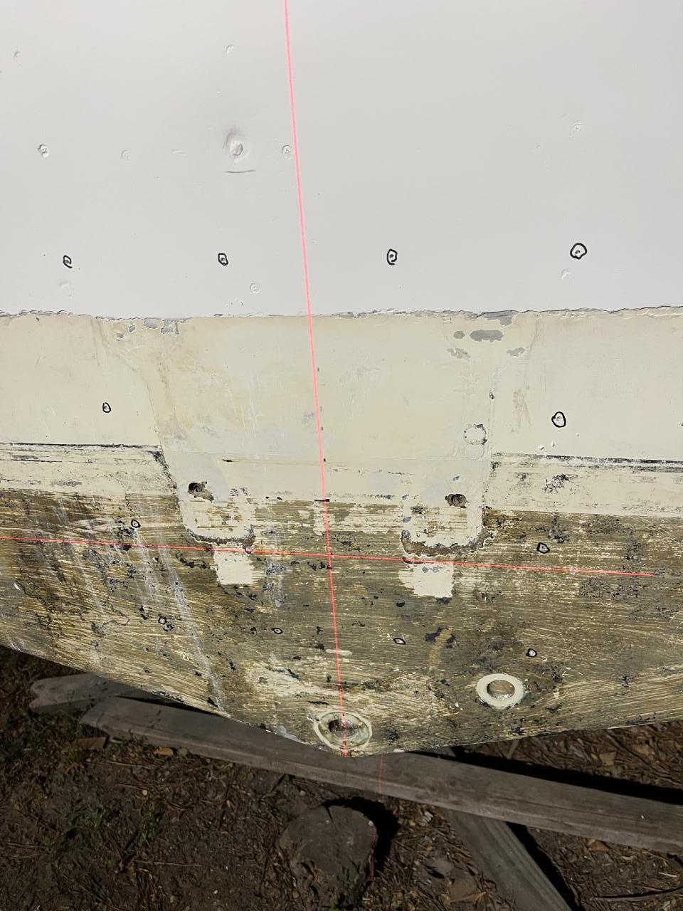

I then used a laser, jacked the boat level based on the two outer flat sections of the hull. I put a piece of white tape at those locations to help me see the laser best. The flags you see in the first photo didn’t work as well as the white tape. I added a piece of oaktag 5 1/2” tall which is my measured distance from the bottom. Folded all all my templates in half to get center. Measured and measured and measured every way that I could think of to confidently place the template and used an automatic center punch to mark the center points. I then used a very small drill to make the points a little easier to see.
I will then use this gizmo to drill perfectly square holes. Not so critical now being I am only drilling through 1/2” of glass but I will be super critical when I’m drilling the core.
NOTE: In writing this post I realized what could have been a terrible error… I applied the template backwards. The side I was working on at the bracket should have been AGAINST the transom and not facing me. I ran out to the boat reapplied the template and checked my holes. Gratefully the Stainless Marine Bracket is precision made and the centers all lined up. Whewww. That could have been really bad if the hole spacing wasn’t accurate. There is a slight margin for error as the bracket holes are 9/16” and the bolts are 1/2”… so there is some wiggle space in case it’s needed.

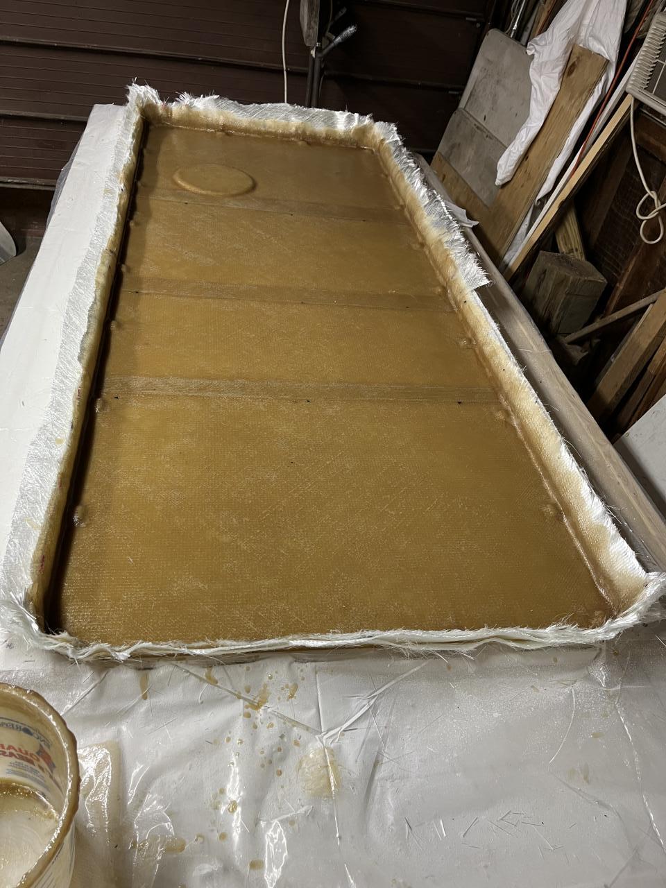

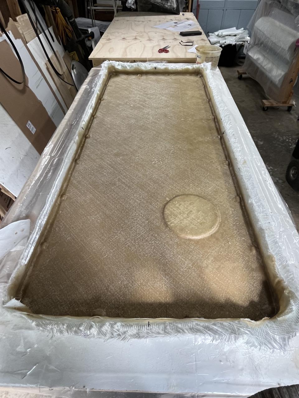

Gas tank cover is ready for Seacast. Below you see the before and after of the last layer. It’s 3/4 oz chopped, 1.5 oz chopped and 3 layers of 1708. I remembered something yesterday that i knew but forgot but wish I remembered for the transom… altering directions of the biaxial strands. 1708 strands run diagonal so in theory for maximum strength you should run each layer so the strands cross each other in an “x” pattern instead of always going the same way. That’s what I did here for the last layer thus the overlapping seams. I was also using up some of the piles of cut pieces I have as I want to make sure have enough glass to finish. So now the strands of the last layer run 90 degrees to the prior layer. Does it really matter? Is it going to crumble? I think not. But it would definitely maximize strength to run the strand orientation at 90 degrees to the prior layer.
The transom… wish I thought of it then but I’m not sure I would want seams in half of the 13 layers. My saving grace was that the 2408 stands run lengthwise on the roll while the 1708 run diagnal. So I am content knowing that I have a mixture of horizontal and 45 degree strand orientation on the outer transom. Does it really matter? Again not really. The inner transom 8 layers will be orienteering opposing.
