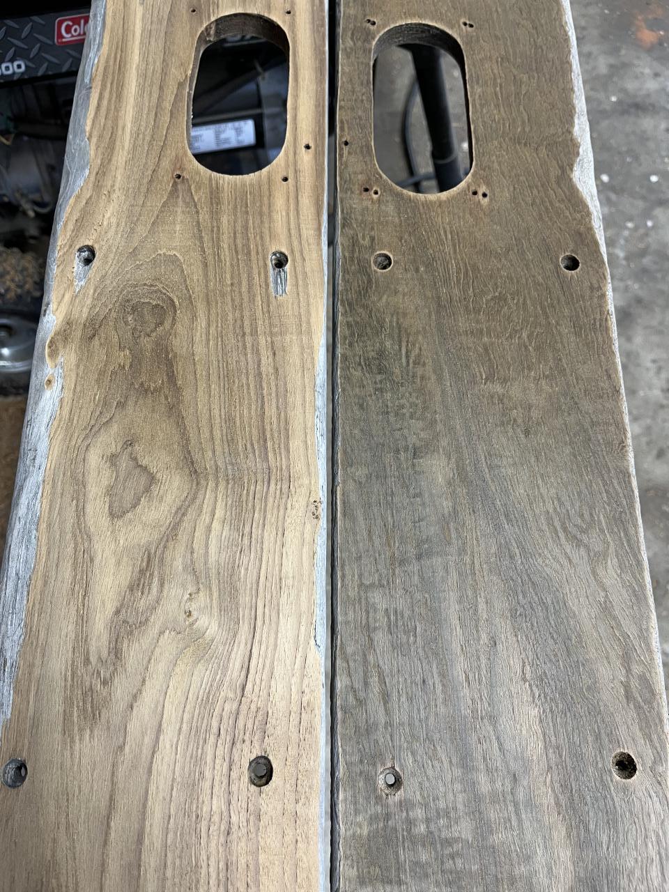

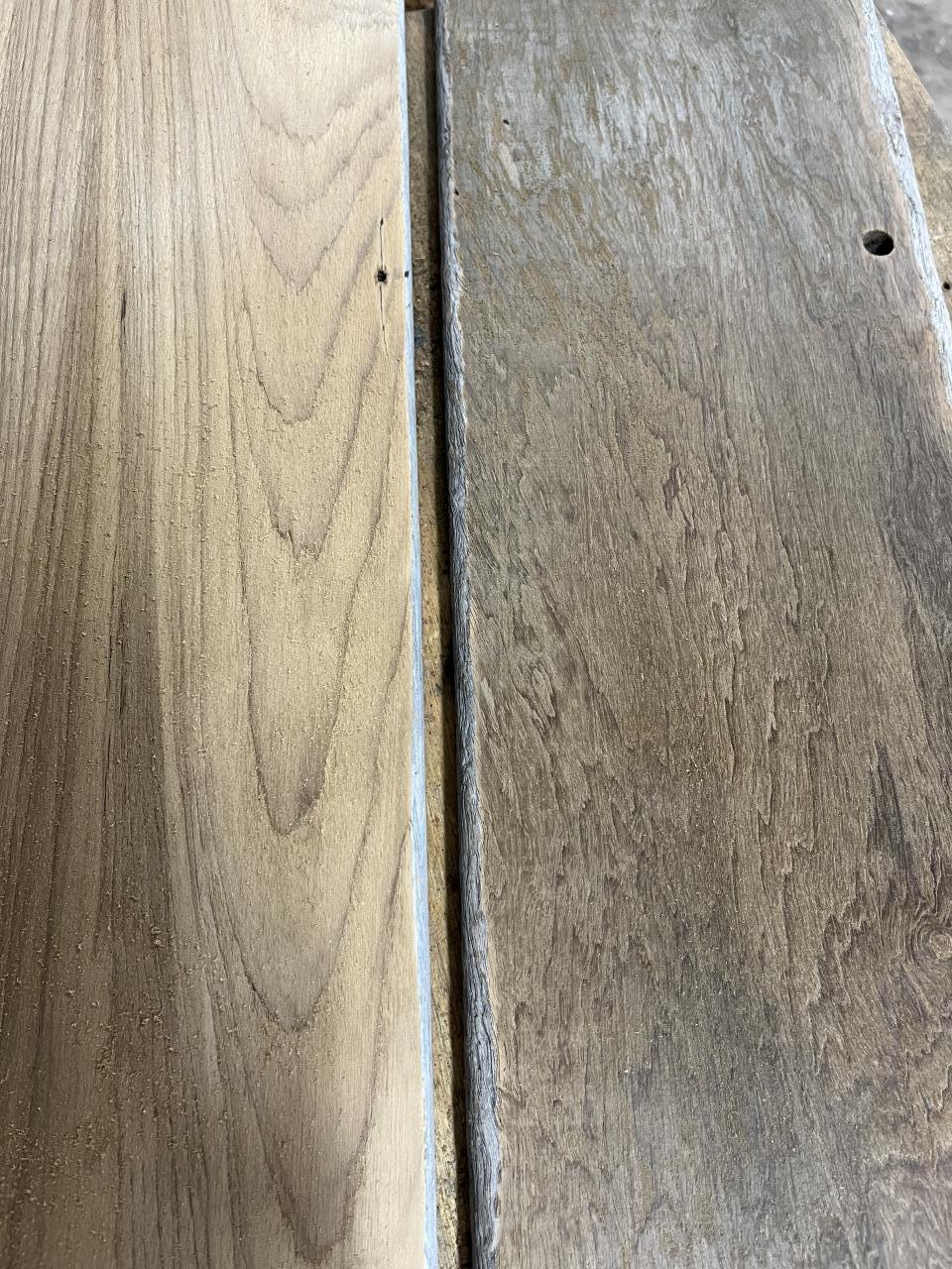

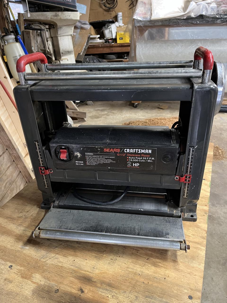

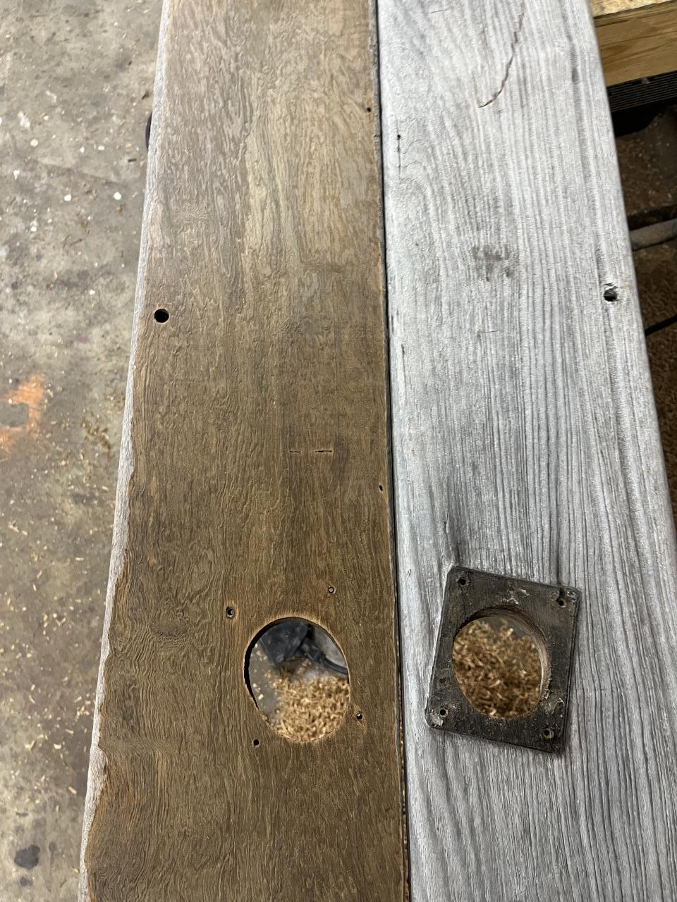

I’ve been thinking ahead about the teak work. I’ve been keeping my eye out on marketplace for affordable teak as I will not pay retail for it if I don’t have to. I have time. I bought one smaller piece of rough cut about 2”. I’ve also been keeping my eye out for a planer. Well one finally fell into my price range and I jumped on this heavy, overbuilt craftsman.
After playing with the set up and running some non teak through it my first thought was why did I not get one sooner!!!! You can sand for days and still not get the finish a few passes gives you. It’s amazing.

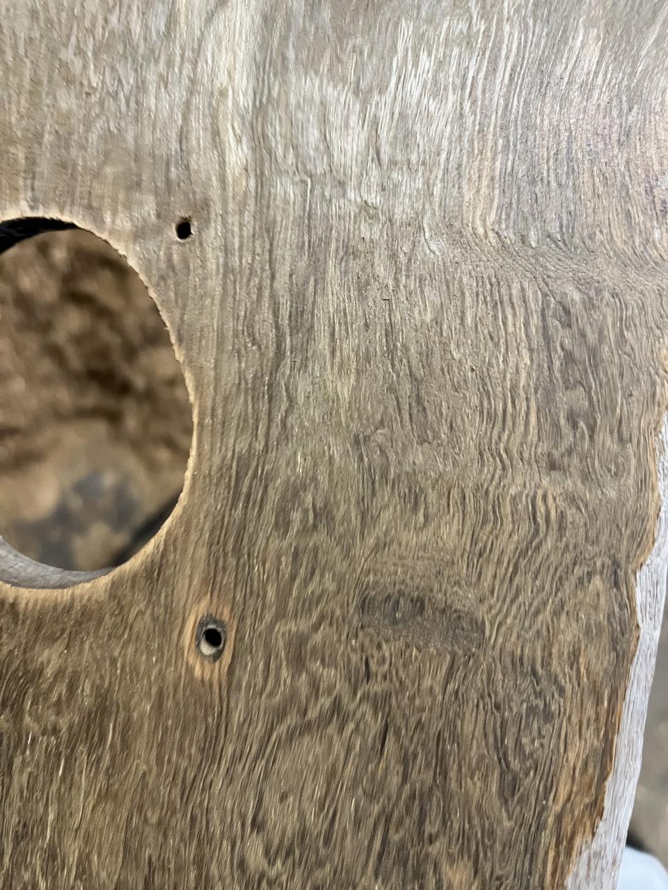

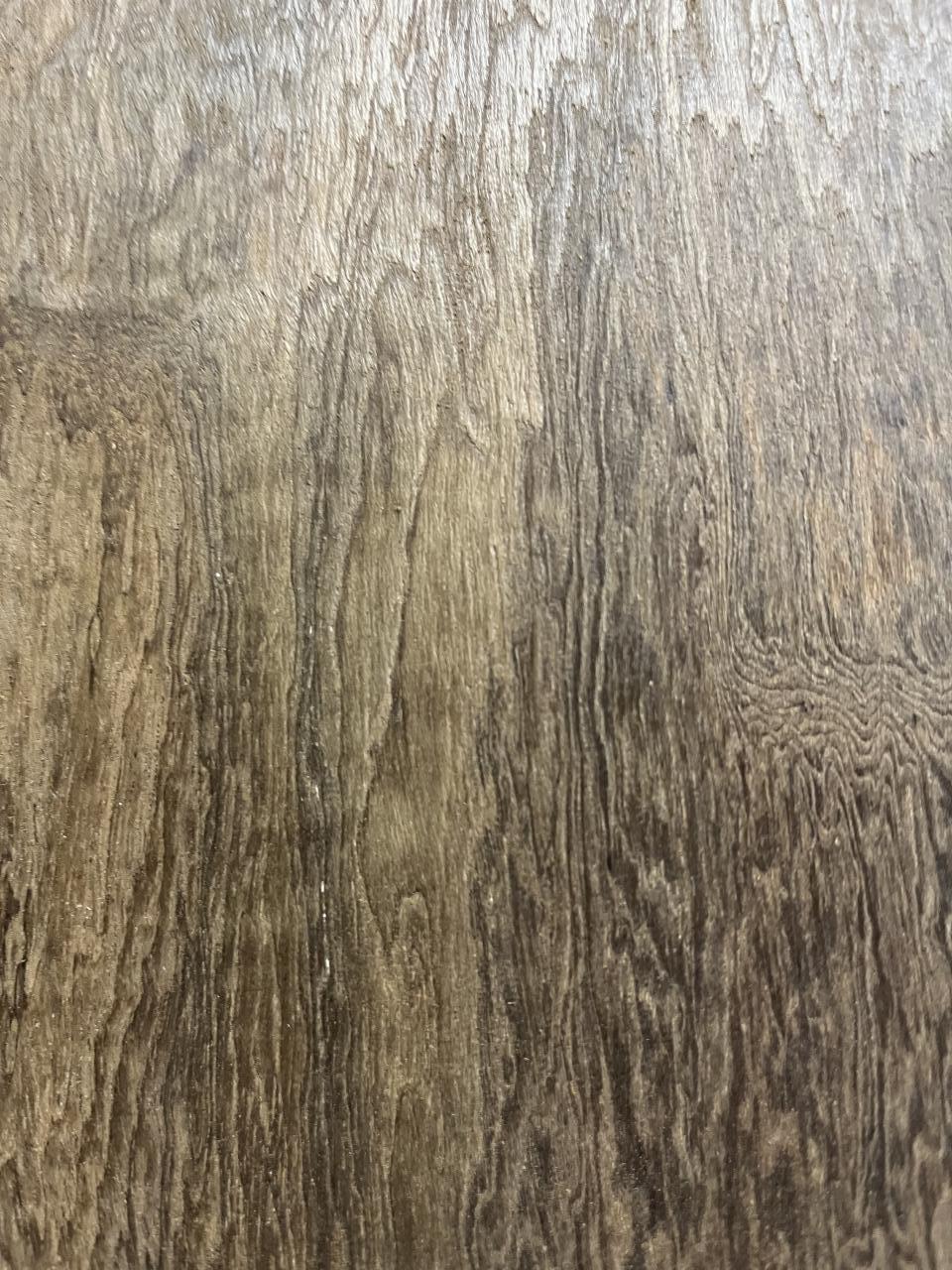

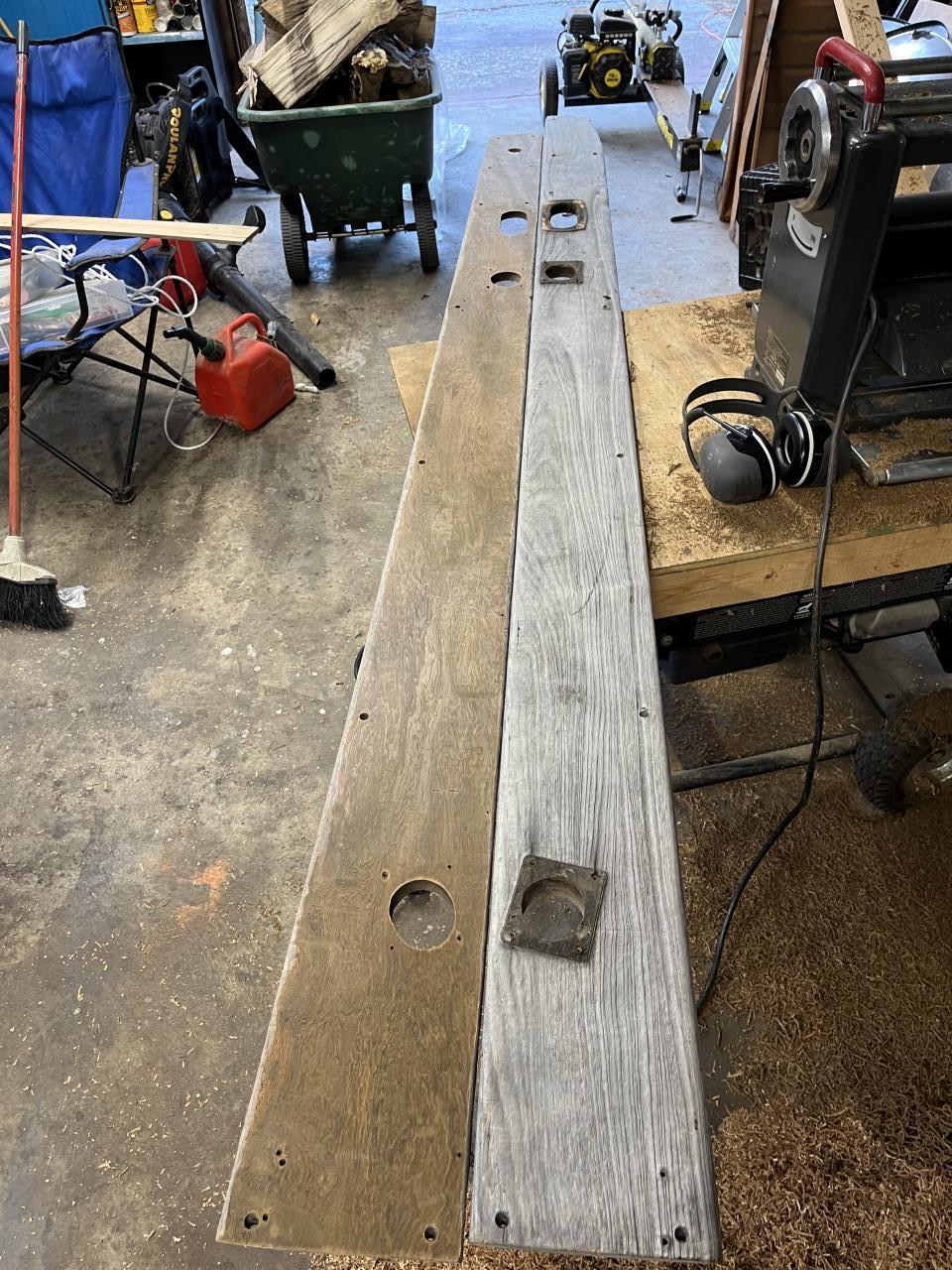

So with the minimalist of training and confidence I decided to go right for my most valuable pieces the Coming boards. I ran the starboard side and in complete awe and amazement could not believe my eyes at the beauty of the grain of this piece. I’ve never seen teak like this. The grain is almost
A burl. Must have been a core piece right off the trunk. The photos don’t do it justice. Here is starboard coming board after planing next to the port side before planing.
Well then I planed the port side. UGHHH WHY AQUASPORT WHY?????? The port side was not the same teak and was more of a standard look. So now they don’t match but oh well. The planer is an amazing tool that is going to produce some great teak for the boat both in factory reproductions and custom additions. Stay tuned.
