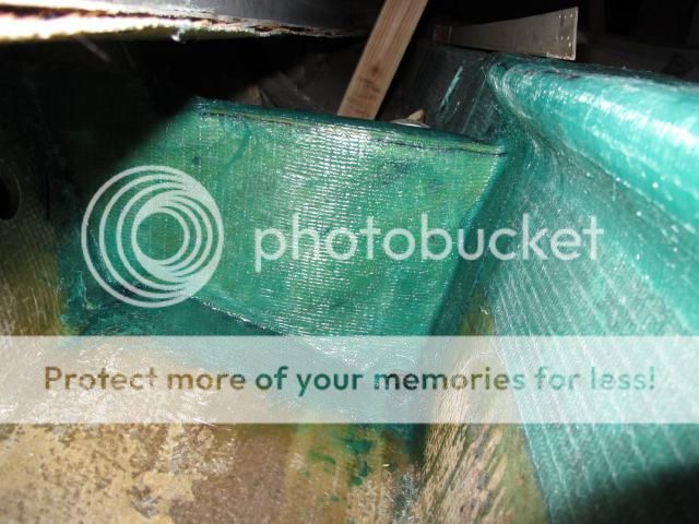

Thanks again Carl for the great tips. I did put ice in the bottom of one bucket and put my working bucket inside of it. It seemed to help a little. Thats also great advice to wet a part out on plastic sheeting. That could work great on smaller pieces. Its not like the working time has been too short. For the most part has been enough time especially with less than 1/2 gallon batches. The biaxial wets out super nice. When I switch to doing alot of chopped strand then I will have to chill it as it does not wet out as nice as biax. When it comes time to lay an almost 20 foot strip of biax then chopped strand for the floor top coat then I will ice the hell out of it to make sure I have enough time. Thats going to be the fun one. Everything else I should have enough time. Awesome advice thank you!
CLM, as for the foam. Its had to put timing on it, but yes, it would expand in the bucket. I was able to get about 3 quick quart mixes in the mix bucket (actually 2 quarts, a quart of a and b) before it was too crudded up to go forward. Then, after about 4-10 minutes, it would stop expanding, be soft and pliable, and more of a soft foam than a liquid, and it would then peel cleanly off the mixer and the bucket. If you wait a little longer the same would happen where it was soft enough to come off of all the plastic. If you try too soon it will smear and stick really good. If you wait an hour plus, or however long it takes to fully harden you may have to throw everything out. You can "roll" the plastic bucket and get the foam to release. Its amazing how incredibly sticky this crap is but it will flake clean off of plastic. You have to experiment with it and get the feel for when it will come off your tools clean. By the time you figure it out you will be finished! lol

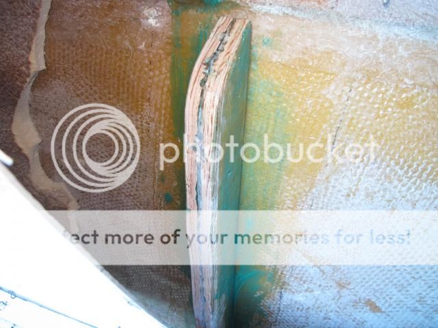

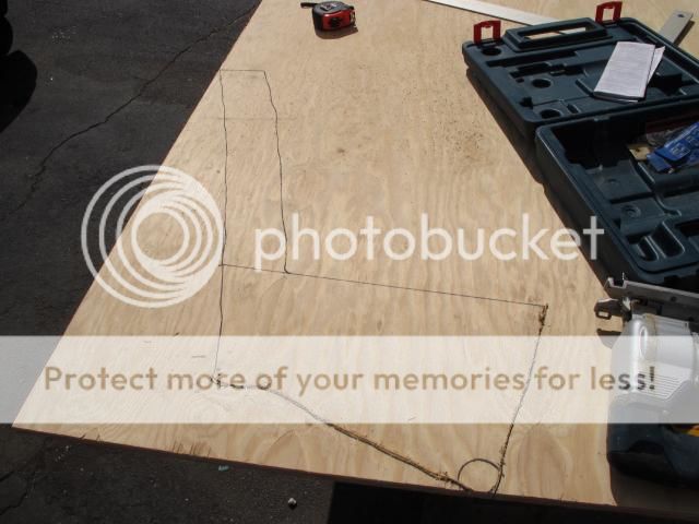

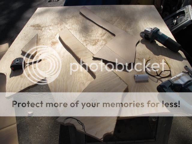

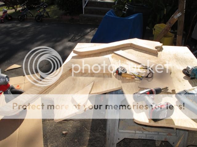

So today I started to tackle the mid boat bulkhead support that I want to add. I took a long look at how to make the piece and this is what I came up with to make the pattern. I drew a line where I want the support. I waxed the area a few coats with release wax. Then I took 6 inch wide piece of 1.5 oz chopped strand and wet it out. I laid it where I wanted it and worked a pinched ridge in the middle as a support. The plan is to let it harden, pop it off in a day or two and hopefully have a perfectly traceable profile that I can transfer to a piece of plywood for a perfect fit. I am further hopeful that I can use the same cutout for both sides. Hopefully I can get it off without destroying the  pattern.

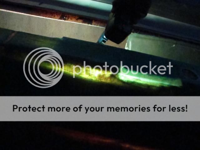

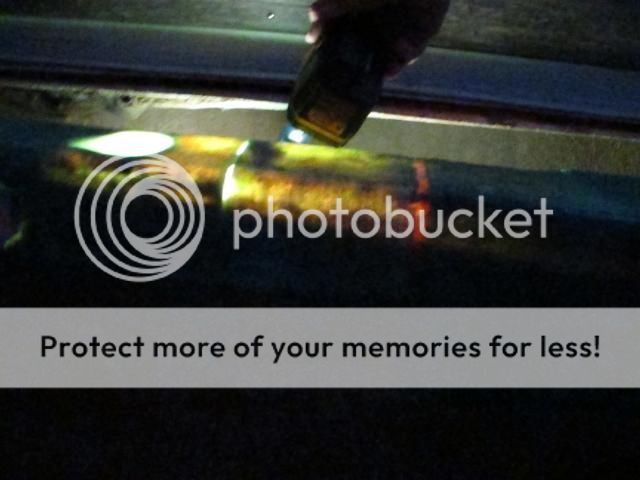

In addition. I made a cool discovery today as far as checking to see how well the foam spread. If you hold a light against the opposite side of the stringer it will shine through where there is no foam. Hopefully it will be all dark for you, but I have 2 spots that will need a small "drill and fill".

Quote from: "kaptainkoz"
That is good stuff right there. Thank you for that tip :!:  :idea:  :salut:

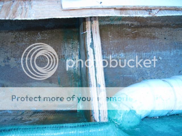

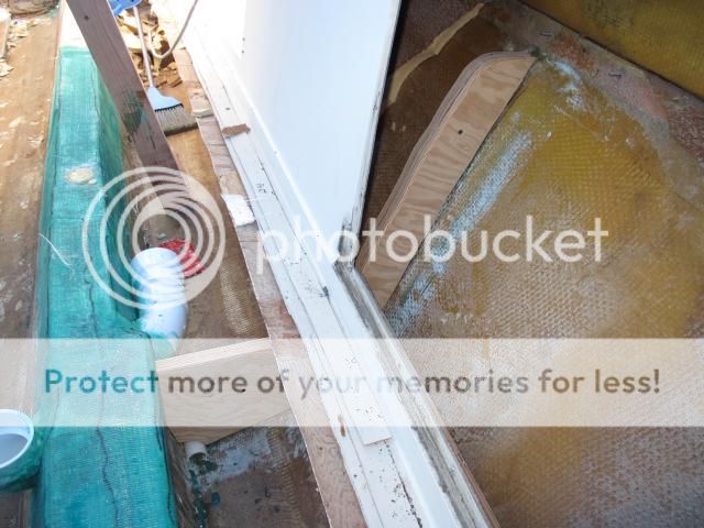

It worked PERFECTLY! I pretty much popped right out with just a spot or two needing a little help. More importantly this should raise the awareness to all as to how important it is to prep your surfaces. Who knows whats on your surfaces and as incredibly sticky resin is it was no match at all to the wax, and im sure grease, oil, etc. So anyway, here is the "pattern" as it came out of the hull:
I transfered it to plywood and cut the first one, then I dry fit it, made notes as to tweaks, and transferred those tweaks to the 2nd layer. I decided to go with 2 layers of 3/4 ply as it seemed like alot to ask from one layer. I made a half round cutout at the bottom for a piece of PVC to act as a gutter drain to let any water pass should any get in there.
I then tried the pattern on the starboard side and it fit a bit tight. So i transferred it to cardboard which was a little easier to tweak to shape. I was able to fit the starboard side without having to glass another pattern
I then dry fit the finished bulkhead blanks and screwed them together where they fit best. I then ran a rounding router edge bit over the edges that are not touching anything so I can wrap glass around it easier.
Tomorrow I will drill 2 alignment holes, un screw them from each other, glass a piece of 1.5 oz chopped strand between them, screw them back together, and resin the remaining surfaces and edges and let it set for a day. Then I wil install them completely encapsulating them and glassing them to the hull with biaxial.

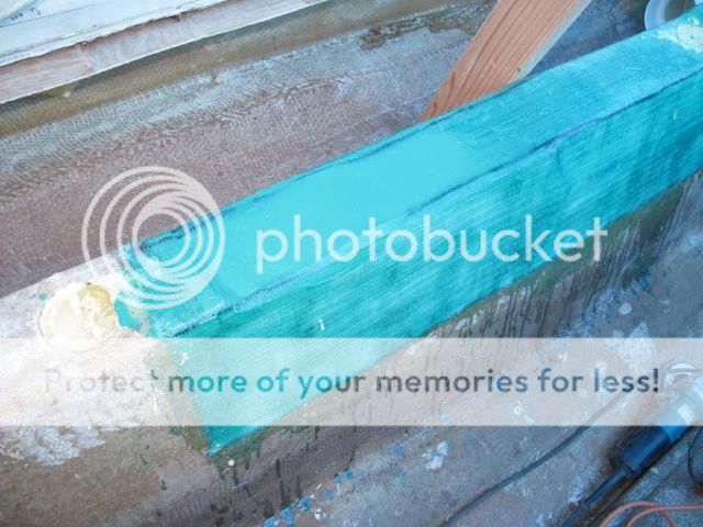

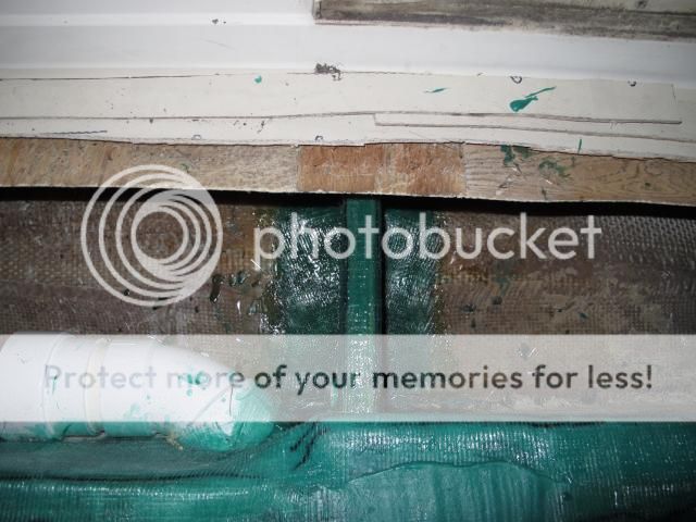

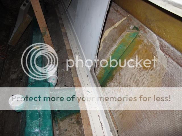

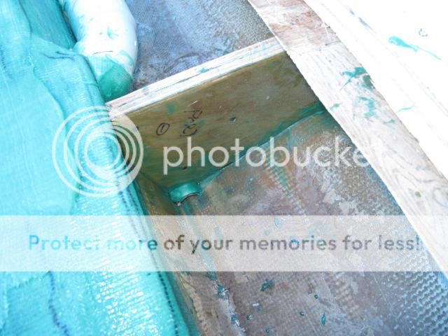

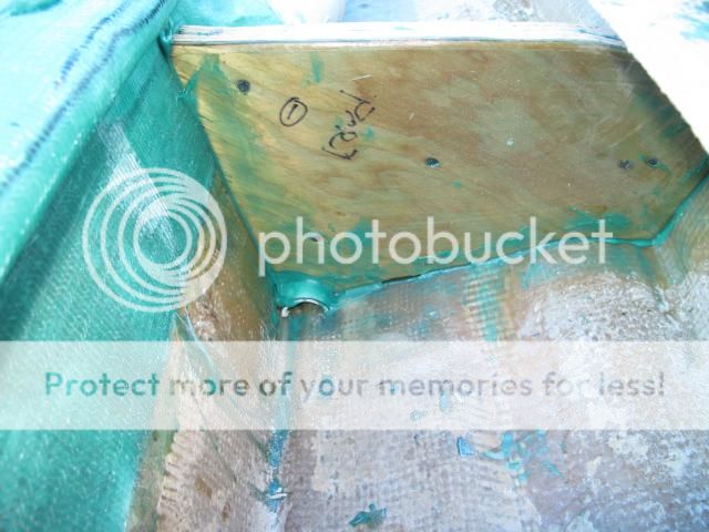

Fairly productive day, in fact more so than I thought it would be based on the possible complexity of getting these bulkheads in.
I took the 2 halves, glassed 1.5 oz chpped strand between them and screwed them together. I let them set up for a few hours. Then I mixed West systems 404 powder into some resin and made a paste. 404 is like cabosil except is is much harder, stronger and tougher to sand. It is a good structural filler and not a good fairing compound because it is tough to sand. I basically spread it over a marked line and set the bulkead into it and cleaned up the edges. It looks messy and it is a bit as the pictures do not do justice to how odd of a space this was to work in. It will glass just fine. I also think it was a wise move and worth the effort. The play and movement that the gunnels have was very obvious when I had the bulkheads dry fit in place and I tried to move the gunwale in and out. There was movment enough to justify my actions.
So it wouldnt go to waste, I used the remaining mixture to fair out the tops of the stringers a bit.
Then I glassed both the port and starboard lower halves. Tomorrow I will glass the upper halves.

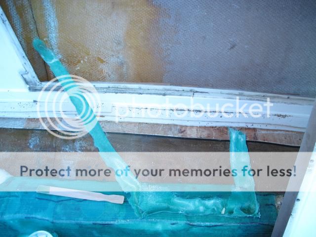

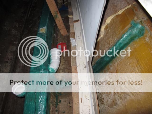

September 17, 2013, 11:31:53 PM
Reply #134
  • Posts: 691

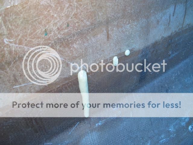

« Reply #134 on: September 17, 2013, 11:31:53 PM »
Here is a phot I promised about something I mentioned earlier when I was pouring foam.  These foam dribbles actually bled through the fiberglass. They are not spills.
