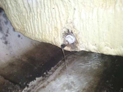

After getting my fat head in the small doors next to the live bait well and my big arms through the pie plate in the stern walk through, I was able to finally find the thru hull for pumping out the fish box located high on the port side near the stern.  There is a hose connected to it with a plug clamped in the other end of it.  Apparently the original owner before the PO must have removed the pump (since the PO claims no knowledge of it).  I can't see anywhere that another pump was mounted and can only find one set of wires with a plug on them that is not connected to anything.  I have to believe these are the wires for the missing pump.  Apparently the wires were in the water at some point because when I checked the power distribution panel, the fuse and switch for this pump is burned completely out (actually broken apart.  I've attached a picture of the fish box drain and the wires are located to the left and below it out of sight.
My questions now are:
1- What pump would be best for this application?
2- Where was it mounted?
3- What amp breaker should be used with this pump?
And, if someone has a boat similiar to mine and has a picture that shows the mounting and connections to the pump, it sure would help.

The fishbox pump was originally a johnson livewell pump, I would go with a good Shur-flo or Rulw livewell pump with a long threaded stem.  This will fit through the hole at the base of your fishbox, with a backing nut on either side.  Not fun to get to the backside, but it is what it is.  Position the stem of the pump about halfway into the hole, tighten up both backing nuts, cut off the stem on the inside of the box, leaving enough to thread on a strainer screen.  That was the original configuration, just a different brand of pump.  Then reconnect the hose that is already laying in the bilge.
Now, the wiring for that pump comes from the helm, except the ground wire, which is terminated to the ground bus on the inner transom wall.  It will be brown with a colored stripe.  Turn on the "Fishbox Pumpout" switch at the helm, then test for voltage on any loose, brown wires in the bilge.  The one with voltage is the one you need to terminate to the pump positive...
