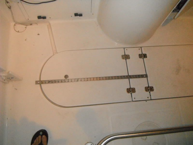

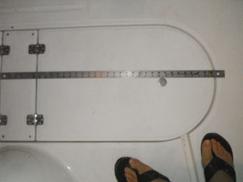

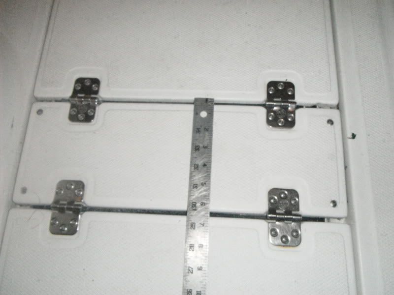

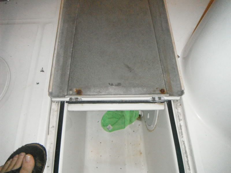

Marc,here are my lid pics,,the center section is about 5-3/4",each hatch is 28" on the centerline,the hatch is held in place by the 4 screws in the center section to remove hatch I just remove the 4 screws,let me know if you need more detailed specs..
notice that the center section also has a lip that extends under the hatch for support
 :salut:

Thanks Pete, that underside pic is what I wanted to see especially, if I make mine into a folding cover, I will probably eliminate the middle piece and just go with a piano hinge, If I made the middle section, it would involve twice as much glass work because each side of the middle section would require the bracing pieces also.  Thanks again

You guys might wonder why the underside of Pete's lids are green.  No, it's not from mildew, they are made using the VEC process, http://www.compositesworld.com/articles ... d-painting, whereas Scott and Marc's lids are laid up in the traditional manner...
Just a little tidbit of info...
