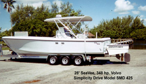

or you could give my neighbor all of your money.  He is selling a ton of these to the Costa Rica government for river and coastal patrol boats.
http://www.simplicity-marine.com/smd1.htm
Jackshaft application
Actually I would not let him do anything for me.  He is a major butthead and if one checks the online court records he apparently never pays his bills.  Tons of lawsuits.  I only mentioned it because I think it's an interesting concept for an inboard that will run fairly shallow.
