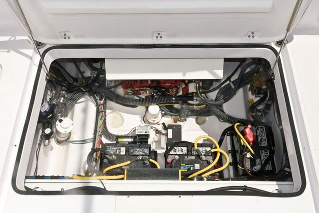

Here is what I did, drilled a hole in the aft area of the bottom of the box, installed a brass sleeve for a garboard drain plug using silicone.  When the boat is sitting on the trailer at the house, I just leave the plug out and rainwater drains out into the bilge and out the hull's garboard drain.  As far as accessing the pump, if you remove the frame of the access cover on the starboard side where your washdown, batteries etc.. are, it will give you a bigger hole to jamb yourself into.  BTW, mine is just a rule small bilge pump.  Not easy... but doable.

I too thought that removal of the batteries would help accesss. looks like i will live with bailing the box until season's end Drilling the box is not an option as the boat is sliped for the season

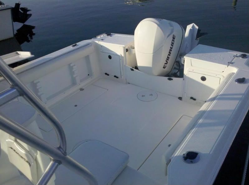

i got the same problem, my macerator pump stopped working that pumps out the 2 fish boxes in the deck. My pump is located in the bilge and the only way to access it is through the circular deck hatch that's only 8 in wide, which means to replace the pump all work has to be done one handed since i cant get both arms into the hole at once. very frustrating right now im self bailing the two bait wells.

Have you ever thought of cutting a bigger hole in the deck and installing a real hatch that you can work through?  I'm sure there's room between the stringers for, like, and 11 X 14 or so...

bob i have thought of that but wondered what it would do to the strength of the deck
here is a pic that kinda shows the hole that i have to work through

And the pump is located way back even with the middle of right hatch if your looking at the stern of the boat so its not like the pump is right straight down from the hole.

Miky,
You ought to try it thru a 6" pie!
Your deck will be fine with a hatch.  BTW, I thought you were selling your little girl...

thanks for the advice Bob, i think i will make that a winter project.
