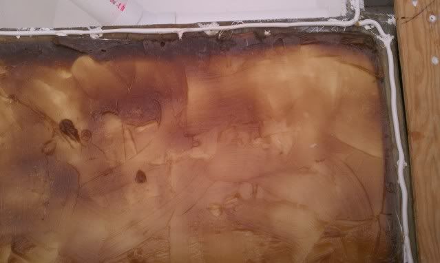

6 tubes of 5200, 5 gallons of resin/ cabosil putty and 75+/- #12 stainless 2 1/2 flatheads and the deck is installed. Basically all I did was put a nice layer of putty on the closed cell foam, then made a glob in the middle of the section, 5200 a 3/8" bead on top of stringers and bulkheads then set the deck and squished everything down. Then added the SS screws and filled in all small gaps around the edges. I also filled all screw head valleys with putty. Andddd that is about the time I had to get out of there because I kicked the resin a little much and thought my shoes were going to catch fire the deck was getting so hot. Next weekend 100%, deck and console gets glassed in!

February 21, 2011, 08:04:27 PM

Quote from: "dirtwheelsfl"
whats all the putty for exactly?
Main purpose is to assure the deck is secured to the closed cell foam under it. Second is to make sure that the closed cell foam is sealed and even if water were to get under the deck that nothing would happen to it. Needed something to bond the deck to the closed cell foam.
