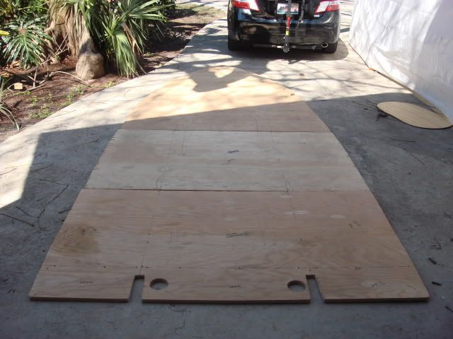

Made some progress on the boat but not enough to install the floor like I thought I would. A ton a loose ends I needed to tie up before the big step. See pics and notes below:

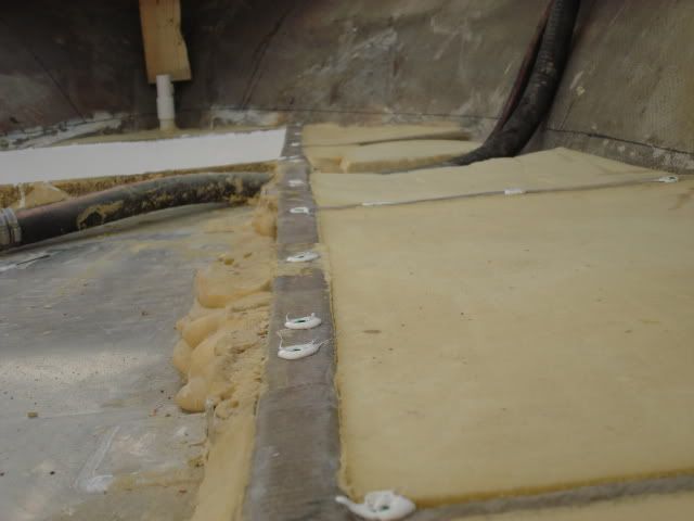

Had the floor in the boat where I drilled holes into the deck and into the tops of the stringers, then countersunk the screw heads. Since the core of the stringers is a composite, there is not really much grab so plugs were used. I know this is overkill but I don't want this thing to move.
Plugs used to plug holes, 5200 was used in each hole to secure the plugs, needs 7 days to dry hard, then #14 Flathead stainless will go into each hole.

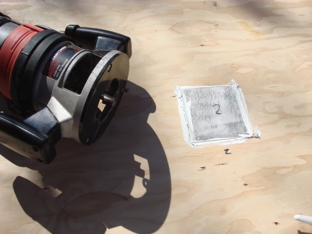

I routed the backside of the deck to 5/16" and installed plates for under the tower posts to drill into. These were also 5200ed in the backside of the floor for beef. I don't trust just a large screw and 5200 into the deck. I figured if the tower wants to try to rip out of the deck, its going to need to pull out a 5" x 5" piece of 1/4" thick solid aluminum.

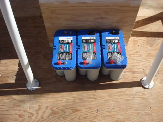

Double checking battery positions and placement. I am trying to keep all weight forward/ centered of the boat.

Fixed the seacock and plumbing to allow straight flow into the 1600 gph baitwell pump. I could not have it straight up because it hit the floor so I did a 90 degree on it. Plenty of clearance now.

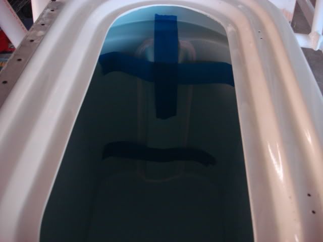

I added a few layers of 1 1/2 oz mat to the bottom of the livewell, seemed to me to be a little thin. Then I also added a 1 1/2" drain on the bottom for quick drainage. I also took the side piece off and installed a 1 1/8" inlet valve to replace the 3/4" that was originally installed so I can have straight flow 1 1/8" for maximum water. Now I don't need to reduce it at any point. The overflow tube and the drain tube will connect with a Tee barbed fitting 1 1/2" sanitation hose will be used to assure I wont be doing this ever again.
I also added a front compartment and seat to the center console to be able to get all 6 batteries under it while having plenty of dry storage under the console.

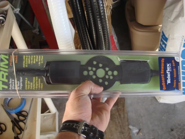

Just received yesterday the trim for motor and porta bracket turn signals that will go up on each station, so nice having this stuff at your finger tips!
