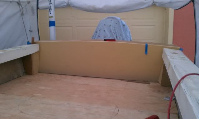

Today I cut all of the flooring glass and numbered all pieces. I am running with 8" mat tabs and 8" 1708 tab around the deck to hull. Then a 50" layer of 1 1/2 oz mat from left to right with a 6" overlap in each section going up both sides. Follow that with a 50" layer 1708 left to right and up the sides with an offset overlap for strength.
I also go the back transom piece cut out of composite and the front compartment cut out as well. Started to make the supports for the sides also. This weekend was a lot of prep work,next weekend will be the big one with glassing the floor down!
