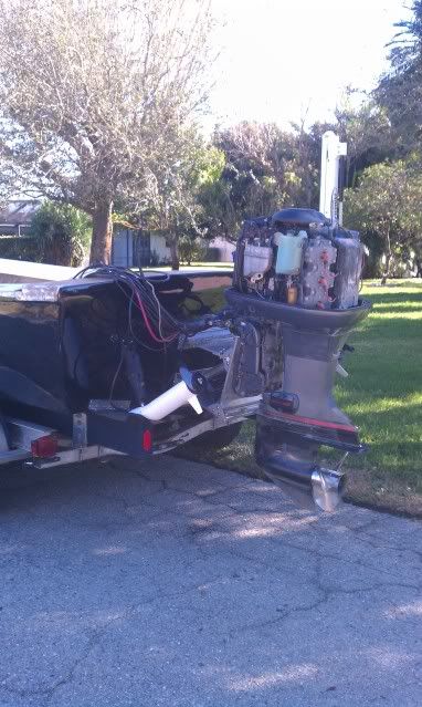

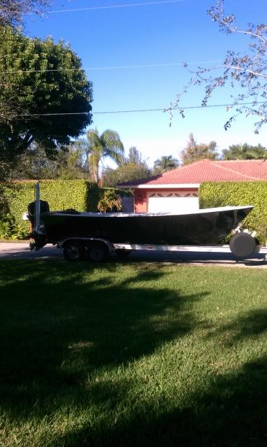

Took it out of the tent and mounted the motor. Side profile
Close up of motor mount

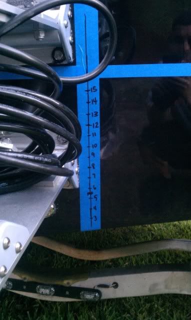

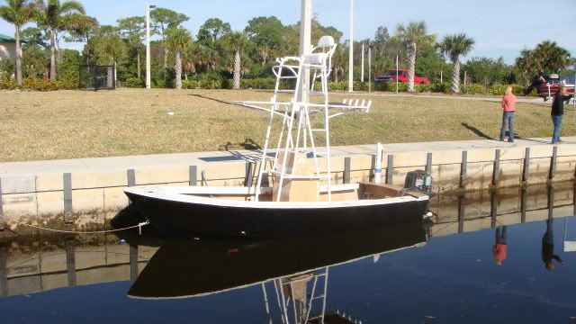

I am going to float the boat tomorrow so I did a perfectly level line with blue tape horizontally, this way once in the water I can use a tape measure and make sure the lines will be equal to each other. If they are not I know which side to add weight and check again until perfect. I also filled her up with 46 gallons of fuel today. It holds 65 but I figured running with 45 will be more accurate, I don;t know if I will ever run a full tank unless i'm grouper fishing. Also made a gauge vertically and numbered the amount of inches so I know approx what this boat floats at rest.

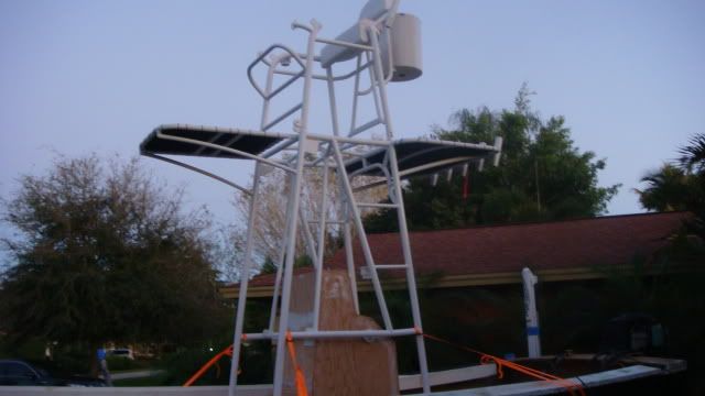

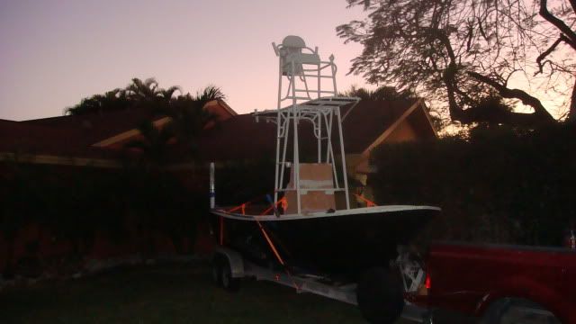

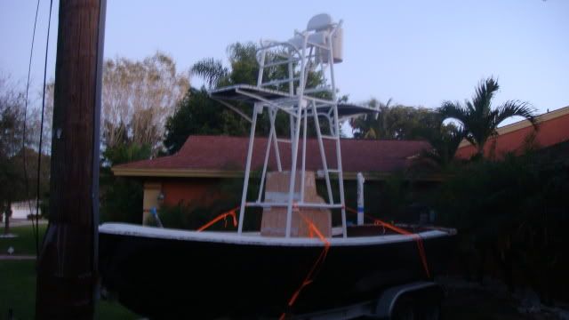

Tower is in boat and ratchet strapped down for the test float tomorrow.

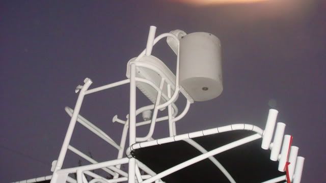

This is the 2nd station of the tower. Note the 15 gallon live well on the second station. No need to run down and get bait anymore!

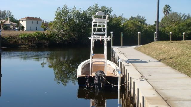

Thanks guys for the support!

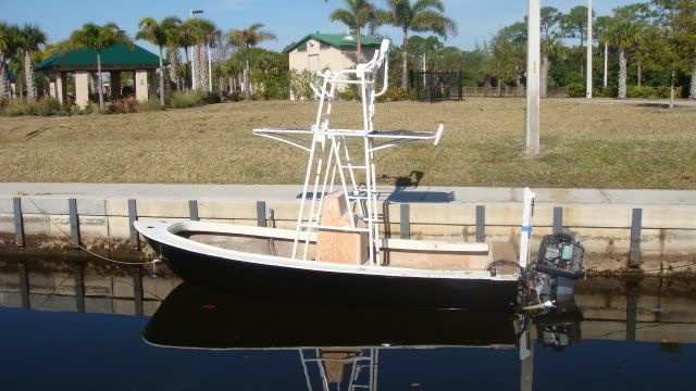

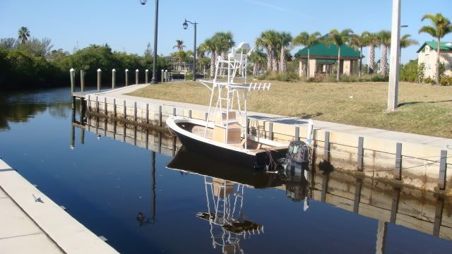

Would you believe it? She floats!
On the first shot she was perfect, even weight distribution and after checking the measurements against my blue tape for the left and right lean, they were within 1/4" of each other. The boat was also drafting just at 12" with 45 gallons of fuel, tower and center console in place. The only thing that I am going to do is build a box/seat in the front of my center console so I can add batteries inside there to move more weight forward. I got in the boat 240 lbs, my dad got in 220 lbs, and my mom got in at 115 lbs. My dad was directly behind the center console as if he was driving, I was standing behind him as if I were the livewell and my mom stood in front of the center console acting as 3 batteries and the boat still was 12" at rest. Without her up front the ass end was dipping into the 14" draft range which was too much. My goal now is to put as much stuff(batteries, electronics, etc) either at center or forward to keep the level perfect. All in all a successful day and it really made me happy to see her on the water!

I'm not very experienced with towers that have livewells. I've never seen one but I'm sure they exist. My thoughts on that are.......
It will add additional weight well above the center of gravity which will already be "elevated" when you are up there. By your own admittance, you ain't no 90 pound weakling. :shock:  Couple that with water and bait conveyance and it seems to be overkill (except maybe when you're all alone) to me. Though passing bait up would seem to be easier with two fishermen.
If you're going to fight the fish from up there, I'll assume someone below will bring it aboard, unhook and place it in cooler. Why not just have them bait the hook while you have the line on the deck? :idea:
I'm just thinking out loud.
January 30, 2011, 08:37:20 PM
Reply #222
Re: 1973 Aquasport 19-6 Rebuild
« Reply #222 on: January 30, 2011, 08:37:20 PM »
CB,
Good point regarding the upper-station weight.
My limited understanding of beach-fishing "Tampa style" tarpon boats is that you cruise along the beach on a nice day, up in the tower, and look for tarpon. Its sight fishing, pitching baits in front of the single or pack, much like bonefishing.
So if you're alone (and nutts, PLEASE don't fish alone, I can tell you of innumerable bad situations that can/have occurred to myself and others) you have the ability to quickly chunk a livey. From what I hear, they move fast, and you have a short, quick window.
But guess mostly you have an opportunity to throw a fast back-up bait behind the guys in the cockpit that went first.
You can limit the weight by limiting the water with different height drains...that is, ten gallons to support a couple baits would be better, particularly if its a little rough...but then again if its rough, you probably wouldn't be sight fishing....
Anyhow, what a cool boat!
