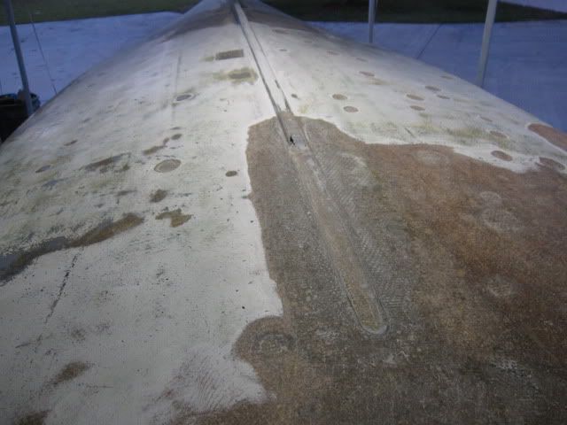

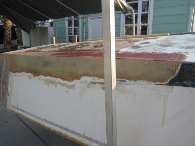

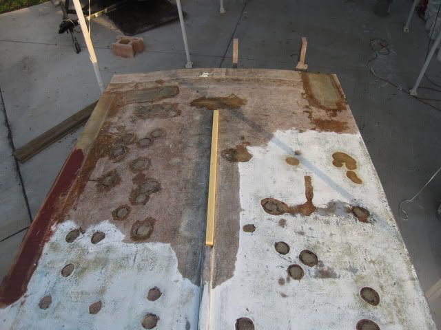

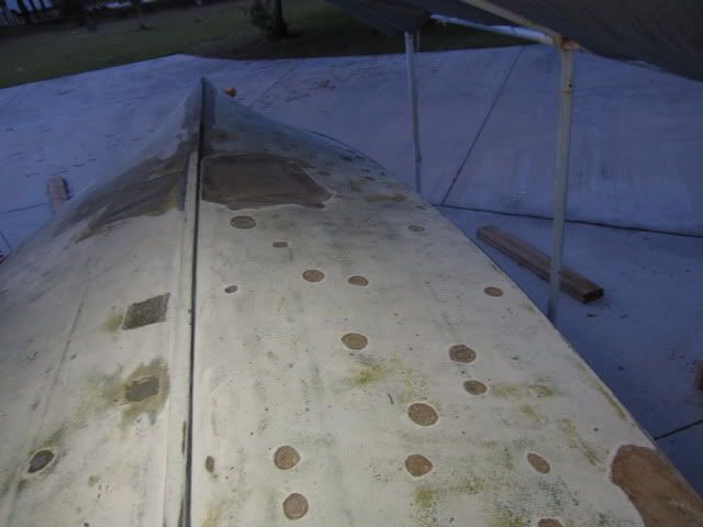

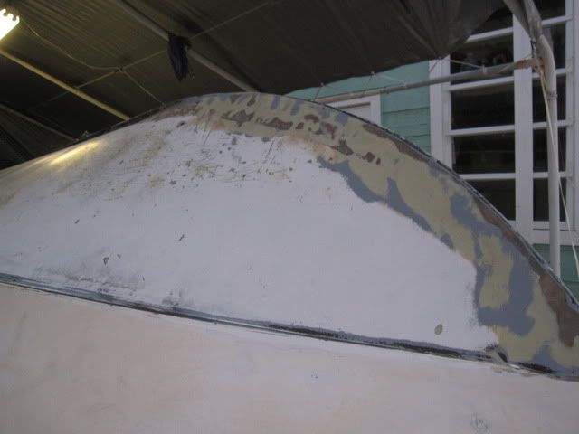

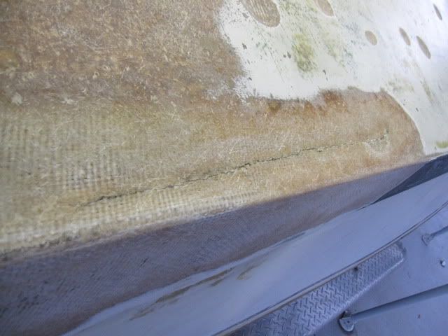

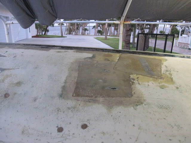

transom wrapped
before filling: bottom is not that bad really.... the last 5 feet or so had an s shape to it fore and aft, got the high spots grinded down now just need to fill
nice split. already have3 layers of 1708 on the inside of this
lots of shotty patchwork to be ground out
stem already has been worked on, and is surprisingly solid.
keel is a mess, had about a 3/4" curve to it the last couple feet, real wavy up past the windows too. going to take the stroke sander all the way down it . and replace that section with come corecell

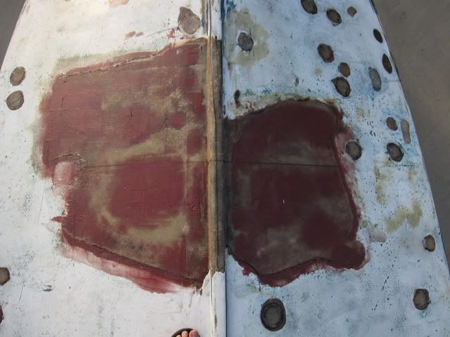

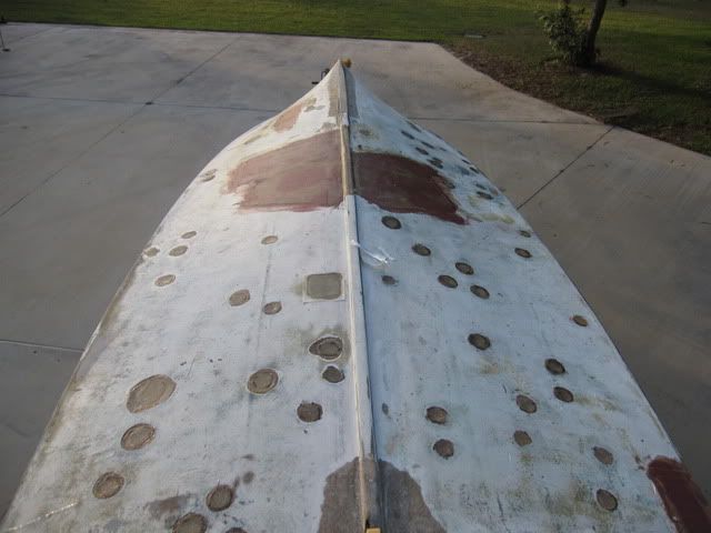

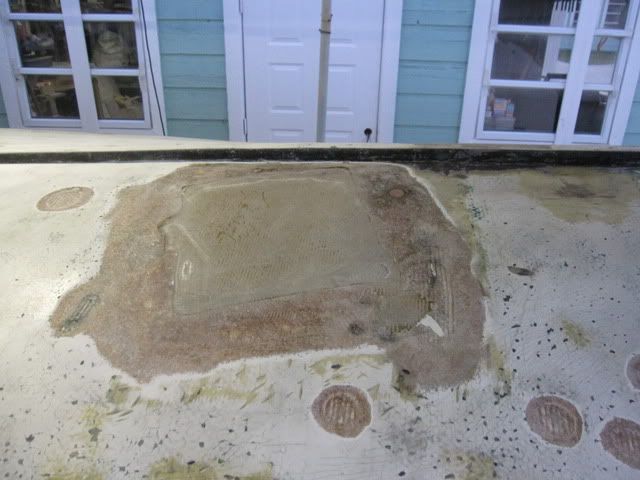

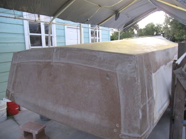

well rich i managed to get ahold of a perfect piece of corecell to do that with, its about 18" past the original. looks about right now that im looking at it.. probably gonna throw the vacuum to it when i laminate it.
this area had a split and delam on the chine/hullside. 2 layers of 1708.
first round of filling blisters next will be fairing compound
windows. all wet on wet...
