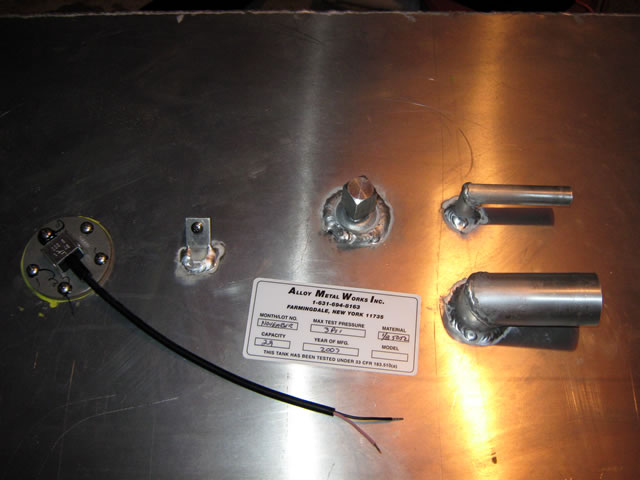

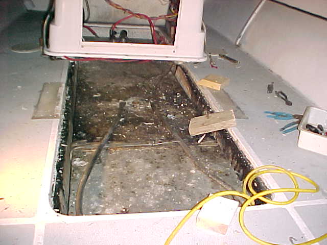

Recently bought this boat, previous owner said he smelled gas, pumped out tank and switched to a 6 gal portable.

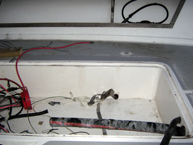

I have the console off, the coffin lid up... found a badly corroded 29 gal aluminum tank in her. Had hundreds of 1/16" to 1/8" holes, only in the top though.
Went to Alloy Metal Works Inc., in Farmingdale, NY this morning, met with Phil, he's going to build me a new tank (in about a week).
QUESTION: I've read that I should adhere fibre reinforced plastic strips on the bottom with 3M 5200 adhesive --- where can I get such strips? What might be a suitable substitute? If I use the method described here: http://www.yachtsurvey.com/fueltank.htm --- should I use the stainless steel straps that are in there now to hold the tank down? I don't want to if I don't have to... the less touching/ rubbing against the tank, the better IMHO.

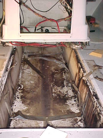

Thanks Fission!  I actually found your pics and studied them before I started.  I have been working at it for a few days and it's going fairly well.  I got the tank out in a good 8 hour day.  Lots and lots of utility knife work.  When I got the hatch off, the basin and tank were completely covered in wet black slime.  I did lots of scrubbing, scraping and washing and got everything pretty well cleaned up.  The tank is in pretty good shape, except for a few pits in the area where the tie down straps were.  Bottom corners were the worst, but really not that bad.

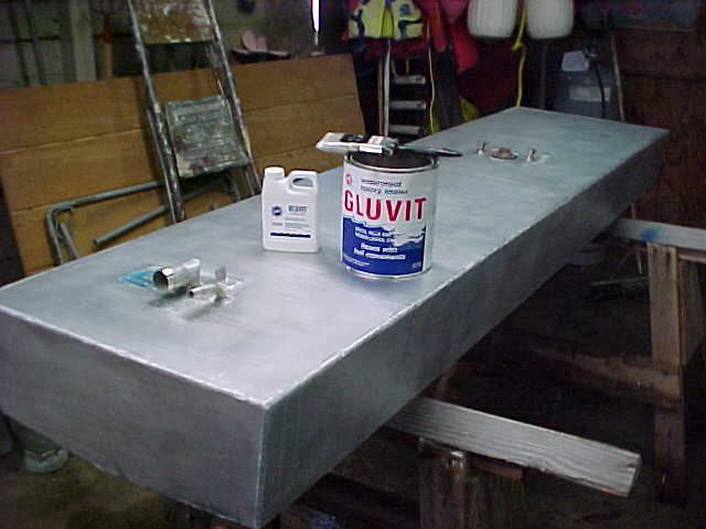

2) Coat the tank with Gluv-it.  This is a two part epoxy coating made by Marine Tex that is made for coating aluminum.  It claims to be made to penetrate, seal and stop corrosion.

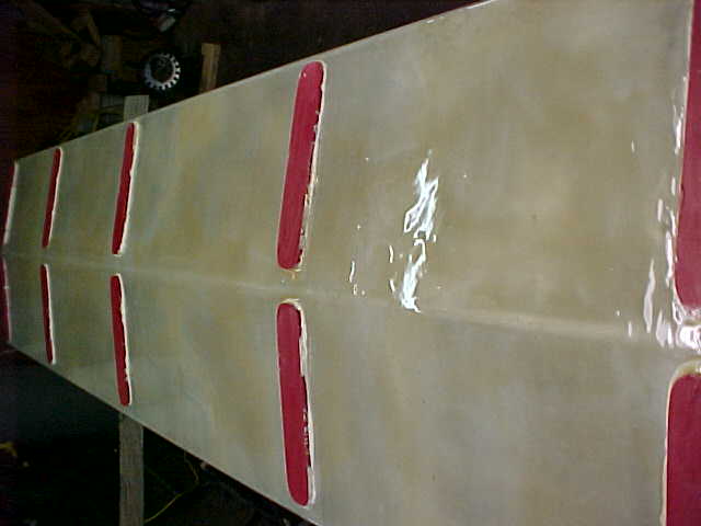

Taking a crack at posting pics.  There should be three:

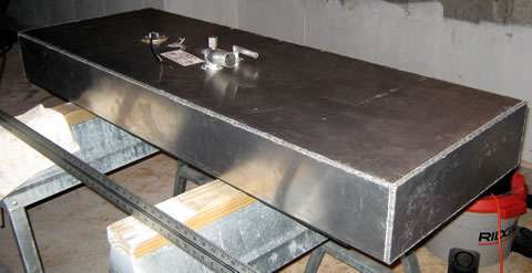

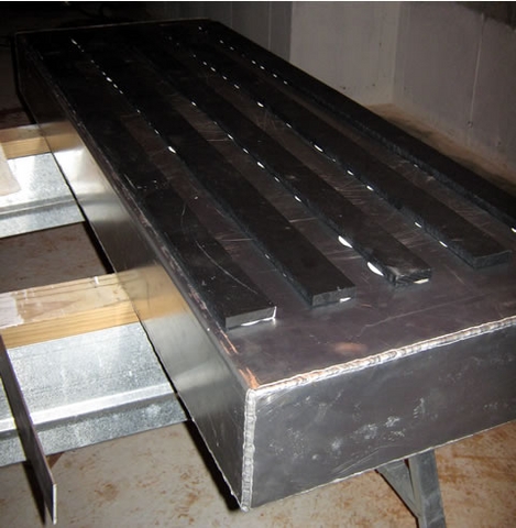

Sorry it took so long to get back to you... I pulled up and tilted back the console (mine has a hard-top bimini), quite heavy. I bought the new tank from Phil R., bought a sheet of Starboard, cut it into strips and applied with 5200.
While doing this I noticed the wiring was old and nasty, really done poorly; wirenuts, electrical tape peeling off splices, wires severly nicked and left that way... only one gauge worked, etc. So I am labeling / ripping out all wiring and redoing it proper --- only thing is I'm not an electrician, so doing the best I can, I created a new wiring diagram in Visio to help.

« Reply #12 on: April 22, 2008, 10:35:41 PM »
Pictures *finally* posted  :)
I attached them up top to my original post.

Then, I dried off the tank and glued FRP strips on the bottom with 5200.  I ran the plastic strip starboard to port, rather than fore to aft.  This enabled me to place the strips under the tank baffles for more support.  I left room for water to drain down the middle and around the edges if necessary.  My tank has an angled bottom, matching the deadrise angle of the hull for more capacity.
Then, I coated the tank with two coats of Glu-Vit epoxy by marine tex.  It seemed to do a great job penetrating the few pits I had in the tank.  I am very confident that the tank will last for another 20 years.
After the epoxy cured, I ran 5200 along the bottom of the FRP strips, dropped the tank into the coffin box and connected the new hoses.  I then filled the tank up 3/4 to check for leaks and to get some weight on that 5200 to bond the tank in place.  New sender, wires and clamps and I put the lid back on.  I didn't use any hold down straps of any kind.  I'm confident that that tank won't go anywhere- that 5200 is pretty strong stuff.
Ooo, now you got me thinking... on a new tank such as mine, would there be much advantage in coating my tank in Gluvit? I tend to lean towards overkill regarding details in my work... if it might make the tank last any longer... I might just do it.  :)
