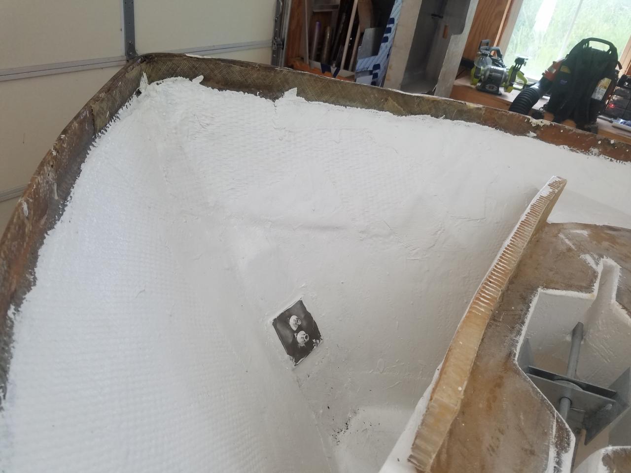

I suspect all the "small" things like bow eyes, hinges, etc.end up taking forever. The bow is dry fitted. I had some aluminum squares and hammered one to fit the front. Plan is to put a healthy amount of 5200 under each aluminum plate and put self locking nylon nuts on it. Is that a reasonable way?

Looks good - but - stainless and aluminum don't play well together in a saltwater environment, noble metal stuff. Aluminum will eventually turn to a white powder unless you can separate contact between the two. I wouldn't do it.
I'd replace the aluminum on the inside of the hull with a few layers of glass. On the outside, since thats not going to see much force against it, could probably just rely on the stainless plate that comes with the bow eye like the factory did it.

Dbiscayne, thank you. I knew aluminum and bronze hated each other but was unaware aluminum and stainless did as well. Saved me. I was literally 20 minutes from installing with 5200 etc. Would have been a real mess. Well ..... poop.

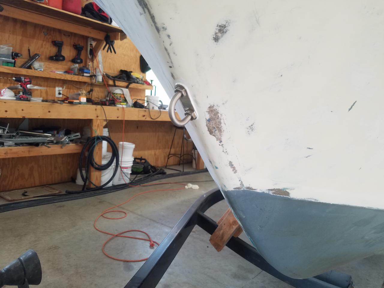

Got a beefier bow eye and a piece of stainless plate, 3/8 maybe, as a backer. Put 5200 in the places it should be. I think the next move is put the cap back on. All those bolts makes my head hurt. Am i supposed to put a beed of cAulk or 4200 around the whole thing? I can't remember what all I scraped off.

much better

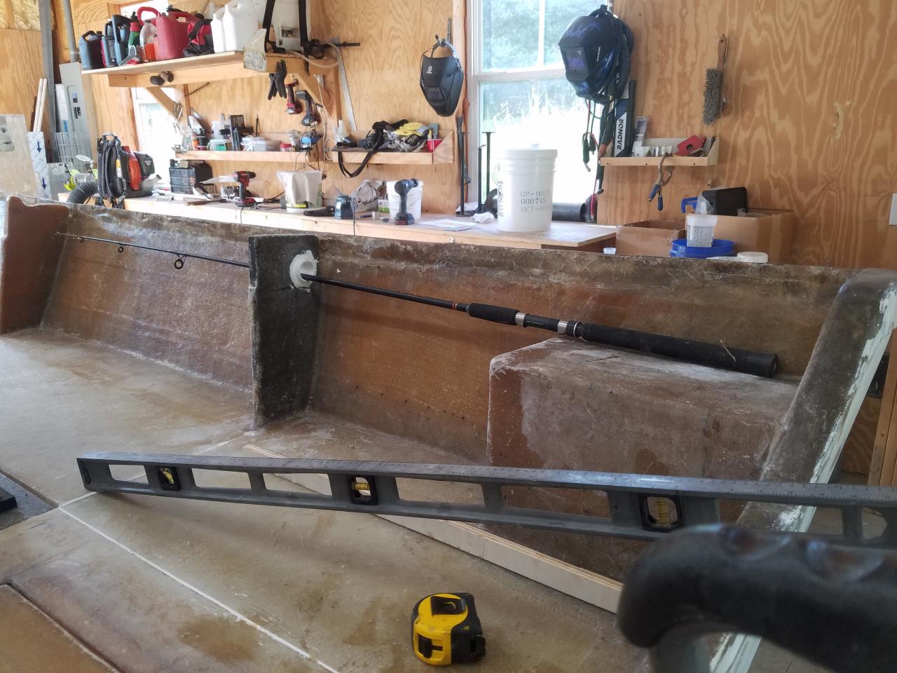

Rod / scrub brush / gaff holder and leaning post contemplation.

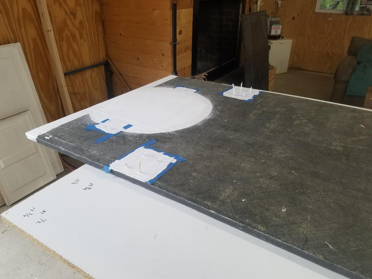

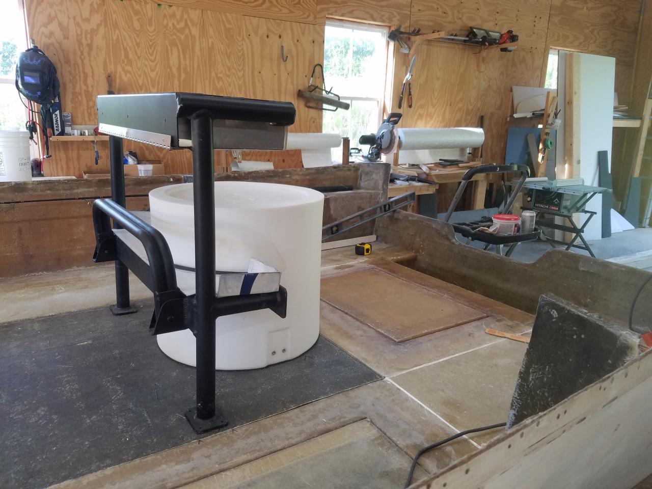

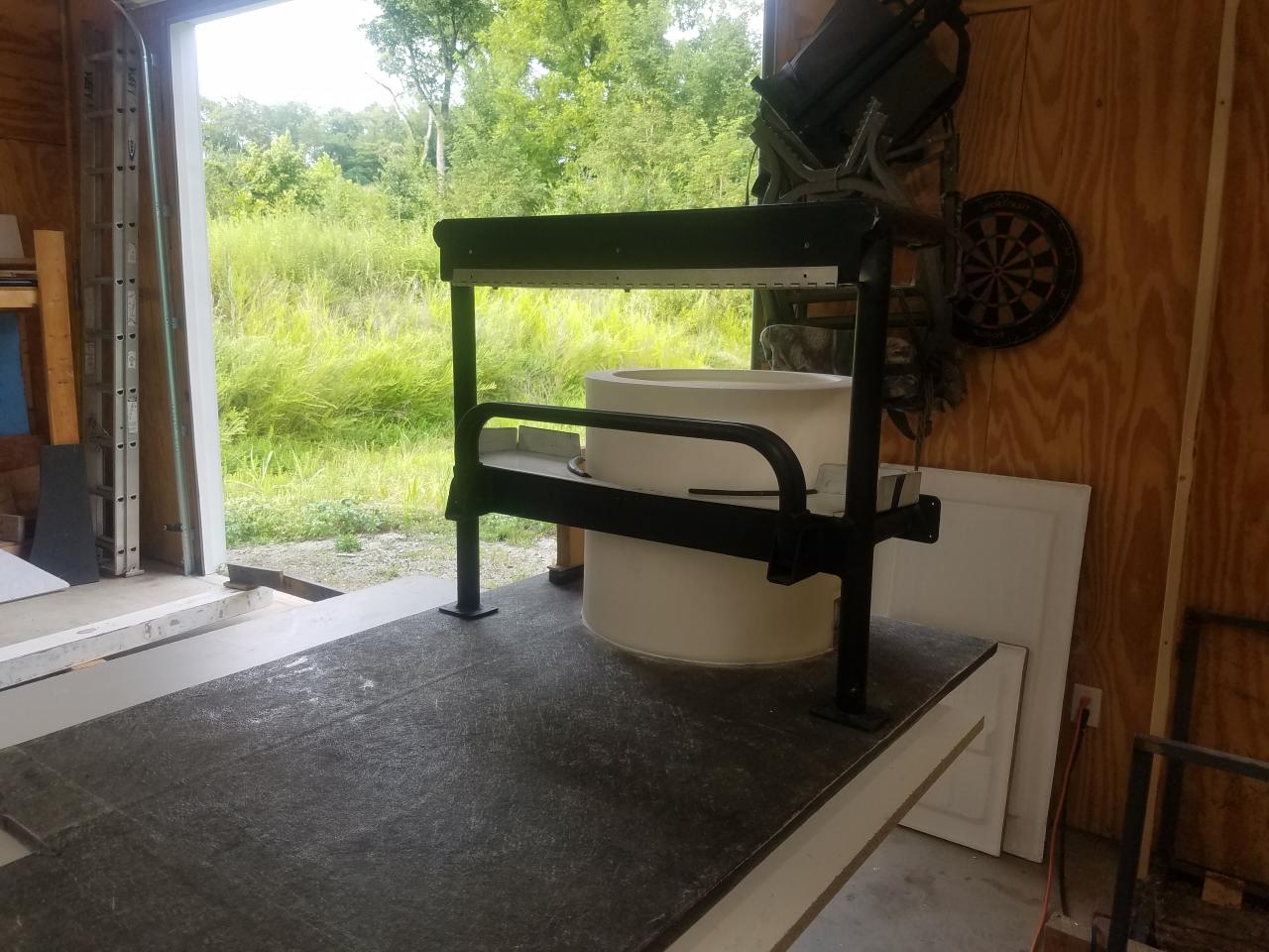

Drilled holes for livewell and leaning post mounts. Gel coated under livewell and lean post pads. May mount this before i send to paint. Still need to weld back legs on leaning post. Tig welding is ridiculous hard. Will probably get my son to do it.
