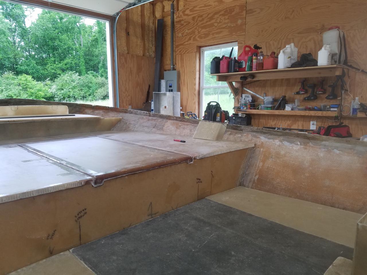

Thank you Rick.. here are some hatch pictures. Beveled the core this time. This I ne 8s matte x 2 then lhen 1708, core, matte, 1708, plastic, and finally battery

Cut the hatch in half. It fits now. I suppose I will glass it back together. Will probably not do the piano hinge in the middle. Included some other pics of front hatch.

Lammed the bottom of the hatch with extra piece of divinycell. Will put a sheet of matte on other side .

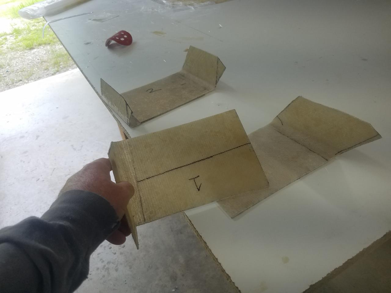

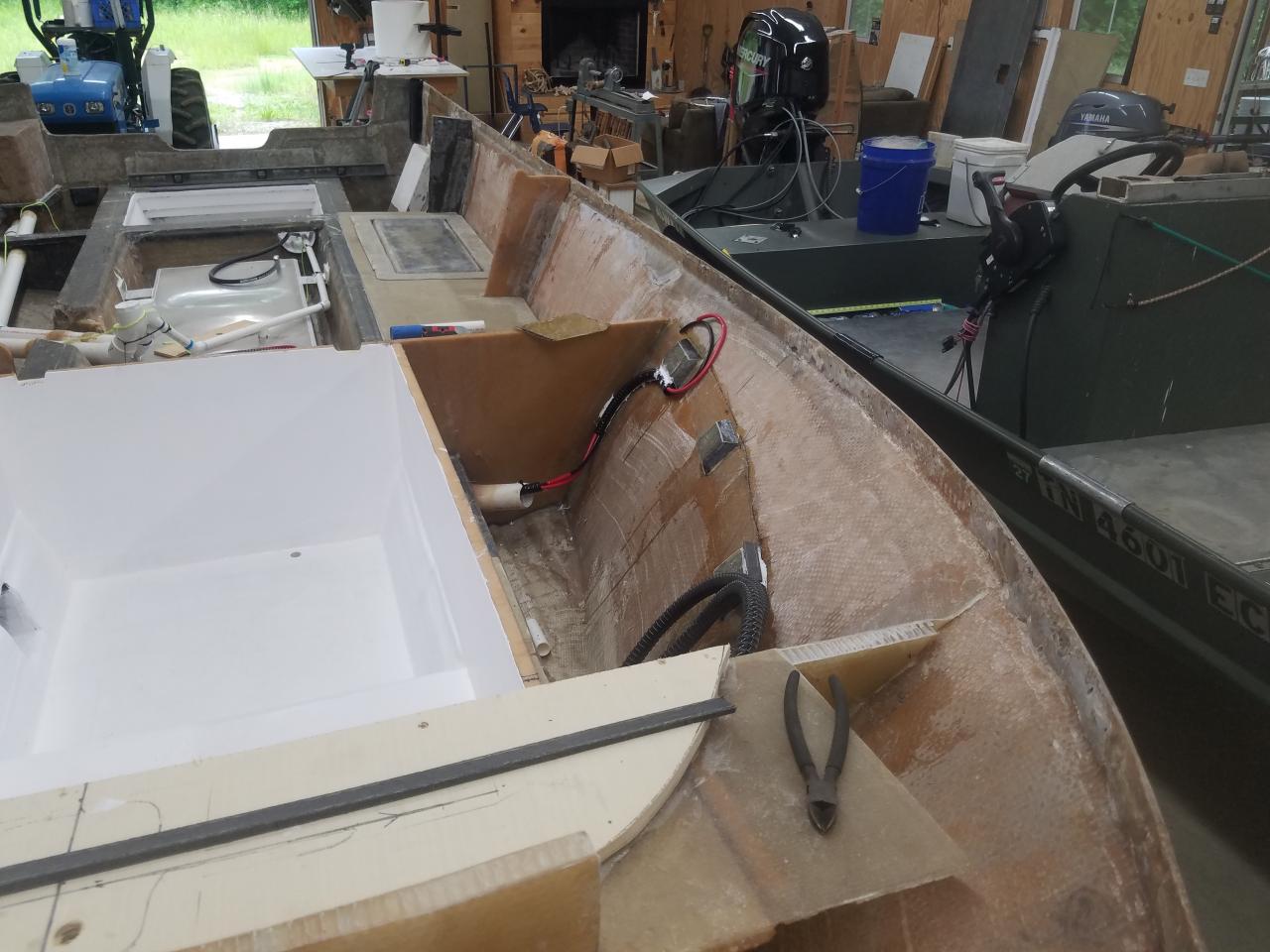

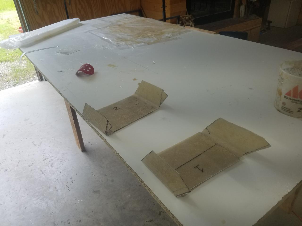

Need a spot for fuel fill and vent on starboard and trolling motor Batts on port. Made these things out of left over piece I had contemplated using for deck rail/outward stringer. Thickened resin between the two pieces. Will eventually glass them to Deck and hull

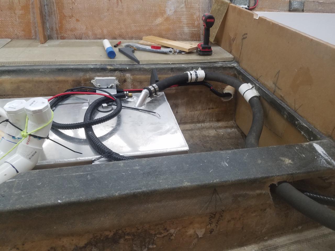

Finally got some 6 gauge tinned wire for the trolling motor. Put chaffing hose over it in strategic spots (fuel tank and other contact areas). Glued and zip tied the hose to various hard points using the gorilla glue ultimate. Next will 5200 or bonding putty and tab the front deck down.
