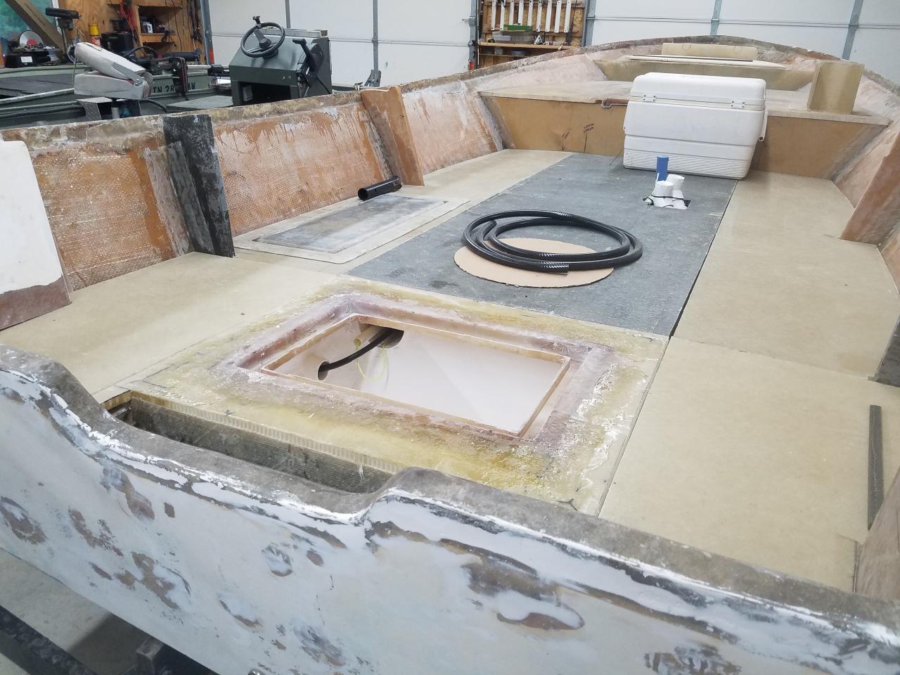

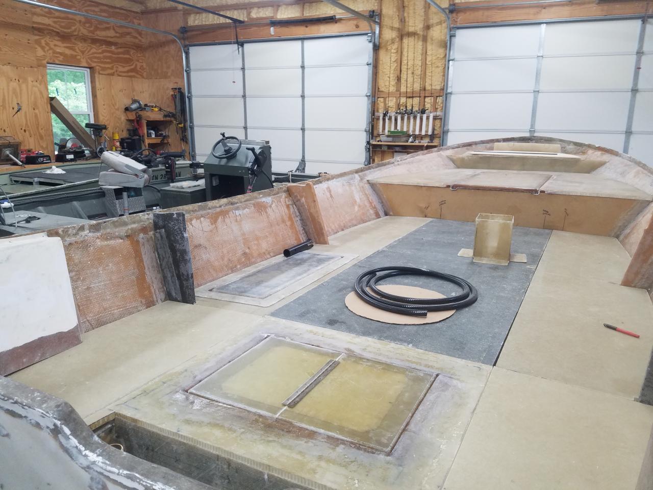

Bilge hatch is next. Below process was as follows:
1. Put layer of Matt and thickened resin around bilge deck cut out
2. Insert gutter assembly into deck cut out
3. Wait for glass to cure then grind
4. Reglass areas of poor contact
5. Flip over and glass gutter assembly from bottom for additional strength

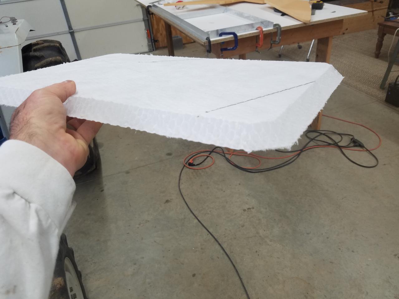

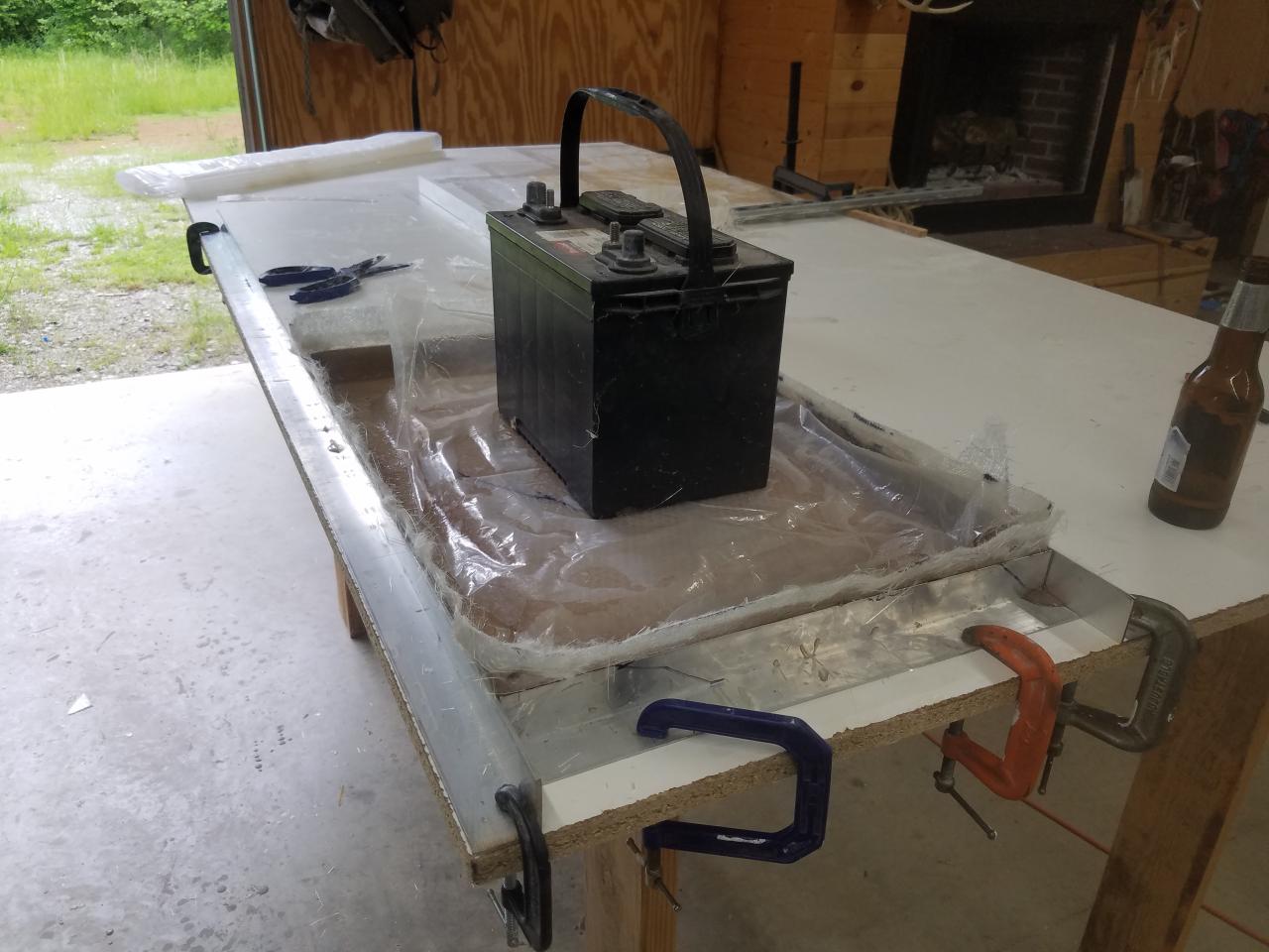

Thank you Rick.. here are some hatch pictures. Beveled the core this time. This I ne 8s matte x 2 then lhen 1708, core, matte, 1708, plastic, and finally battery

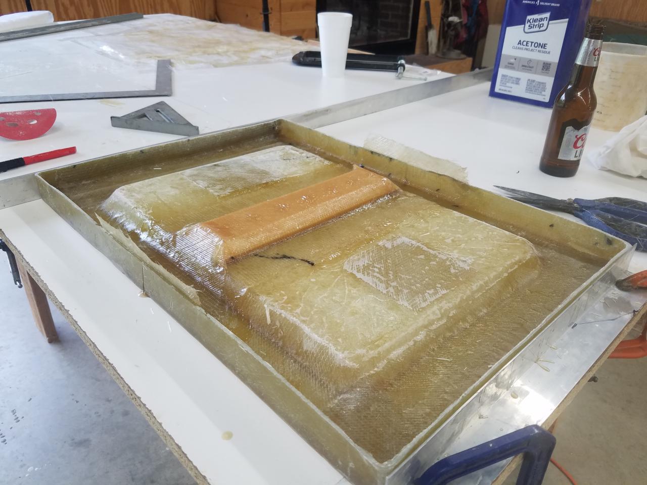

At any rate I made the hatch 1 inch too long. So stupid. Going to try hinging it in the middle or making a two part hatch or cutting in half and lamming back together. Again, soooooo stupid. Any advice other than measure twice cut once?

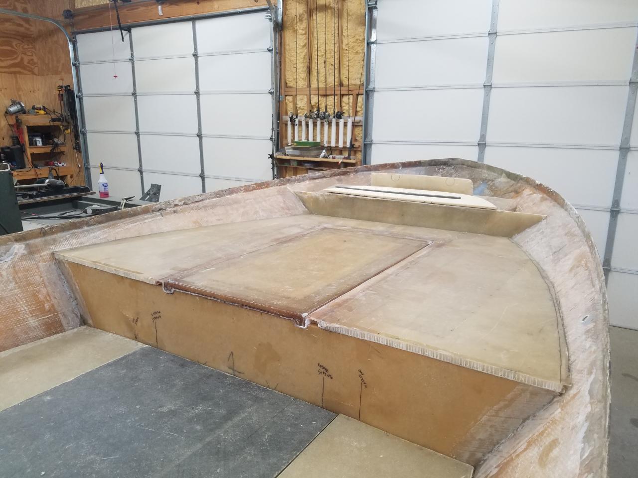

Cut the hatch in half. It fits now. I suppose I will glass it back together. Will probably not do the piano hinge in the middle. Included some other pics of front hatch.

Lammed the bottom of the hatch with extra piece of divinycell. Will put a sheet of matte on other side .
