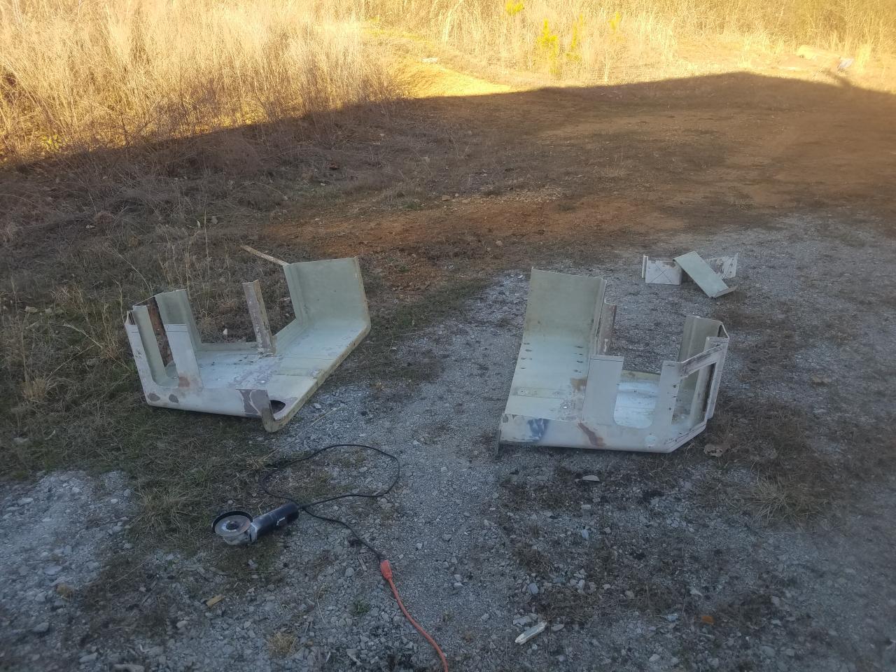

February 27, 2025, 07:20:38 PM
Reply #569
483
Re: 1973 196 rebuild question
Reply #569 on:
February 27, 2025, 07:20:38 PM »
All the joints have structural support underneath, either the stringers or the ribs which go all the way to the stringers. Should be really strong and am planning on lots of 5200 under the deck and in the joints.
Cut 6 inches out of the center of my console. You can see the piece on the ground.
Contemplated dual conSole, but no.
