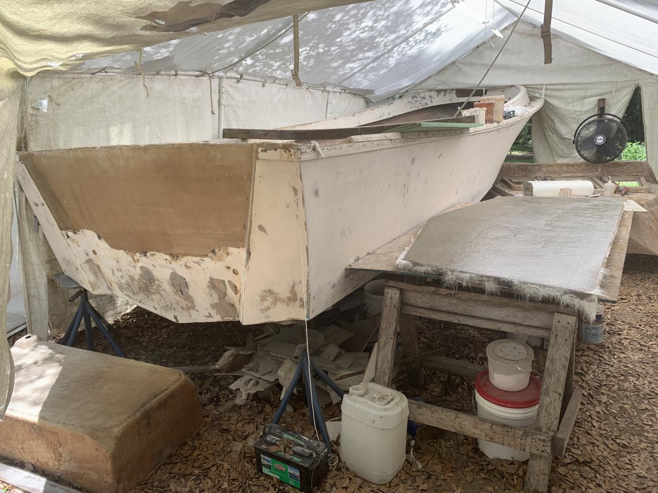

Re: 1974' Aquasport 240 CC Rebuild
« Reply #51 on: March 10, 2025, 12:28:41 PM »

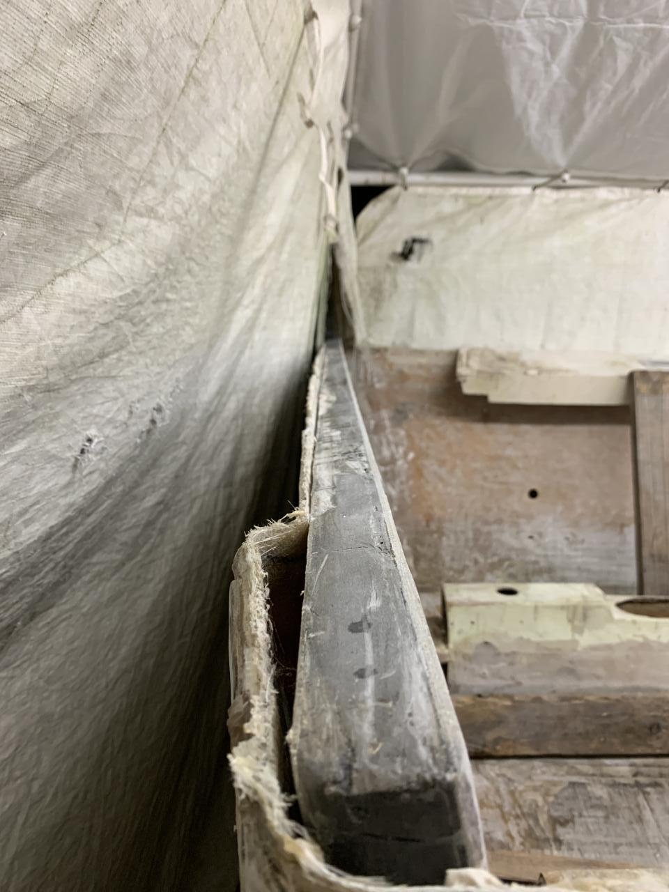

As it turns out, I had TERRIBLE contact from the Coosa to the exterior skin. I made the mistake of rushing to bed the coosa in the coring compound right after two (2) large 1708 glass layups after MANY hours. It was in the late evening/early morning and knew I should have waiting till another day. Oh well, everything is repairable with fiberglass, right? Just throw more $$$$ at it. HAHAHA
After much thought of a repair and having to fill the void with Arjay transom pour, I decided to pry it off and redo it again. Thankfully, it had very little contact (only at the top) and after cutting the fillets at the edges with a multipurpose blade, it let go fairly easy using a pry bar stuck in the corner pocket.
Pictures AFTER Coosa was pried off:

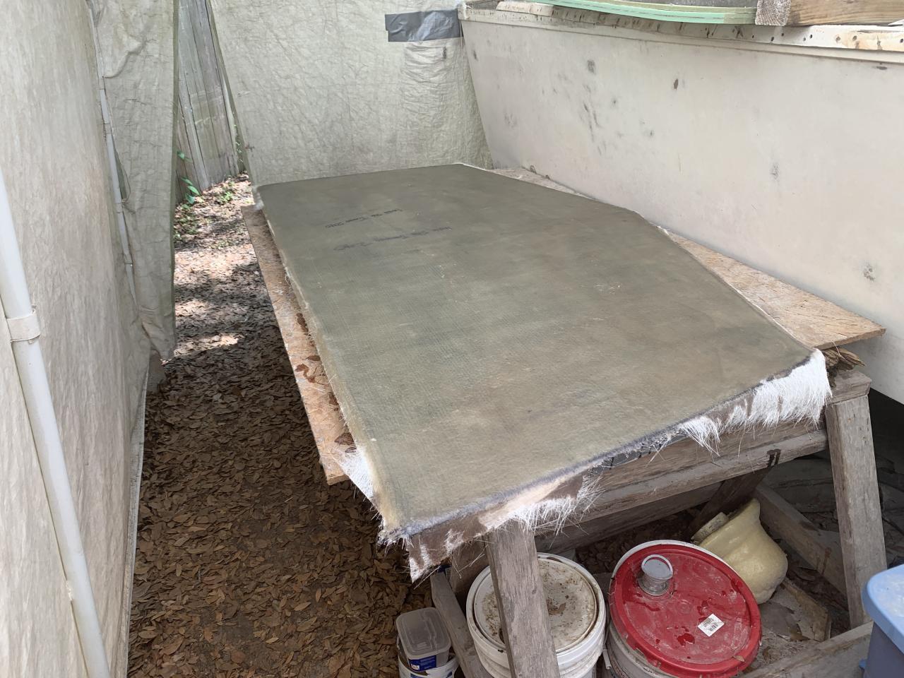

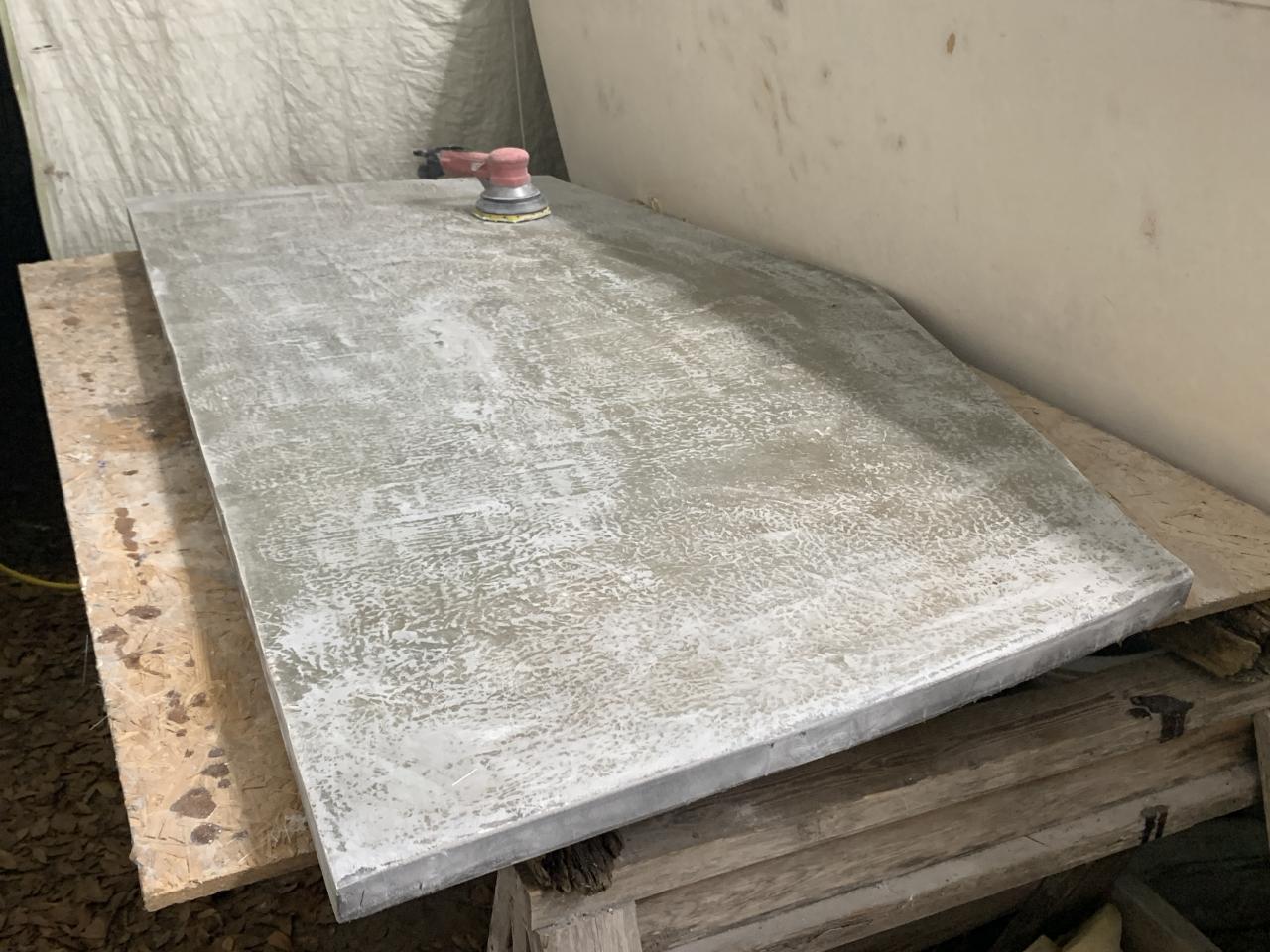

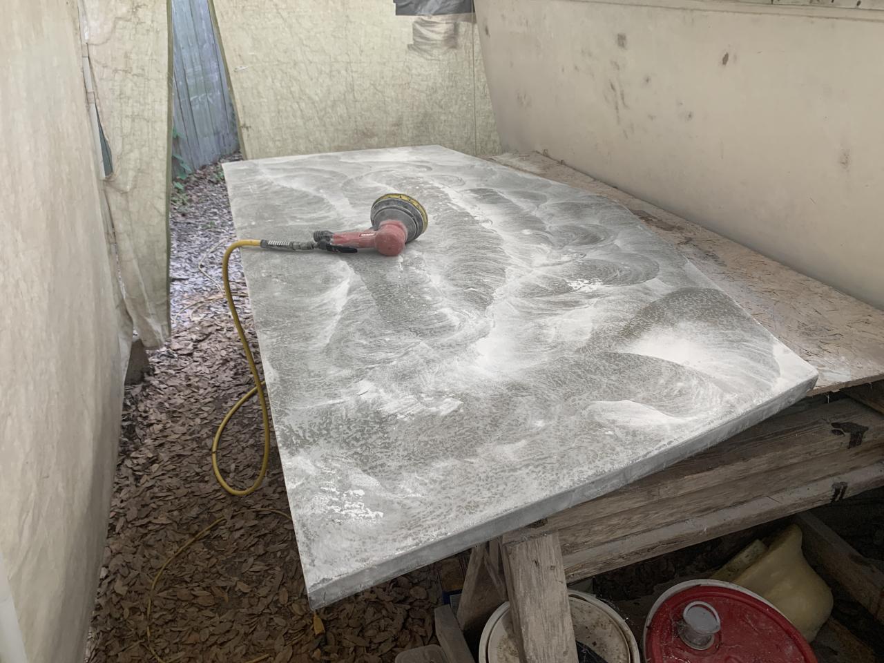

  • Posts: 432
« Reply #53 on: June 19, 2025, 04:59:20 PM »

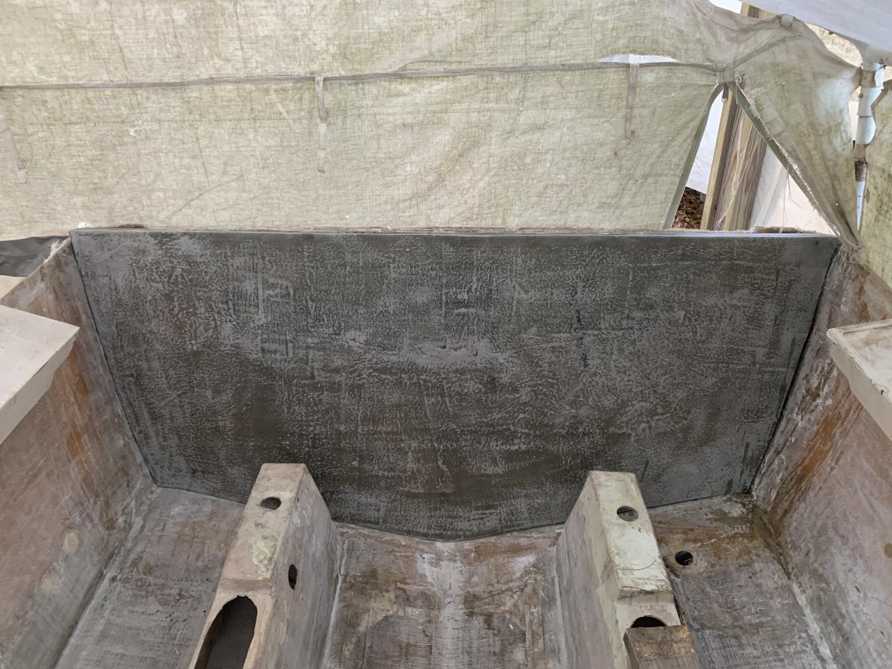

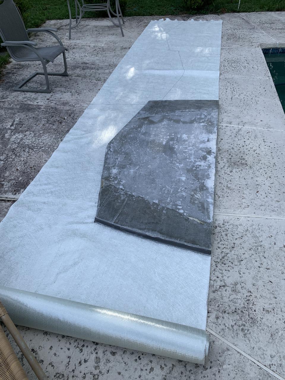

I guess I missed the photos from grinding all the core bond off the Coosa board and the inner side of the outside transom skin. I did decide to laminate the inner skin of the Coosa before I bedded it in to save my back a little. That way I can tab in the bottom and sides with a couples and layers and just one full layer to tie is all together. It was solid before and now its solid as a rock.
Three (3) layers of 1708, trimmed/sanded with 40 grit and set in place. I will have to fair the inside with thickened resin to get a flatter surface so i don't end up with voids.
Here is a photo dump from this past weekend.

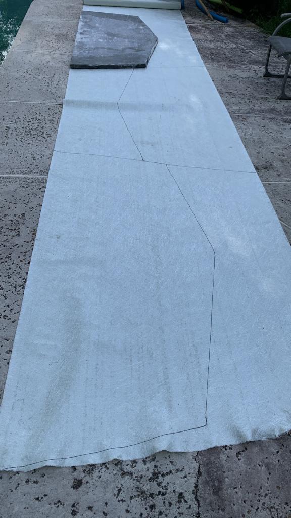

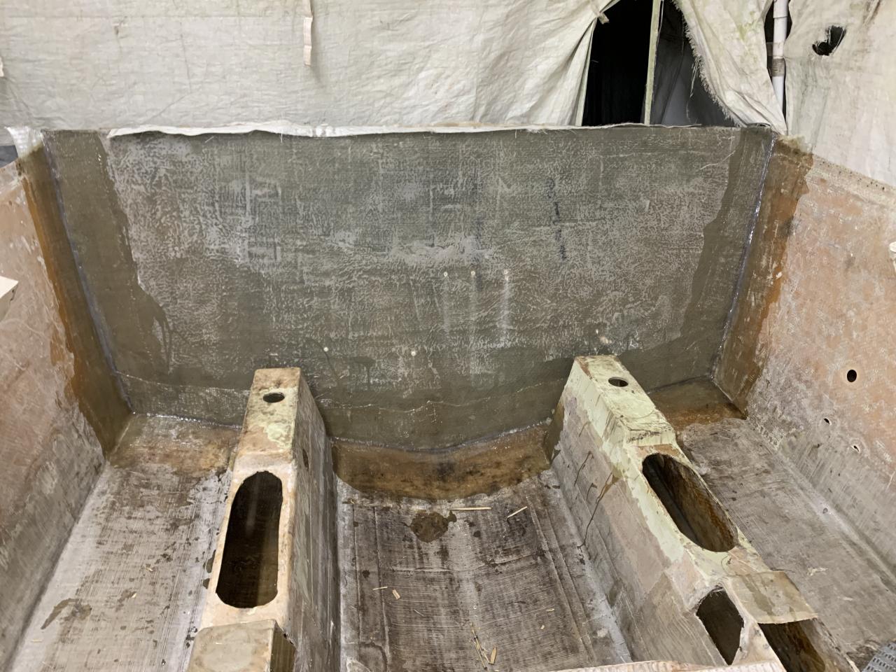

Its time to finish and put this 240 back together!! Good Weather is coming! Got the outer skin leveled out and reset the Coosa back in and a layer of 1808 tabbed in. This time I used thickened resin trolled with a layer of 3/4oz matt on each side (transom skin & inside of Coosa). I used the freezer bag method it was still messy but worked out well.

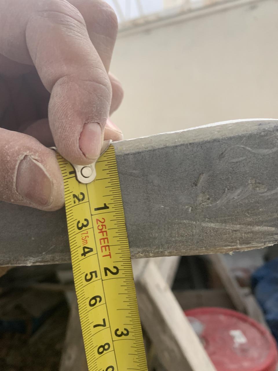

I checked it last night and it sure did kick off solid! It will be rock solid and probably the only 240 (that I have seen) that will have cored hullsides (3/8'' scrimmed and scoredDivinycell)....just like I did the flatty (@1/4'').
