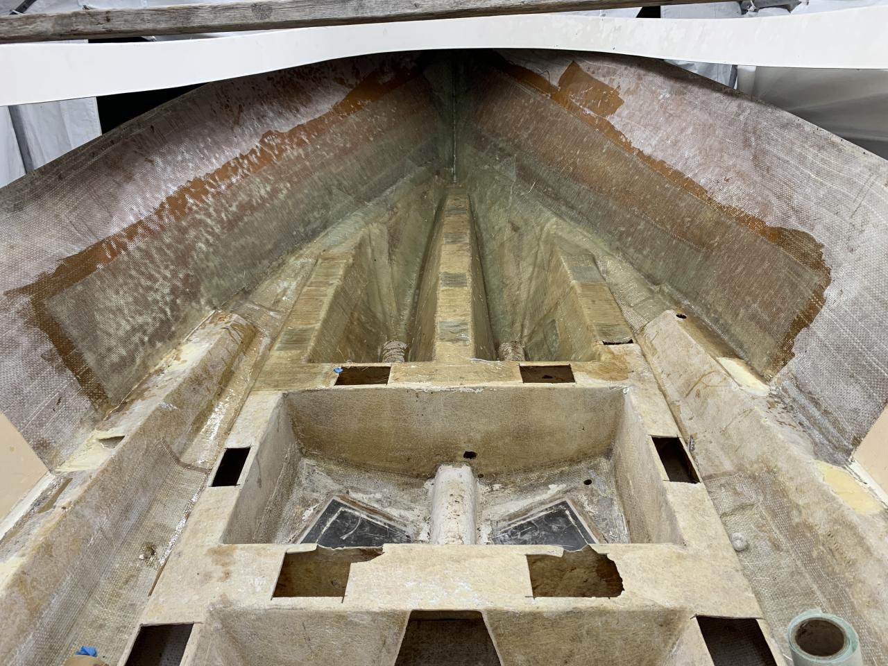

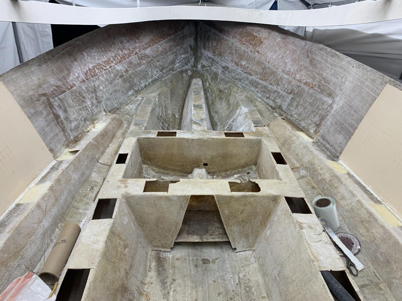

Got some layers of 2408 glassed up in the bow. I had to grind gelcoat off and it cut the tom layer of woven. While things were wetted out, I went ahead and did the structural work for the forward bow stringers and hull bottom/chines. Five (5) hours to get this laminate done last night. It doesn't look like much but the longer side laminates were 9ft piece @ 12'' wide and there were another two (2) 76'' pieces per side to beef up the stringers/chine area. It was also an awkward area to work and had to lean over it all and "paint myself out of a corner" sort of speak.
Next I will finish the rest of the hull side coring in the bow and cap it with at least a layer of 1708.

Excellent. Looks really good. These old boats love new glass.

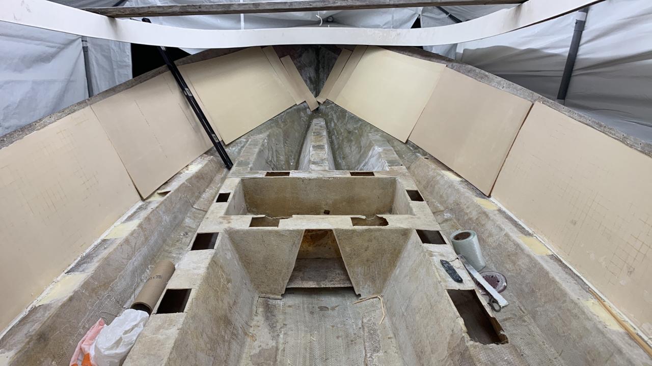

She is really soaking it all up and standing tall with all the new resin/glass materials. There have been many days that I have not been able to stand on those forward stringers, last night it proved that just one (1) layer of 2408 makes the world of a difference to the structure of these stringer. Unfortunately, the flatback stringers were made entirely of matt glass so the foam was 100% part of the structure of the stringer body. Anyhow, Hopefully I have grinded enough off to keep her thin with all the new material added!  :danceSm: :laugh03: :dancing: :thumleft:
Got the edges knocked off the new glass, scuffed here and there, and rest of coring cut to fit the rest of the hullsides. I am down to two (2) pails of resin BUT I do need additional Arjay Core-Bond to finish this up. I might get most of it laid up before I finish the bow to take advantage of the remaining spring weather. We shall see!!

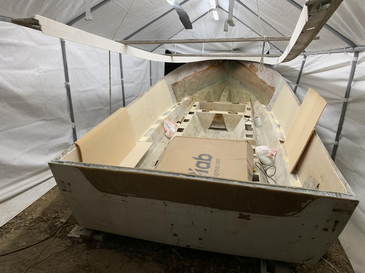

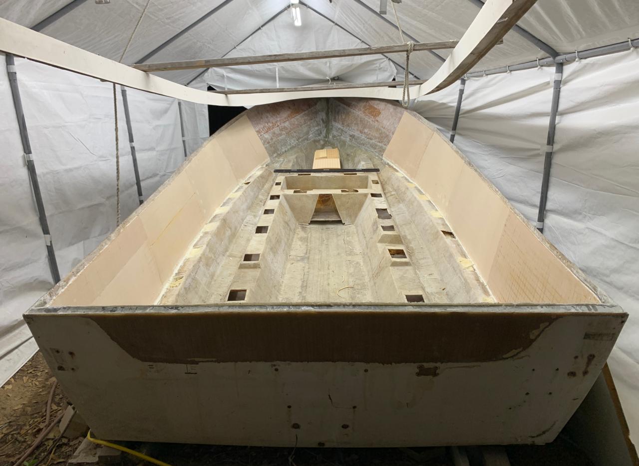

I am down to just the last two large pieces of hullside coring and a few little filler pieces (once i get my bow eye backing installed). I laid up two large pieces last night but ran out of core bond 4001. Until I get some more I plan to laminate what's done with a layer of 1708 and have a small overlap when the rest of the coring material is stuck down.

She's going to be a tank  :thumleft:

Stout
