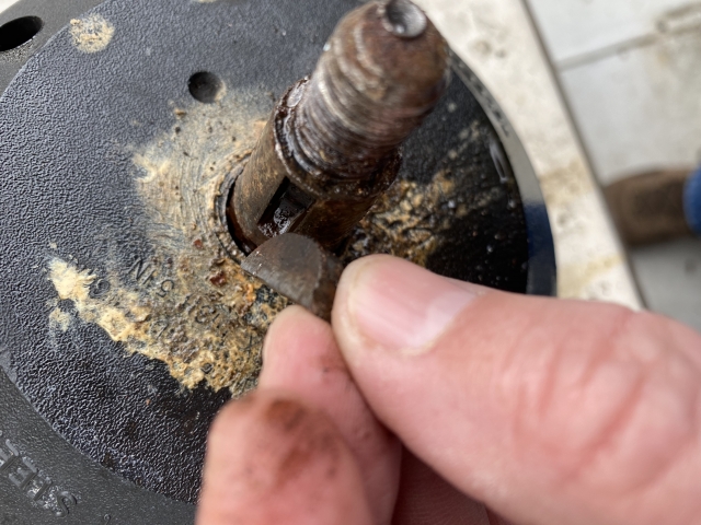

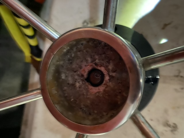

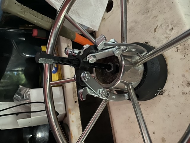

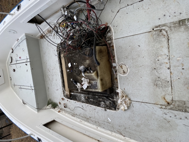

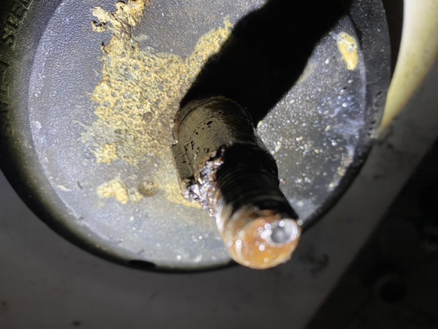

Update after yesterday’s snow ... managed to get the wheel off, was actually easy after initial learning curve ... a tip, keep the steering wheel’s nut on a few turns, but leaving enough proud of the end of the steering wheel shaft to create a lip that the clamp’s bolt won’t slip out of. It did take a little gentle persuasion to get the clamp’s jaws under the wheel’s base ... 2 firm bangs on the clamp’s bolt, retighten clamp’s bolt, 2 firm bangs on the clamp’s bolt, retighten ... repeat 3-4 times. The “firm bangs” are just that ... firm, not Thor-like.

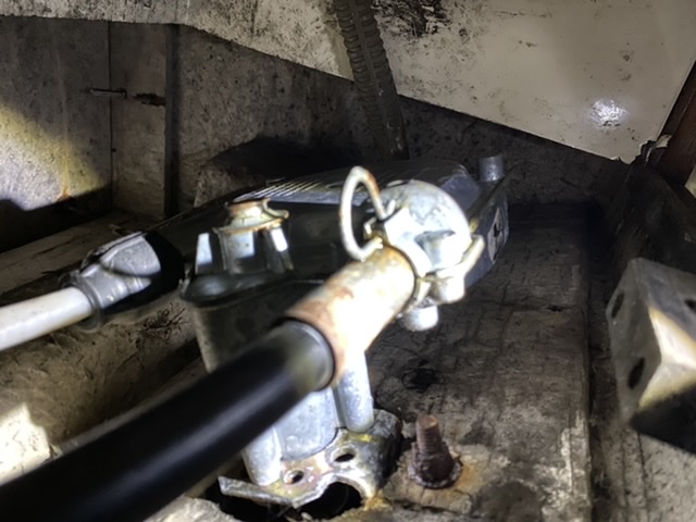

Now for some input please ... what is the best way to remove cables from housing? Tx all.
Notice the ridge on the shaft
Matched slot on wheel’s base
Base of steering housing ... where to start
Thanks guys
January 19, 2020, 03:07:00 PM
  • Posts: 11426
Re: Brad's '84 175 redeck
« Reply #18 on: January 19, 2020, 03:07:00 PM »
Pull the cotter pin and then work it out.

Sorry I know I'm late to the show. To remove the steering cable you have to remove the cotter pin and stick the end in the small hole and it releases the cable. It releases like an air hose fitting. Then push the new cable in until u hear a click and reinstall the cotter pin. You probably figured it out already but I posted in case u didn't. Good luck

Thanks Bat, managed to work through it this morning ... found out what a Woodruff Key is and how stubborn and clever it is.
Got the steering mechanism off in the way Bat described ... lesson learnt - remove cable before disconnecting entire housing from the console (actually, probably be best to do this step before even removing the wheel, IMHO).

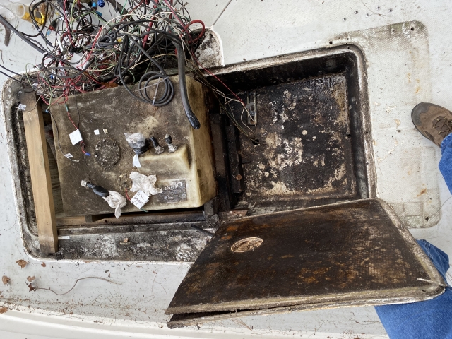

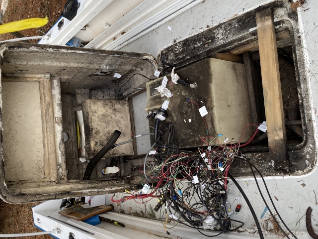

Got the console completely disconnected and off the hull and then the soft old fuel tank access panel ... time now for reflection and visualization...
Plan is still to replace the deck at the moment ... thanks guys for the guidance so far

I see the delam on the tank cover.
The best way to repair this is to do it from the bottom side and use a cutoff wheel to cut around the perimeter of the backing/core (just through the fiberglass laminations to cover the core), peel the backing/core off, grind the leftovers off and recore it. Then glass it back in.
Make sure you clamp the cover down on a flat surface non-skid down and figure how to get the core out (like I mentioned above) and then repair any damage to the lid from the inside with more glass and then recore. Try to do all the repair work so you minimize what is needed to repair the top side.

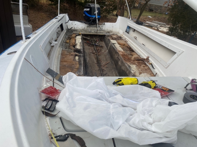

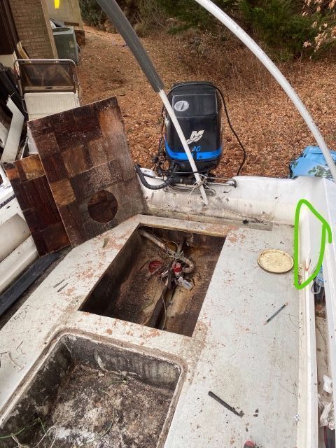

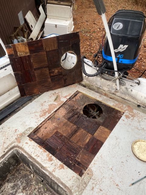

Taking advantage of the weather and did the Angels and Fools thing:
No going back now ... (Note to self, even 4 short cuts creates an irritating array of fiberglass itches ... wear gloves and other protective gear )

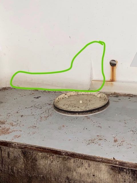

Question ... there is a small "bulge" on the Port Stern quarter which the opposite side doesn't have ... any reason why it's there?

The bulge looks to be in the liner mold. On the Starboard side the trough is in the way I think?

Definately done on purpose (yip, starboard side is the trough), but to what purpose?

On my 19’6 there is a bulge in the liner in the same area that leads to a vent on the outside of the hull. I always assumed that was there if you had the I/O version and needed an exhaust fan for fuel fumes?

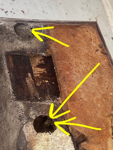

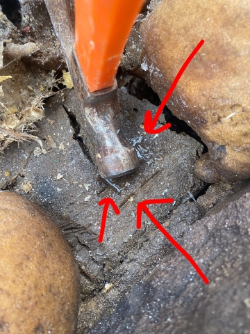

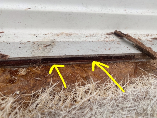

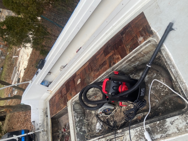

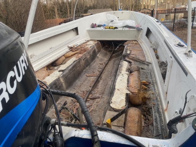

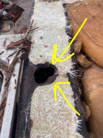

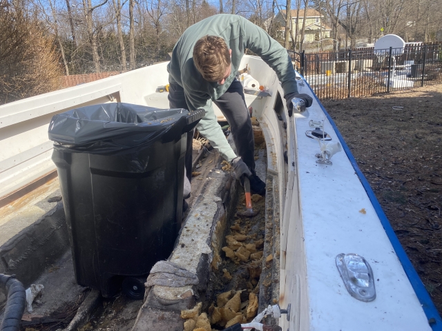

Carried on cutting and removing today, based on the holes in the top of the stringer and sopping wet foam on the outside of the stringers, this is definately the right decision.
Some pics for posterity sake:

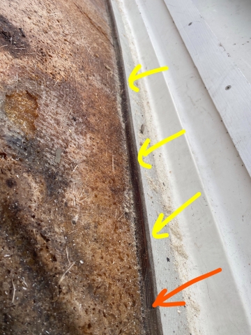

This is intended to be the lip that the new deck will rest on ... but the plywood is damp ... cause for concern? What are the next steps?
Yellow shows wet ply, orange dampish:
Sopping wet foam on outside of starboard stringer, almost no pressure on hammer
Open holes on top of stringers, must have been from when they sprayed in the foam, wonder why they didn't seal them?
Great big empty cavities in the stringers ...
Got the coffin/bathtub out in one piece ... reuse for new below deck tank?
WiP
Time to order the glass and stuff ... no going back now.
