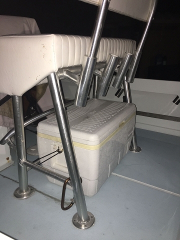

Leaning post has arrived and it's time to mount.  I am conflicted on the 5200 method vs overdrilling with epoxy.  Obviously one is way easier than the other.  I need to check the wood quality with some  pilot holes.   Had to do a lot of deck injections in the general area from the previous owner using really poorly sealed deck holes.  This leaning post will be mounted partially on the tank coffin top, and partially on the deck as you will see in a picture.

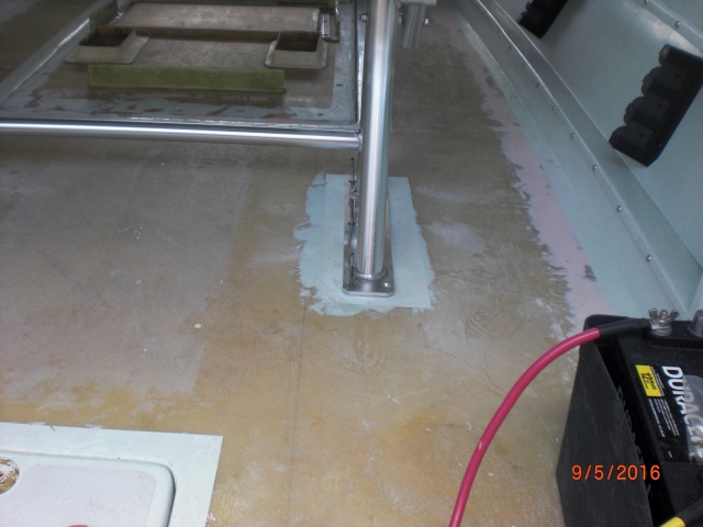

Here's my install:
Set the seat carefully back in to make sure it mounts correctly - the all thread gave me a guide. I remove the all thread and have clean threads and can measure the depth for the real mounting bolts.

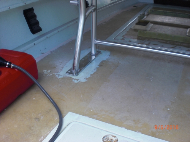

The photo below is mine, installed in the exact same manner as I described above.  I've subjected my hull to all sorts of nasty weather, whereby excessive forces act against the purchase strength of the screws securing the leaning post flanges to the deck.  It hasn't budged.
