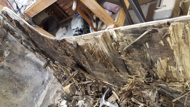

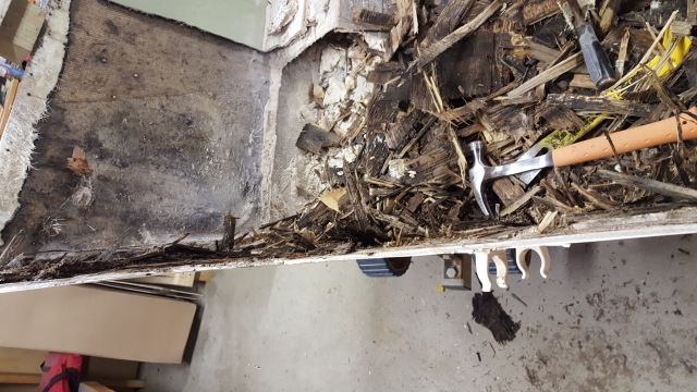

18 degrees out, so why not start pulling the old plywood out of the transom.
Thinking about doing bench seats instead of a casting deck up front.  Anybody else done this?  Thinking some hinged tops on the benches with storage underneath.  I can't see a whole lot of benefit to having a fishbox, but see plenty for having extra deckroom to walk around.  I have lots of coolers, not sure I need one built in.

Super progress  :thumleft:  - looks like a new hammer too, nice!! I have so many new tools from my rebuild I really don't have room for them - maybe a yard sale is in the future.
As for the bench seats - you can easily mod the casting deck to meet your needs. Fiberglass work is really very easy if you have imagination and some basic woodworking skills. The lamination process we can teach you.
If you lay a straight 2x4 across the aft side of the transom is the transom skin flat or bowed?  Mine was bowed toward the inside of the boat 3/8" in the center. IIRC the bottom of the transom skin was flat. I needed to pull the skin aft while I layed up the first 3 lams of 1708.
