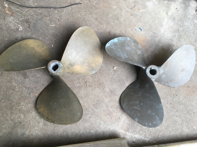

There are many on here that know more than me, but the size and pitch of the prop would be good information to add. I have a hunch that it may be the culprit.

A 350 marine 4 bbl carb engine usually puts out 250-270 HP and that's plenty for the 222.  Is it direct drive or is there a reduction gear in the transmission?  Props would be different depending on gear ratio.  You should be running around 40 at 4000 RPM with a 2:1 ratio and a about a 14x19 prop.  If it's direct drive (1:1 ratio) the prop pitch would be much less - maybe a 14x13.  Direct 1:1 drive would not be my preference on that setup, as the tip speeds on the prop at 4000 RPM are likely to cause cavitation and slip will be high.  The size and pitch should be stamped on the prop hub.  See what you have.  I would guess you will need to increase pitch a good deal.
One more question - do you know the condition of the foam under the decks?  Have you weighed the boat?  How does she sit in the water?  Some of these boats have wet foam with hundreds of pounds of water under the decks.  That can affect performance a lot!

Should you find you need a different prop, I still have those two props listed there as well. They came with (and on) my 22-2 before I went at it.
