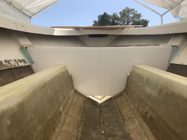

This week I was able to cut out my rear bulkhead and glass two layers of 1708 to both sides. Since this will be above the deck, I used poly resin. On the area that will face the bow I messed around with white gel coat and put a layer on the piece.
I’ll sand the edges and gel coat, then see how it fits again. I also purchased a 55 gal moeller fuel tank which should be here sometime next week. Next I’d like to finish up several small items on the boat and have the front bulkhead cut out (the bulkhead that meets the deck to the upper floor).
This is the bulkhead before I trimmed it up.
Help me out Joe. What is the piece for? Do you have a pic of the boat from the front with the deck in?
I don’t have a picture from the front with the deck in. This piece will be for transom storage and access to pumps and wiring. I’d really like to have a foldable bench seat that can connect to it. I’ll be adding epoxy tiles to it.

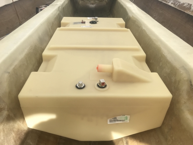

Gas tank arrived and it fits perfect. I was able to sand down my bulkhead too. Prepped for the weather, but ready to get some more work done!

Miscellaneous glasswork was done today, along with cutting out the front bulkhead and laying glass to it. I started on measuring bulkheads, but want to make sure I’m placing them in the right location. My mind is set on trying to make supports for the front deck since there is a large gap from hull to the deck. One step at a time.

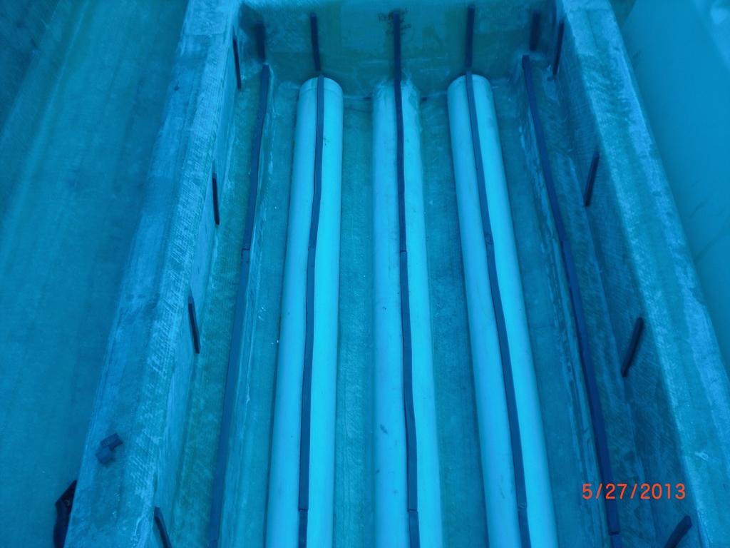

How are you going to support your fuel tank?
This is how I did mine - split 3" PVC and tapered them to make sure the rear was low but not too low. I cut up a foam padding that you see interlocked on boat floors.

I was going to place a 1.5” round pvc down the middle. On top of the pvc would be a glassed piece of 1/4” foam that the flat belly part of my tank will sit on with neoprene. I’ll adhere the neoprene to my stringer sides too.  I’m thinking of making supports from scrap Coosa to help support the tank.

Sounds like you're making good headway. I used contact cement to secure the neoprene in my tank coffin.

I hate to say it but I don't think cutting grooves in the stringers to level the fence post risers is a great idea. I'd be concerned about the fence post ledges cutting down into the foam. Sure you have 'glass to hold them in place, but glass is not excellent in compression. Furthermore, that glass to PVC bond is less than full strength. I hope I'm wrong and you'll likely never have an issue, but I felt the need to say something in case anyone else wants to adopt this method of raising the floor.
