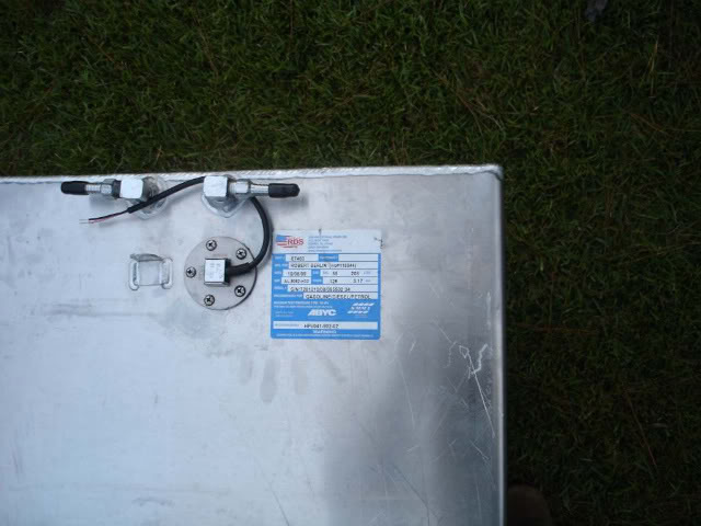

Well it was killing me to find out where the fuel was coming from so I tilted the console and pulled the floor. I found two small pin holes near the fuel sender and grounding  weld. The tank was made by RDS manufacturing which i don't think was the original tank. The question is can I patch the two holes and to put a new gasket on the fuel sender and NOT pull the tank and replace it? Any input would be great.

Have you inspected under the tank too?  If not, I bet you have other pin holes still hidden from view.  I’m not a fan of stop gap repairs on something as vital as your fuel tank.  It only takes a couple of drops of fuel in your bilge and a spark to make your boat go boom.

I'll make it unanimous. Pull the tank. Gas in the bilge??? Been there, done that....... twice.
RDS was in fact an Aqua vendor for the Genmar built hulls. Since you can see the label, it should have all the tank specs including built date.
