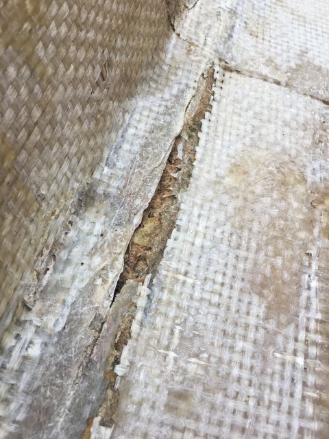

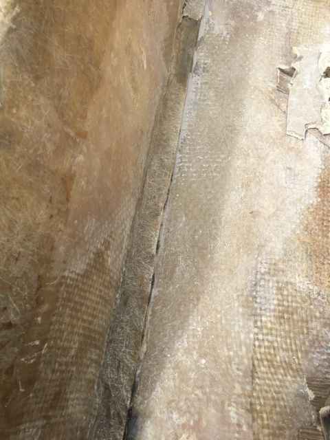

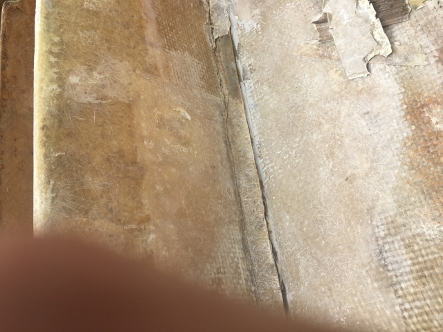

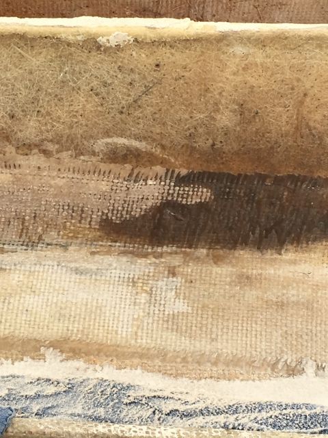

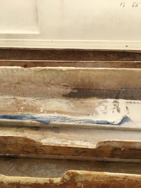

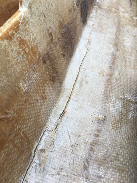

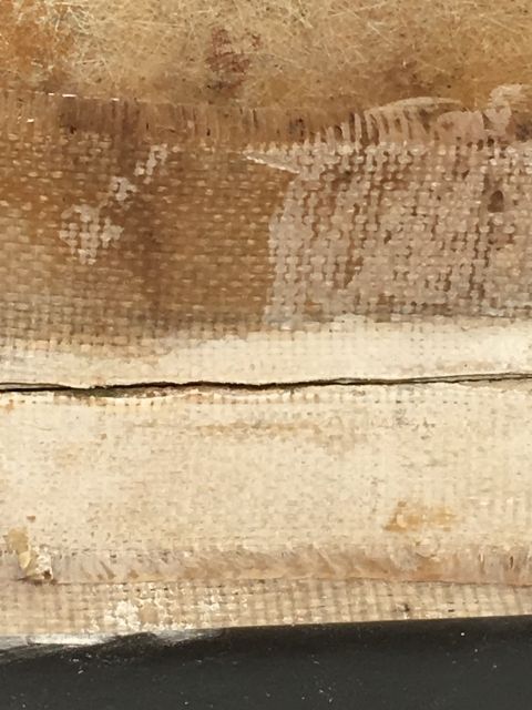

so ive done a little grinding... i just want to see if you guys can tell me if im doing it right... to much... or not enough... any advice helps. in the pics the darker glass is before grinding and the lighter/white glass is after grinding. the cracks you see are the stringer peeling from the hull. thanks in advanced for the help!
October 05, 2016, 11:32:23 AM
Reply #35
love2fish
  • Posts: 638
Re: 1980 19-6 rebuild
« Reply #35 on: October 05, 2016, 11:32:23 AM »
it looks like you are doing it right, but might need to go a little more. especially on the last picture, and 2nd to last picture- you can see on the HULL side of that section you are grinding, that looks like the top layer of woven glass that they laid down... chances are that layer is compromised, I would grind that off and get down to the hull layer of glass. you have the right idea there on the pictures where you have it grinded down to where you can not see the "check" of the existing woven/black spots"... you want that "chalky white layer, which means- fresh glass you can bond your new material too.
on the areas, stick a flat pry-bar under the edges and see if it lifts up. if so, keep peeling it back. or grind it all the way off.
your new layer is only going to be as strong as the layer you bond it too...and if it failed once,,, chances are, it will fail again.
good work though and keep posting pictures if you are unsure.

my concern is on the crack... did i grind to much?

just work on the bottom area of that crack. clean up that rough glass.
This was from my first 22-2.
the entire inner edge of my port stringer was delaminated. I ended up cutting it out. started grinding only to find a void between the raised section and the hull bottom. I was literally able to take a circular saw, and set the dept the the blade to just cut the raised portion out. then grind everything smooth.
here's a few pics to show you what I mean:
The raised area:
once I started grinding- noticed the "gap" where the 2 layers were separated...
here you can see where everything was ground down to the hull level, this is what you want. and where you can start re-glassing.
you need to clean up that cracked area more- get rid of any class that isn't solid/connected. then go back and add a layer from the stringer down to the hull. add a fillet, and glass over that again. each time using different widths of glass so they are binding multiple layers and not just the exact same footprint each time.
the glass on your stringer looks ok- just continue to grind until you get the "sheen" and dirt off- , the hull part- I'd grind that whole top layer ( you can see the 3-4" section of glass they used as the bonding layer) off and bond the stringers freshly to the hull.

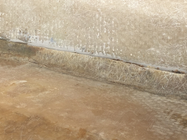

« Reply #40 on: October 06, 2016, 01:24:37 PM »
Is this what I need to get it looking like?
October 06, 2016, 08:32:05 PM
Reply #41
  • Posts: 11420
« Reply #41 on: October 06, 2016, 08:32:05 PM »
You're getting close  :thumleft:
You want all the "print" of the cloth gone so you have a nice smooth place for cloth to stick. You can see the "shine" on the lip at the bottom of the stringer - scruff that up too.
When you start to glass them together you'll want to be mixing up some peanut butter consistency resin with cabosil, and maybe some chopped glass, and hopefully lift the edge of the lip and stuff some of the resin under to combine the bottom of the lip with the hull under it - so if possible see if you can get the grinding disk under the lip in a few places.
To attach the stringer to the piece of stringer liner that is now "the hull bottom" you'll need to lay in a fillet of thickened resin along the bottom of the stringer where the lip starts and lay in a 4" wide strip of 1708 cloth (2" up and 2" down) and then immediately lay in an 8" strip over the 4". Make sure you put the CSM part of the 1708 down.
You may decide to scruff up all the stringers and lay a strip over the entire hull and stringer to tie it all together. That will tie everything together but remember that the cloth you are laying in, as was said earlier, can stick to the old but oif the old isn't really stuck well, then....

Looks like you are getting better at the grinding, but yes as rickk said you need to get all the printed woven fabric off. When you're done it should basically be all white and you want be able to feel any fabric pattern if you rub your hand over it.
I know it's scary grinding down that much because it feels like you'll bust through the hull but there is quite a bit of glass there to work with. Go check out my build and you might get an idea.
