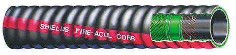

I believe shields makes a more flexible fuel fill hose, I have used it before and I think it will make that bend so long as there is not another bend close by.
Joel,
Is this the one your talking about? Looks pricey...
Fire – Acol – “C” Fuel Fill Hose – Series No. 351
http://www.seastarsolutions.com/wp-content/uploads/2010/05/351.jpg
Size Range – 1 1/2″ 38.1mm Warranty – Limited Lifetime
Shields Fire – Acol – “C” Fuel Fill Hose resists gasoline/alcohol blends and has a corrugated cover for extra flexibility. This hose is compounded for low permeation and is reinforced with a wire helix imbedded between plies of HD synthetic cord. It is also abrasion resistant. This hose is primarily used for extra flexible fuel fill ( gas or diesel ) and is for pleasure boats only. The temperature range is -5ºF to 180ºF. It meets SAE J1527 type A2 and ISO 7840 type A2 NMMA/CE Type Accepted standards. Get More Info…

The regular Shields fill line is probably  flexible enough for that run, as long as it's new and not a used piece that's being reused...
