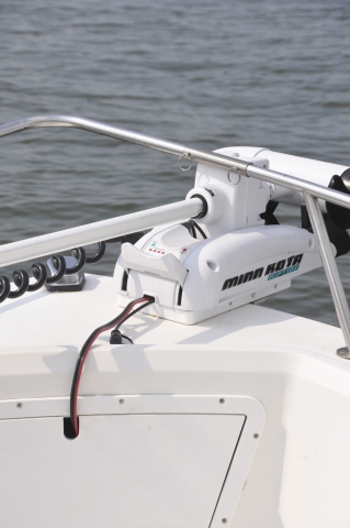

Also does anyone have pics of the trolling motor on their 175?
Kinda close:
Bow rail cutout  for tilting:
How it was done:
http://www.boatus.com/magazine/trailering/2014/october/mounting-a-trolling-motor.asp
Not really 175 specific but perhaps some ideas.
