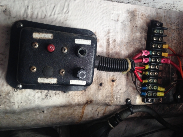

If it's an Explorer he should have a box like this in the aft end.
How it is wired depends on if it had a factory option battery switch or whatever strange things a PO may have done!

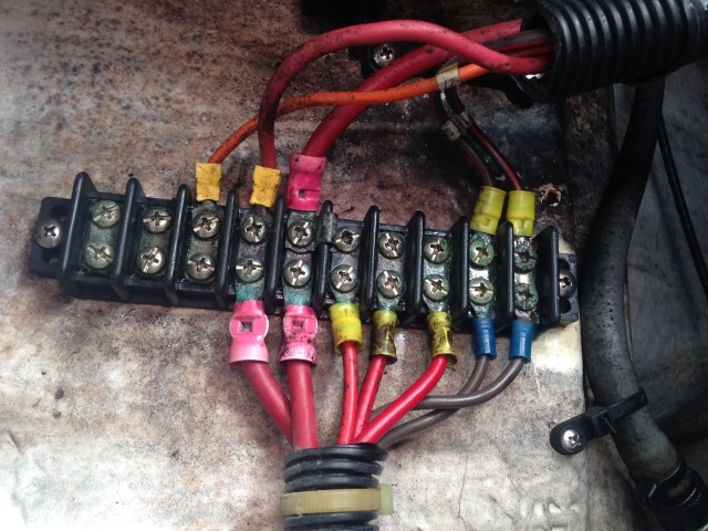

Are the 2 fuses on the MAIN for the Bilge direct connections ?  I also have 2 extra RED wires running into the MAIN but they are not connected and taped, I have no idea what they are for, would anyone have any ideas ?
I also have a Battery switch with positions OFF, 1, 2, or both, what's the correct selection to use ? This boat is new for me and I've never had a switch or 2 batteries before.  I'm guessing 1 might be starter, engine, 2 might be everything else,  or is 1 battery there just for backup ?
Thats what mine looks like. The stereo memory feed is great because hitting up and down everytime I get on the boat is a serious pain. I'm tempted to swap the fuses out for breakers though. My fuse holders have seen better days to be sure.
Thanks to all that posted, I will hook the bilges up to the start battery.
