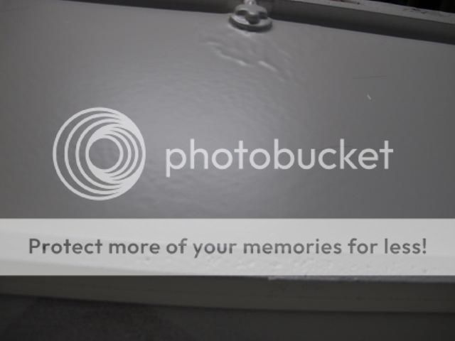

Shot the gel coat today with a dump gun. I spoke a bit too soon about the lack of "nooks and crannies" on this mold as I forgot about the latches. It actually works to illustrate what I was trying to explain to RickK just prior. Here is the first coat. As you can see I panicked a bit and drowned the latch with the dump gun. It shows how it bunches up from the air pressure and refuses to settle, as well as how smooth it can go down with the dump gun when you look at other parts of it.
I waited about an hour and shot the 2nd coat. It looks much better. I also took my time a bit more, reduced the flow on the gun, and sprayed from more of a distance with more motion to the gun
I waited about another hour with the doors baking in the sun and shot the 3rd coat
After about 2 more hours, I brought them in to be glassed. you can see a huge difference from the first coat on how it smoothed out with each coat. The best part is that if this were an external coat on a finished piece, I could sand it perfectly smooth. With it being a mold, I do not have to do anything. Each door got about 8 oz of unwaxed gelcoat per coat for a total of about 24 oz per door.
