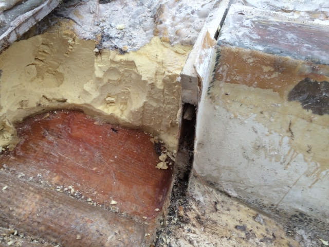

Started tearing the transom out this weekend. Lots of fun. Despite it being completely shot, it sure did put up a fight coming out.
The port stringer is really bad, and I'll need to go forward further. There are those boxes in the way. Question:
They did not support the deck, so I'm assuming they are structual? However, they have very little glass on them, and have 1/2 inch plywood cooring. They are filled with foam.....so I'm wondering of they are simply for flotation. If this is the case, I'm inclined to remove them.
Suggestions??? Maybe just replace them with a coosa "cross member"?
1981 2100 CC Hydra Sport

January 21, 2015, 03:23:47 PM
Reply #97
11330
Re: Fletch's Hydra Sport 2100 CC
Reply #97 on:
January 21, 2015, 03:23:47 PM »
I have no idea what they would be for unless there is lead weight in them for getting the CG right :017:
January 21, 2015, 03:37:56 PM
Reply #98
Purgatory
7440
Reply #98 on:
January 21, 2015, 03:37:56 PM »
Exactly as you surmise, sealed flotation chambers. I'd ditch 'em. Gives you a lot more room for bilge/bait/washdown pumps, freshwater etc. And heck, you may ditch significant weight if they're waterlogged.
Plus those bilges were small to start with.
January 21, 2015, 04:08:17 PM
Reply #99
Fletch170
Master Rebuilder
630
Reply #99 on:
January 21, 2015, 04:08:17 PM »
Figured as much.
The 2400, which this was built from, had grid stringer system, like the AS. (glass filled with foam). However, mine is wood. Why the hell wouldnt they just shorten up the stringer when it comes out of the mold and glass it in? I guess it may have interfered with the 2100 deck layout.
From what little information I can find, it looks like the later 2100's did have a glass stringer system. Anyhow, the boxes are coming out, and oversized stringers will be built into non rotted stringer structure.
