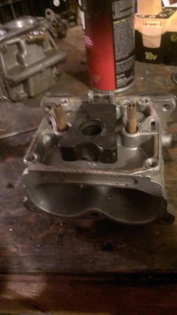

The jets are 34's. Inside the carbs....clean as a whistle. Surprisingly so actually...
Pics as requested....

Ok, now we're getting somewhere. 8) The carbs look pretty good, and those 34 jets are probably stock but you need to check the high and low speed jets (aka orifice plugs) in the carburetor bowl to be sure. Look at part numbers 3 and 23 in the linked schematic. I believe you posted the size for the jets labeled as part No. 7?
http://www.boats.net/parts/search/BRP/JOHNSON/1980/J100TRXCSC/CARBURETOR/parts.html
Couple more things while you're at it. I don't know what you're using for cleaner/solvent, but I use B12 chemtool since it does a great job cleaning and comes with a narrow straw and LOTS of aerosol pressure so it works real well to blow out any gunk from every single port, venturi, jet and feeder tube in the carbs. WEAR GLASSES AND GLOVES!!!!!!!! Try to also send some photos of the electrodes from all 4 spark plugs, and make sure to remember which plug comes from which cylinder (important to not confuse cylinders during diagnostics).

As requested...
#3 is a "28"
#23 is a "54c"
