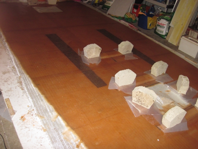

I also was off yesterday and today, so got some work done on my deck.  Used 4 sheets of melamine for the form, and coated it with gel coat.
Yesterday I put down 2 layers of 1708, one layer of 1-1/2 oz mat, and 3/4" nidacore.  I put just about anything I could find on it to weigh it down.
And today I added 2 layers of 1708 to the underside of the deck.  Also added a few stiffeners to the area that has the greatest unsupported span.
With a little luck, I'll be taking it up to Young boats in Inglis on Tuesday to flip it over.  I'm really looking forward to sanding off all that bottom paint :puker: .

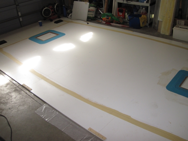

I did make hatch gutter forms, but that is not what you see :roll: .  I made gutter forms for both hatches, screwed them to the melamine, and painted them with gel coat.  The gel coat looked fine on the rest of the form, but I got quite a bit of alligatoring in the gutters (strike 1).  I figured I could probably repair them, so I kept moving along.  I started glassing the gutters with 1208, but I was having trouble getting it to conform to my liking (strike 2).  Each vertical face of the gutters had a 5 degree bevel, but I was still worried about getting the finished deck to pop off gutters (strike 3).  The last thing I wanted to do was ruin the whole deck project because of the hatch gutters, so I pulled them off.
I screwed down some 1/4" wood the size of the hatch.  Then I used bondo to make a 12:1 ramp all around the perimeter of the wood.  I covered it with painters tape (the blue you see) and waxed it.  This should leave a recessed well to drop in a separate hatch gutter later.
Another thing I did, based on Eugene's recommendation, was to put several layers of tape around the perimeter of the deck (the tan tape in the picture).  I built up more layers on the outer edge than the inside, so it is somewhat beveled.  This recess is for when I tab it to the hull, and should reduce the amount of prep necessary to get a smooth transition.

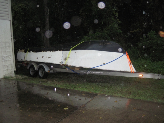

As far as flipping it, they have a bracket that bolts to the transom using a porta bracket bolt pattern, and another jig that uses the bow eye.  They use a forklift to lift it and rotate it like a rotisserie.  They charge by the hour- figuring 1-2 hours at about 85/hour or something like that.  That's worth it to me to avoid the hassle of doing it myself.

Bottoms up!  Had the boat flipped today so that I can work on the bottom.  I hauled it up to Young Boats in Inglis (about a 15 minute ride).  Took them a half hour to flip it and get it secured on the trailer.  Best $50 I ever spent!
