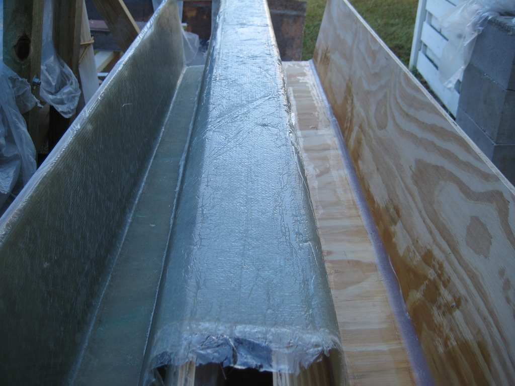

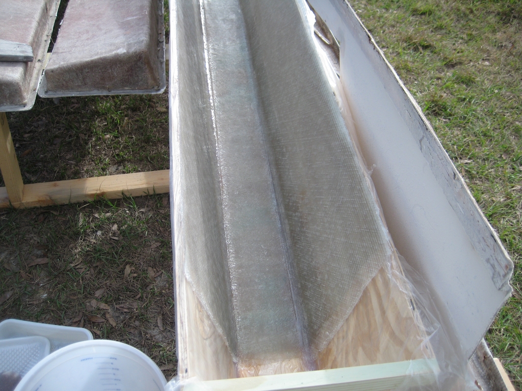

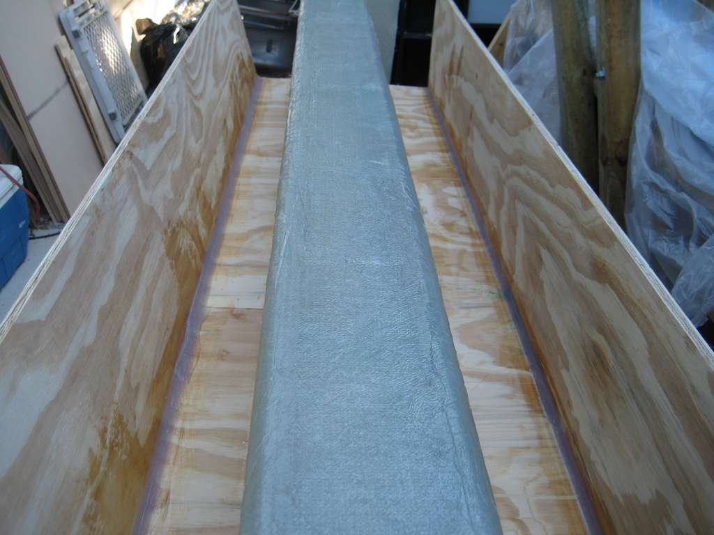

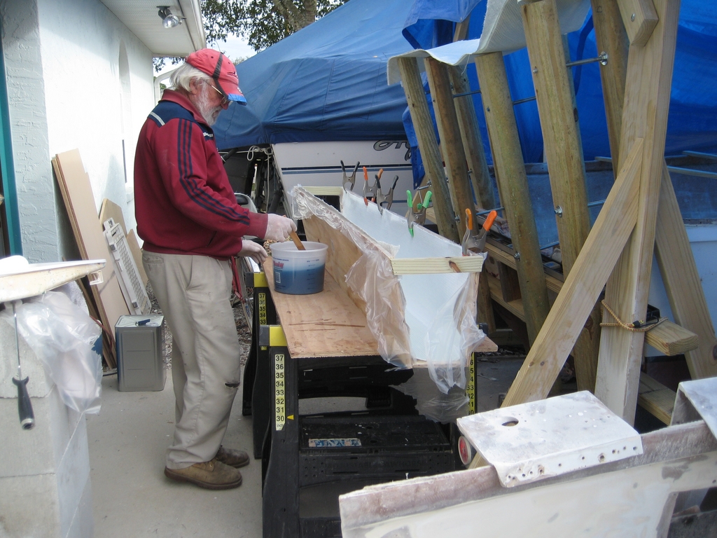

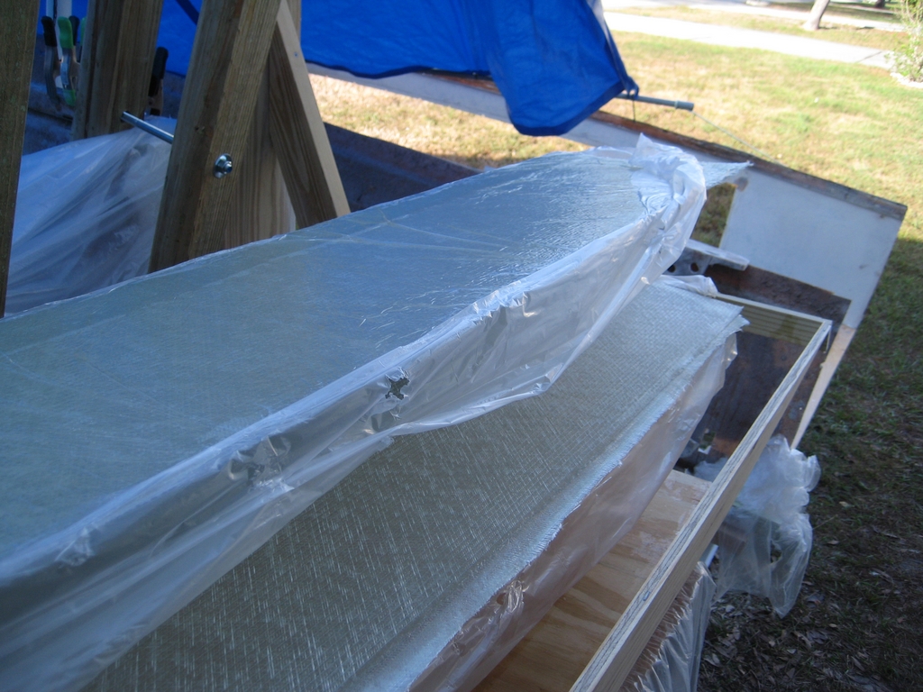

Yesterday I had some time on my hands so I made the forms for the stringers.  You can see some nice round fillets in the corners.  I will cover the forms in 7mil visquene and use that as the release.  Will leave the outer side of the stringer less than perfect but it'll still be structrally sound. There are two types as you can see - the one on the right has two sides at an angle and the one on the left has a 90 degree side and an angle side.  This stringer will be used up against the fuel tank - flat side to tank.

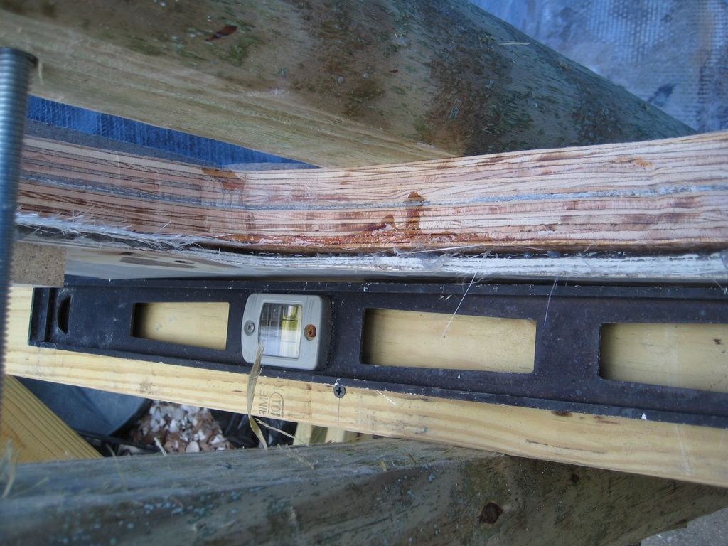

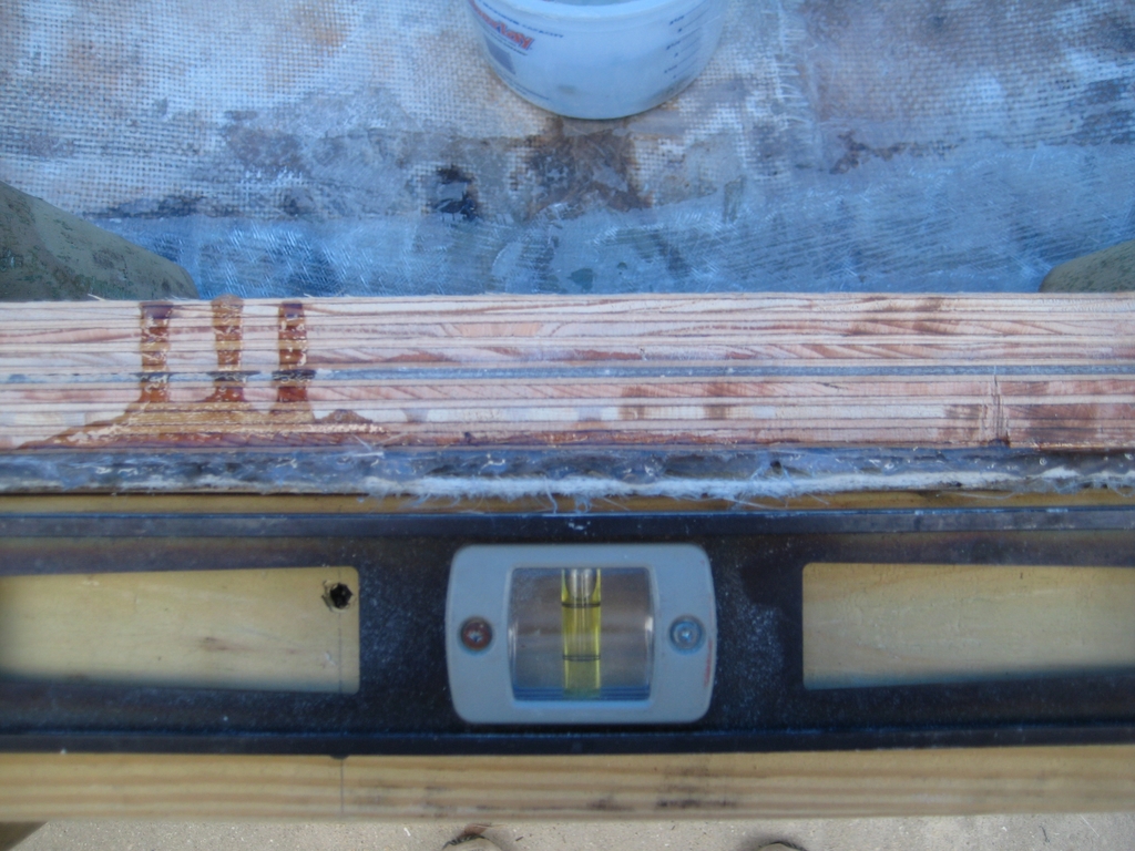

I set the transom core today after dry clamping with a few different tactics to get the inward bow out.  Ended up with a pair of 2x4 PT on edge with 6" spacers between screwed together and it pulled most of the bow out so I went with that.
I made up some resin putty and filleted the 3 corners of the transom area and then used a 1/4" notch trowel (thanks for the tip Lilrichard) and trowelled putty across the inside transom.  I also soaked the inside wood core and edges and layed a 1.5oz mat soaked and then we installed the core and clamped the heck out of it. Saw good ooze out of the places I checked so I will leave it clamped for a day or so - hoping that the little bit of remaining bow will remain and not get worse.

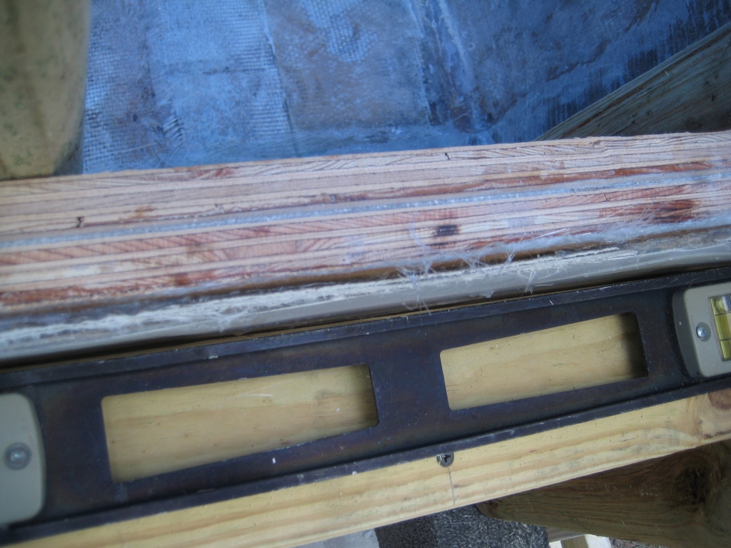

In this pic you can see that I have about 3/8" at the lower notchout of the transom after the clamping.  It is the same spacing about all the way across the transom with the exception on the very corners of the transom. So I think we're good.
You can see the gap difference at the corner.  BTW, it looks like there is a gap between the core and the skin but if you look close you'll see thick resin oozing up in there. I think it'll be a solid connection.
After the transom we started on making stringers.

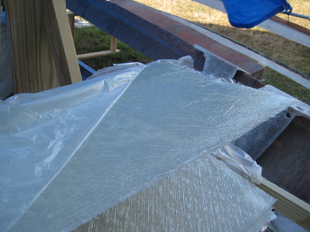

We first made one of the double angled ones - started off with a complete layer of 1708, then 8" 1708 scrap (from the cutoff) in the top, then a 12" 1708 on each side joined into the corners and finally 2 layers of 8oz mat in the top.
Then we made one of the fuel tank stringers

Merry Christmas everyone - had a few minutes free before the festivites start here so I went out to see how the stringers ended up.
Quote from: "CLM65"
Awesome, Rick!  I've often wondered how you guys went about building new foam stringers from scratch.  Now I know...looking good!
Not sure how everyone else does it but this worked for me.  There are a lot of resources out there to learn from like Classic Mako and Bateau2.com to name a couple.

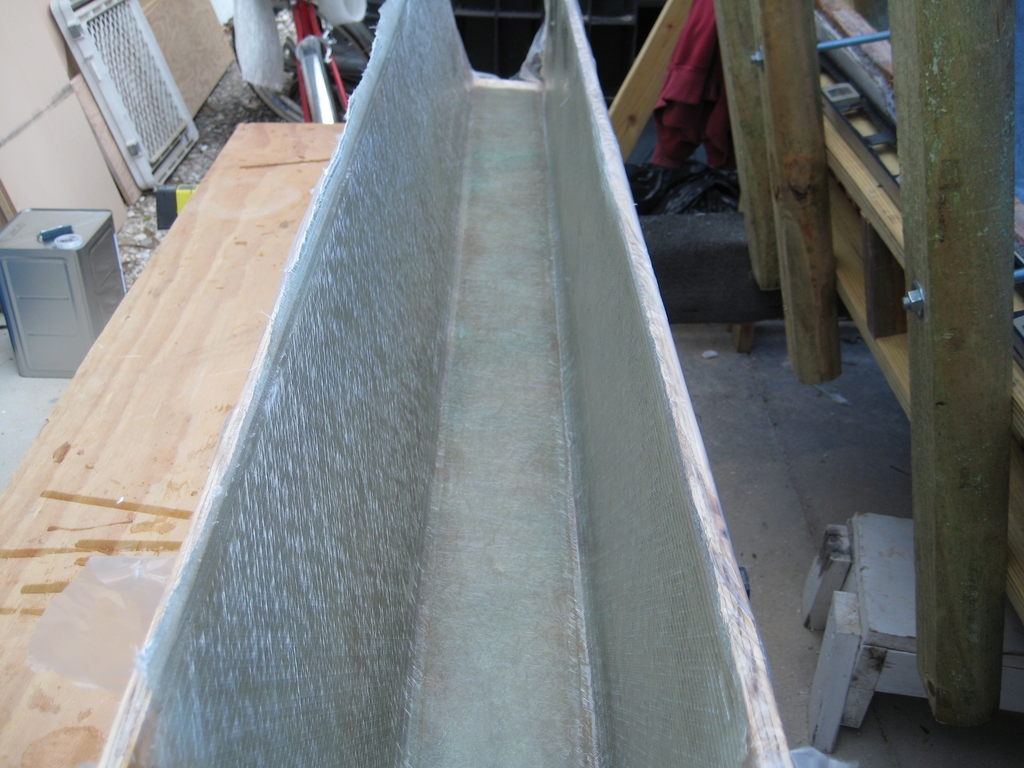

I will have to lay at least 2 more layers of 1708 to build up the sidewall thickness. Will do that in the boat.

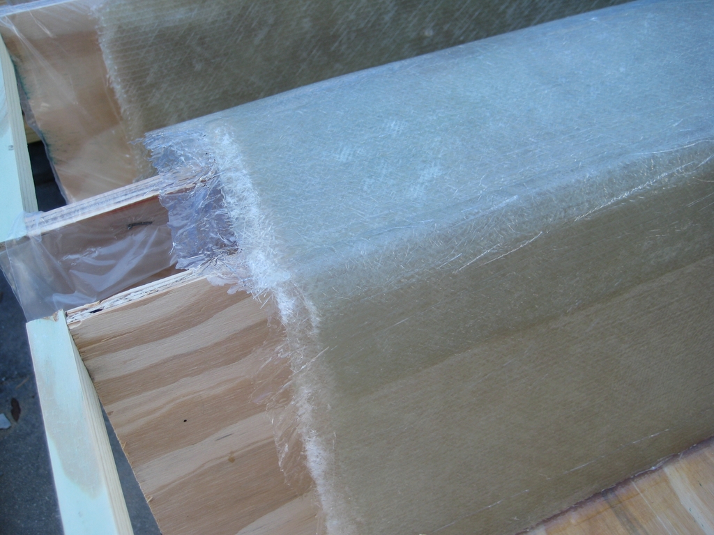

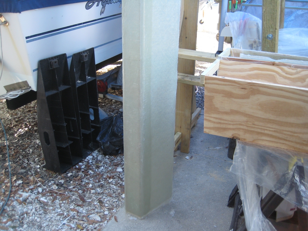

I popped the stringers out of the forms - VERY easy when you use visquene.  Unfasten the visquene, loosen up the stringer in the form (even the 90 degree stringer was easy to do this - hint - BIG round fillets in corners) and then lift the whole stringer out.
Peel the visquene off the stringer
This is the stringer with the 90 degree and angled side - hard to see the angles.  Came out nice though.
Here is the double angled stringer - the thin stuff on the end that looks like visquene is actually resin.

Rick that looks GREAT!  When you put the stringer in the boat will you trim the sides to the shape of the hull or do you have another plan?  What are you going to do to keep the heights even?  Really nice progress, I hope you see it,( the whole forest/tree thing)..

Thanks all.
Hi Dave,
The technical stuff starts soon - like connecting the stringers, keeping them all even.  I did measure down from the cap to each stringer top before I took the old out so that is a starting point.  I would like to raise the floor level an inch anyway to help figure out the self-bailing.
I think I will build the tank box first and keep that all the same flatness by building it upside down outside the boat.  Then figure out the fore and aft from there. At this point in time the stringers walls are maybe 1/16" thick so mitering them should be easy.
I hope to get all the pieces of the puzzle done and then start assembling them.
