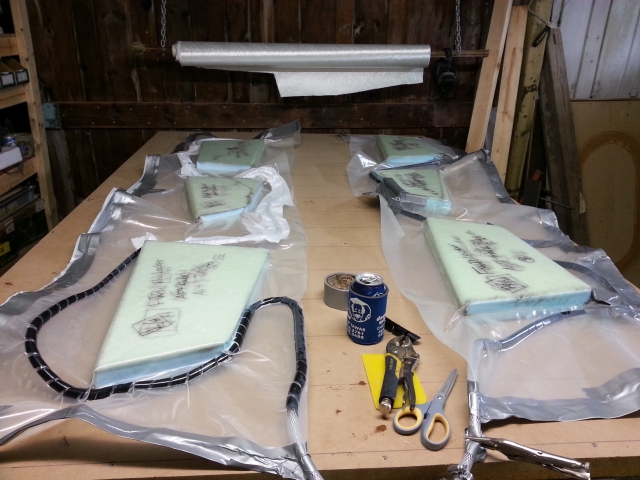

Well, after a few days of going back and forth on how I wanted to approach doing my bulkheads, I settled on vacuum bagging the skins onto the foam. The foam btw, is a 3lbs density foam (from work :shhh:)... I am not sure of the actual brand, but the composites guys told me it is a high quality product, so I'm in.
Anyway, I did 3 layers of 1708 for the skin, this will reinforced with four layers of 1708 tape once I place them into the boat. This should compensate for the lower density of the foam and give me a transverse lamination (between the longitudinal stringers/hull and the bulkheads) of roughly 7/16", plenty to transfer the forces across the foam.
I started bagging last night and left them under pressure until this morning. I haven't removed them from the bag yet, but I will after work and get some pics of the finished pieces posted.
The point where I remembered to take pictures... I decided on two separate bags because of the ease of handling. On the right I have the R/H bulkheads already under pressure, on the left are the L/H bulkheads ready to be wet out.
Both bags going... Note the vise grips clamping off the left bag.
I could only pull 26ish inHg, which may have been a full pull for the day???
Picked up a full roll of spiral wrap on ebay for a good price, this stuff makes great manifold material.
I get some pics up after work tonight.
Have a good day everyone! :49:

June 10, 2015, 10:25:02 AM
Reply #307
Re: 1966 22-2 Diver Rebuild
« Reply #307 on: June 10, 2015, 10:25:02 AM »
Awesome!

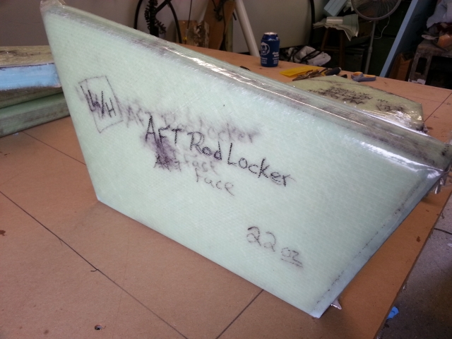

I got them out of the bag, and I have to say, for not using peel ply and bleeder cloth I think they came out pretty good.
I still need to clean up the excess resin that was pulled from the glass, but you should get the idea.
cae out pretty flat and fair
Like I said in my previous post, the core is a 3lbs density foam. The reason there is a piece of 2x4 on it is because I want to do a quick (and very unscientific) test of the compressive strength with the 3 layers of 1708 (epoxy resin) on it. Well, I am 220lbs and I could stand and bounce on that piece of 2x4 (on end, as it sits in the pic) and it felt as solid as the concrete floor underneath it. Yes, I am very happy about that.

June 10, 2015, 07:12:51 PM
Reply #309
  • Posts: 11327
« Reply #309 on: June 10, 2015, 07:12:51 PM »
Sweet  :whistle:
Nicely done Carl :great02:
June 11, 2015, 09:32:32 AM
Reply #310
  • Posts: 6449
« Reply #310 on: June 11, 2015, 09:32:32 AM »
This is a good illustration of the "sandwich" composition I was referring to in Que Pasa's rebuild thread.  You can see how with little increase in actual structural strength you can still equate to a huge increase in functional ability. The fact that you "point loaded" your component is even more telling in how much you gained in both aspects.
Great stuff. :great02:

I just wet out and got the last of the bulkheads under vacuum. I got a perfect seal right away! :weehee: :woohoo:
I'll let these guys sit overnight and planning on installing them tomorrow.
Sorry for the blurry picture...
