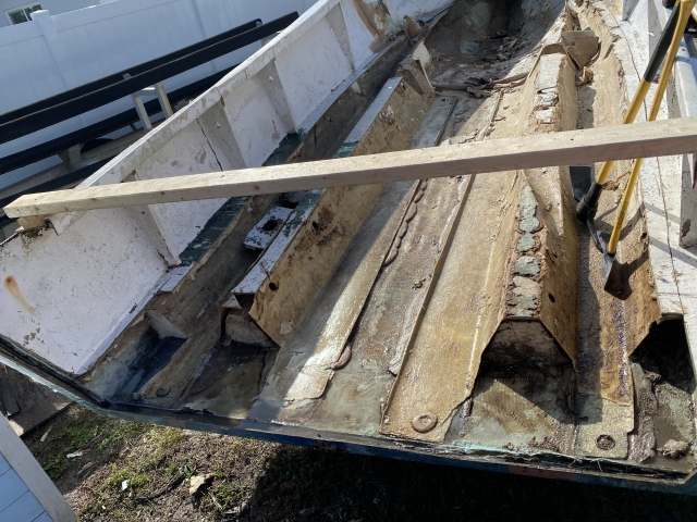

You'll  need the aft 18” or so out of the way when you rebuild your transom, so it only makes sense to do the transom first.  Then that will give you one last chance to check the hull for square and true before you immortalize it by rebuilding the stringers.
Thanks - should I take the outer skin or leave it?
I see a lot of holes in the transom but the real question is how is the glass itself?  Where they added the wood at the top, is the glass on the outside smooth or can you tell where the patch is? Remove the wood from the transom and then take a good look at the glass. Then you can decide if it is salvageable.
The best way to get the wood out of the transom is to use a skill saw and cut down almost to the fiberglass from the inside and make a bunch of cuts across the transom, maybe 2" apart.  Then take an air chisel and start peeling off the wood. If you can find a long chisel, that makes it even easier.
Then it's time to lock the shape of the hull in and make sure it is level and square.  You can remove about 8 feet of screws where the cap meets the hull sides and you can cut the cap free at the transom and prop the cap up above the hull - lay a 2x4 under the cap across the hull and figure out a way to lock the shape of the hull in. The 2x4 will help prop the cap up and hold the shape of the hull. You can screw small blocks of wood into the very top of the hullsides and attach the 2x4 going across the hull to the blocks. You will need at least 18" of clear working space forward of the transom to work in when rebuilding the transom.
Now, about those stringers... What is the width between the 2 main stringers you have left? Looks pretty far apart and your deck will sag in between them so you'll need a lot of bulkheads to support the deck. If you plan to pull all the stringers out, then you have a clean slate and can re-enforce the entire hull with an extra layer of 1708 glass or 2.  Then your stringers can be whatever you want.  I made new trapezoid stringers from scratch using 1708 and glassed them in the hull. Some people use Coosa in a framework that covers the entire hull and they design the storage they need into it. Don't use wood for the stringers (although we have people do that). Search through the Flatback rebuild forum and look for Capt.Matt's rebuild (https://classicaquasport.com/smf/index.php?topic=5724.0) - he used a lot of coosa and the boat was rock solid when he was done. Working with Coosa is like working with wood but it won't absorb water.  Look for boats rebuilt by dirtwheelsFL - he's done a few and uses different approaches.

Here's how much stuff has been removed from the project so far

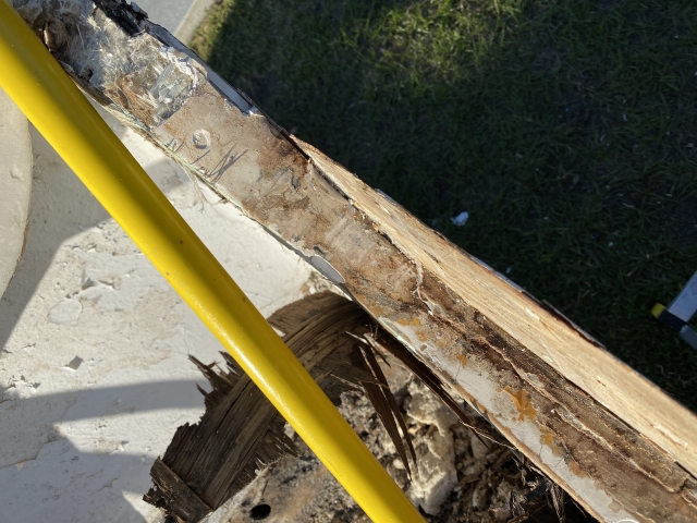

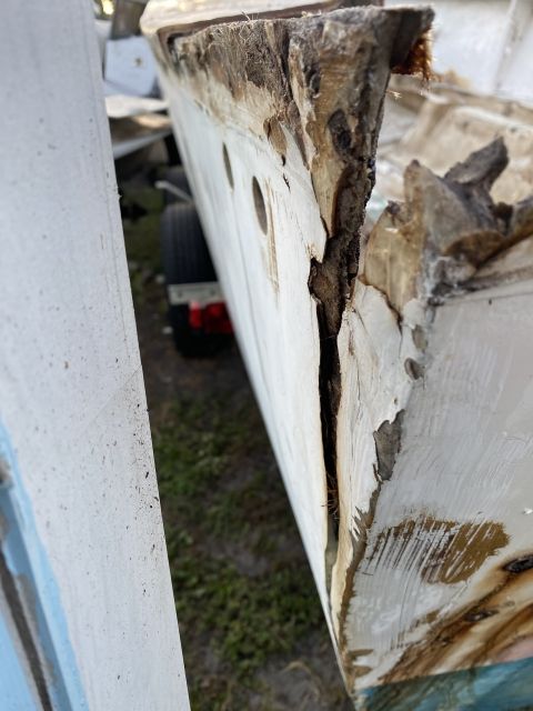

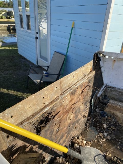

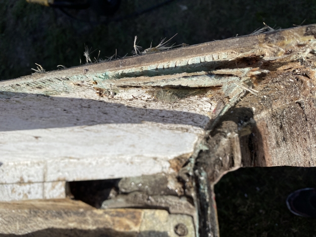

So - my son and I decided to do a little more work after the clean up, and started removing the transom wood. The cap that was put on to raise the transom popped of with a pry bar in one piece. We then realized that it was not put in properly and started to look at the outer skin more closely. The outer skin was done poorly, and there was a split down the portside where the skin meets the hull side. There was also an infestation of large ants - these suckers were mean!!! IF anyone knows what they are, let us know, my son is really curious to know (see pic)
Once we realized how bad the outer skin was, and seeing how the prep work was done so poorly on the repairs, we decided to just cut out the transom leaving a 3" tab all the way around - this will be less work in the long run and a better finished product. So tomorrow we will finish getting the rest of the wood out, and start grinding back the stringers to layup the new outer skin.

Wow, you guys have been busy! Guess you answered your transom skin question.  :nSalute: What's the plan for the new one?

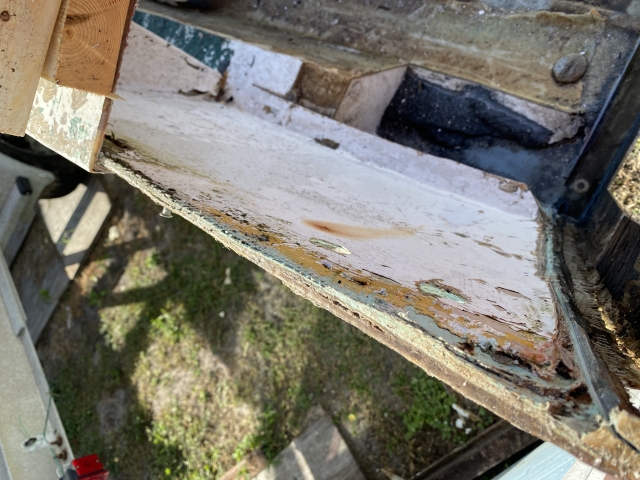

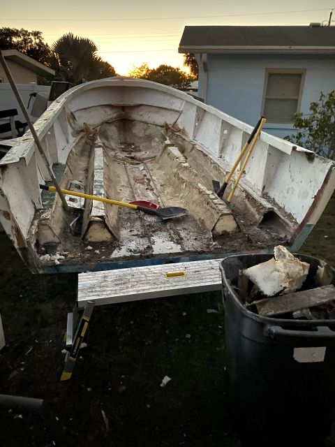

Got the rest of the transom out, and looks like there isn't a liner - I thought there was and started to peel one side - please take a look at the pic and let me know what you think.
Also, what is the best way to deal with the stringer liner? Grind it out, or try to peel it out?
Some pics for your viewing enjoyment
Does this look like theres a liner?

I guess you need to decide if you're going to totally gut the boat or not. This will decide how to deal with the stringer stuff. At this point I think it is as much work ripping out all the stringers as it is to grind down the bottom portions of the stringers.  Yes, those are liners that cover the inside of the hullsides.  You may have to pop the cap loose to be able to remove that portion of liner. You want to be gentle when popping that loose. If you destroy it, you'll have a lot of filling and fairing in your future.

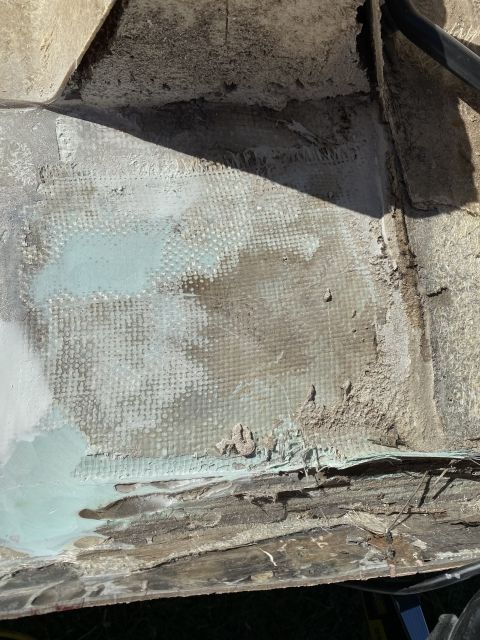

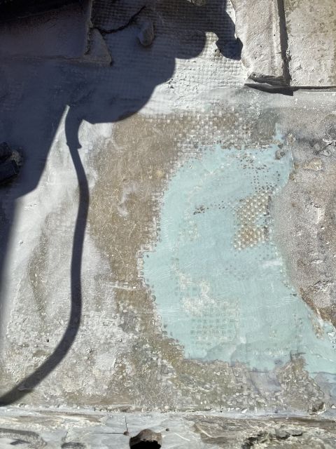

Alright - here's a question for those in the know:
What is all this blue stuff? I'm grinding and its basically everywhere - Also they put a truckload of bonding cement down for the stringers and its a HUGE pain to get off - i'm using 40 grit on 4.5" grinder - I think I need something bigger and more aggressive!!
DO I have to grind all of this blue stuff out (its between 2 layers of glass)
If you look at the pic - from right to left - you'll see gray (the bonding cement) - small patch of roving (inner transom skin) - blue stuff (between layers of glass) and then raw glass on the left side - I'm assuming I have to take it down to bare glass??
This picture you can see the roving and then the blue stuff under it

The blue stuff is bonding putty - maybe they ran out of one brand and had this on hand on Friday??   :huh02:
I would go to Harbor Freight and buy a 7" grinder and pick up a couple 24grit flap sanding wheels too. If you can't find one there, HD has some pretty low # grit on flap sanding wheels. These things are vicious at tearing down anything. If you need to remove some of the "roving" (24oz), this grinding wheel will knock it down, just hang onto the grinder (and wear a tyvek plus mask and goggles). You will not regret buying the flap sanding wheels.  I also have a HF 4" angle grinder and use 4" flap sanding wheel to get into the closer qtr spaces - just fantastic at getting your work done. I got very good at using it for many things (even my wife complaining about the bottom of her pan being funky - DONE with the flap sanding wheel in a couple seconds - the pan bottom, not my wife  ;-) ). Did I mention that the flap sanding wheels are fantastic? :8):

Oh, and you just need to grind down to clean glass - don't overthink it - post pics and we can advise. You can glass over 24 grit results in some applications but you might need to be more gentle in some areas with a 80 grit wheel. The wheels last a long time. They don't like uncured resin though (don't ask how I know this) and they are ruined after that.
