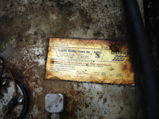

Your tank measurements equates to a 42 gallon tank. Maybe the PO changed it out some time ago. Can you make out the tank manufacturer spec sticker on the top of the tank?
Florida Marine (FMT) supplied Hialeah hulls with tanks. My 84 CCP as well as my 91 WAC (Bradenton plant) were both originally equipped with FMT tanks.
