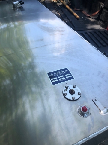

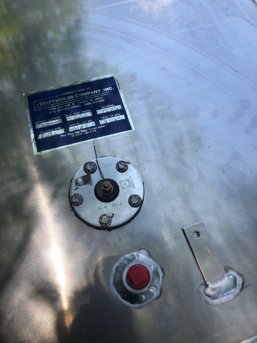

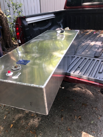

Picked up my tank today. Will be getting my bulkheads installed this weekend as well as the tank. Hopefully if all goes to plan, will be able to have the deck glued down next week. Now to double check my numbers and pick a good spot to place the tank.
Mattson & Co. did a great job on the tank and fast turnaround.

Did you tell us the method you're going to use to install the tank?  Make sure you get a closeup pic of the tag for later.
May 22, 2020, 04:01:18 PM
Reply #49
Hooked-On-Shenanigans
  • Posts: 41
Re: 87 222 Rebuild
« Reply #49 on: May 22, 2020, 04:01:18 PM »
Rick, was instructed by Mr. Mattson to make cow patties of 5200 on the tank coffin, then to smush the tank into those as even as possible. I was given 4 L brackets as well to be screwed to the bulkheads when i know exactly where to place it then 5200 the other end to the tank. The idea being that 5200 will rip thru the bulkhead before the tank. The effort to get that stuff off your hands ,it Sounds good to me, I'm going with it.

That's a good looking tank. What size is it? Do you mind sharing what they go for? Do people coat them these days? When i just pulled mine it looks like they put a tar coat on it and looks to be protected.

Ulysses, my tank was around $650. Not too bad and they out out some quality work there.

The tank plate says approx 50 gallons but doing the math 60”x9”x”22” /231 come out to 51.5 gallon.
